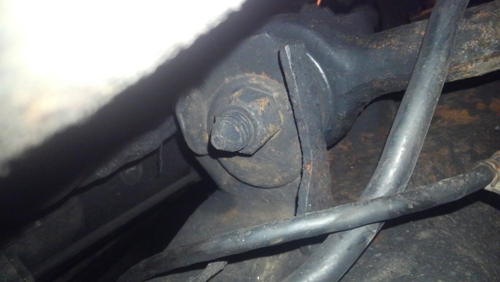

@Stoney have you checked your local Napa or autozone to see if they have it in stock? I would suggest removing your suspected bad control arm and take it up to that store and then set them side by side to verify shape and length. if all matches up, save the $$ and rebuild it with a good ball joint and poly bushings. unless the bar on the arm is bent, it will never go bad. only the ball joint and bushing go bad.
using the polyurethane bushings call for re-using the outer steel sleeve in the old bushing so you just need to burn or melt the rubber out saving the outer sleeve and sometimes the inner sleeve too. the ball joint just bolts to install, so no press needed there.
Now the lower arm can get deformed rather easily being made from stamped steel. if going with the poly bushings, you can always have the outer sleeves tack welded in if it's loose fit. the lowers have the tendancy of the press fit ball joint to get loose causing the need to be replaced. I really wish they made forged steel lowers for the 2 wheel drive variety trucks.
