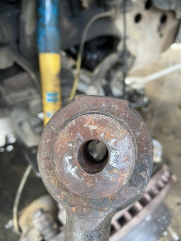

Been awhile since I've pulled upper control arms. Can I do this without having to undo the lower control arm ball join and removing the CV axle? Just trying to minimize what I've got to remove.
I just did them on my K1500 which are similar. The only thing I wished I had done on the first one was to mark on the mounting towers the angle of the flat portion of the bolt rather than just looking at the washer position. If the arms are made the same it would get you close to where it was before the bushings went. On the 1500 you need to remove the upper shock bolt to get the mounting bolts out. Maybe not on the 2500.
I want to do this, but how do you see the flat portion of the bolt? I was going to scribe a line from the washer to the frame. Of course I'm using new bolts and washers as the bolts seem to be what is worn.
On the nut side of the bolt, the flat should be visible. I scribed a line at that same angle.

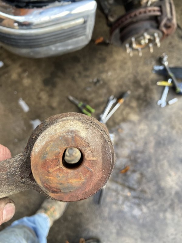

It took me less than 2 hours to do mine, even with the Western New York Rust to contend with. My bushings didn't look too bad but my upper ball joints were toast.
I don't have a press to install the bushings, so I have to take them to someone who does.
