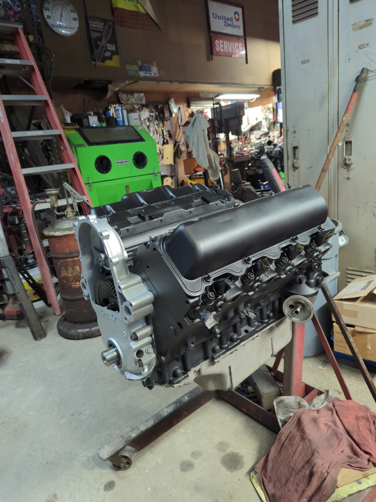

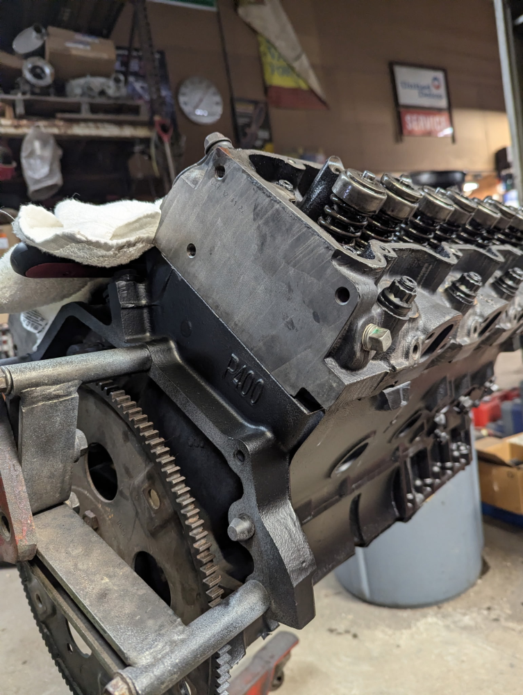

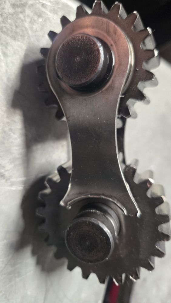

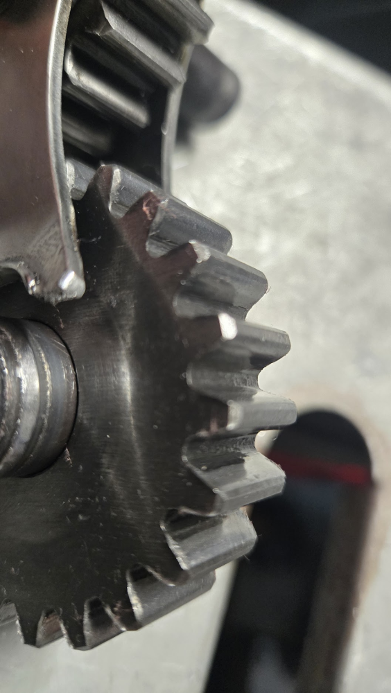

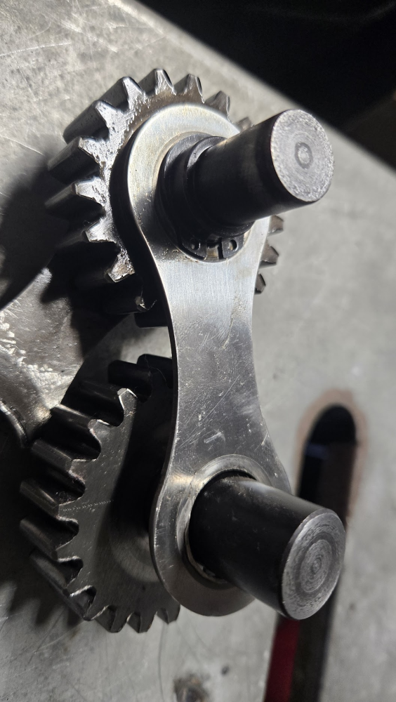

Its interesting because literally every single H1 shop/tech I talk to (ModMafia, Rubberduck, Tor and others including the shop that is currently rebuilding the engine) have indicated to me that the gears are not something that they recommend doing as its not necessary. Searching back through the HummerNetworkForum.com (which I run) for "timing" results in little to no results. The maintenance manual from AM General doesn't even mention timing when it comes to scheduled maintenance. I just got off the phone with my guy who had actually just called Tor, who implored him to not install the ARP headstuds because 1) They all leak and 2) He's never seen a problem with the factory headbolts. Now I don't know what to do. For those of you who aren't aware, Tor is one of three remaining AM General factory certified techs in the country still working on these trucks. His reputation amongst our community is absolutely unimpeachable. So I'm getting stuck between two camps of people here. The group that seems to be H1-centric that says "don't do it, not worth it, it'll fail" - the guy doing the rebuild is one of these guys. "I've been building 6.2's and 6.5's for 17 years now and never had a problem with the factory head bolts." Then there are people like Will and Chris who are telling me to do everything from gapless rings, head studs and flash cleaning. In the end I'm probably making all of the wrong decisions all over again and I'll just be back here again in 6 months wondering why I even f*cking bother.Sad to see one return to one component of the "disposable GM diesel engine design" the aftermarket has solved.

So I had it towed down to my aforementioned mechanic and we had the radiator rebuilt with dimpled cores. Since the fan had lost about 5 of the 9 blades, we decided that it was prudent to replace the waterpump as well. For those wondering if the cover is removed during the waterpump install, per the H1 Shop manual, it is. And this is where the timing gear problem happened I believe.
Timing adjustment is not listed on any of the scheduled maintenance groups throughout the factory manual:
