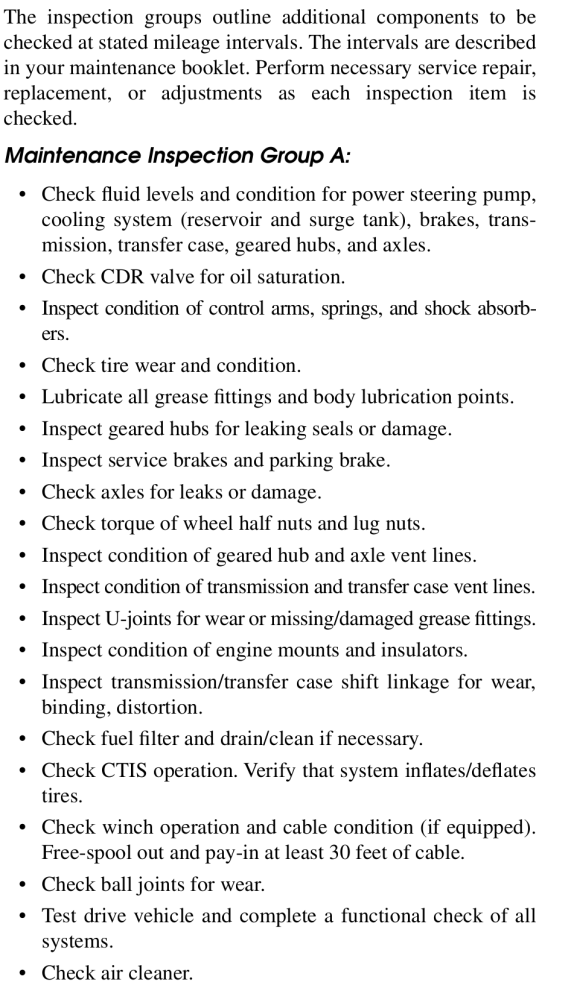

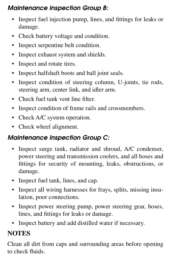

Timing adjustment is not listed on any of the scheduled maintenance groups throughout the factory manual:

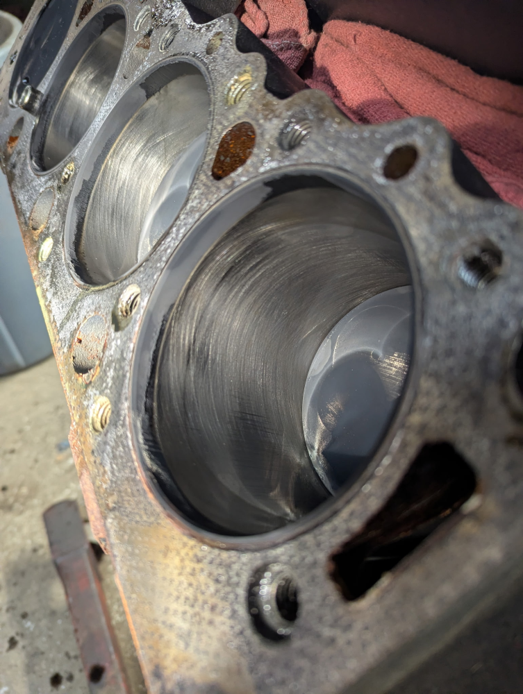

My guy sent a picture of the bores which he said "look practically brand new".

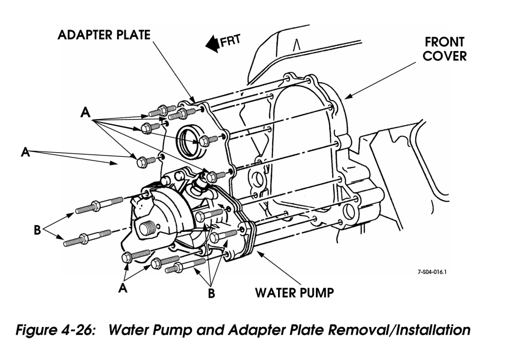

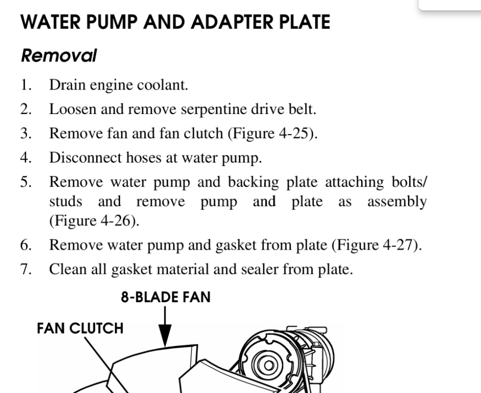

The water pump backing plate/adapter cover IS removed because the water pump has 5 bolts on the back that connect the pump to the backing/adapter place., NOT the timing cover or front cover in your pic..... the gears can't be removed or seen very well without removing the timing cover....

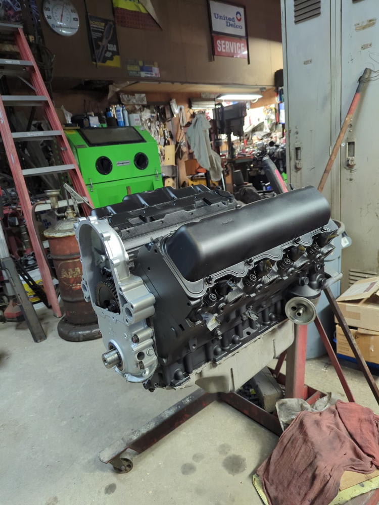

Just to update on the build - the bearings were fine. Some minor wear but nothing that is out of the ordinary from a healthy engine.
Lifters arrive today. Head studs are being installed. Bottom end is all buttoned up (Thank you @Twisted Steel Performance for the torque specs!!!).
Need to order the new IP. Timing chain and gears have been procured. Engine should be going back in the truck early next week I hope.

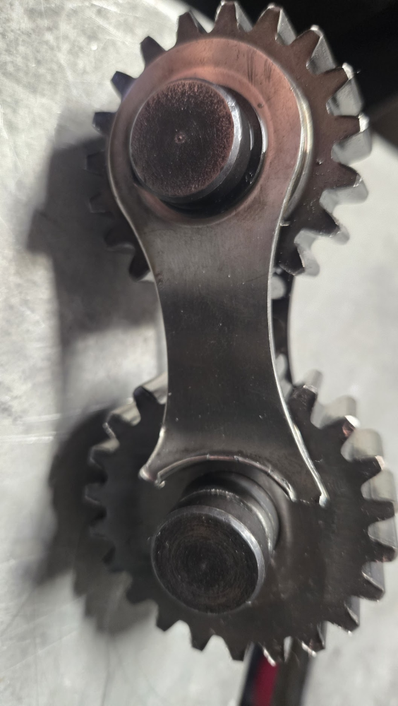

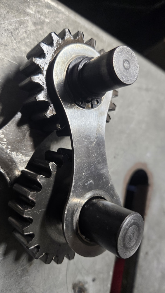

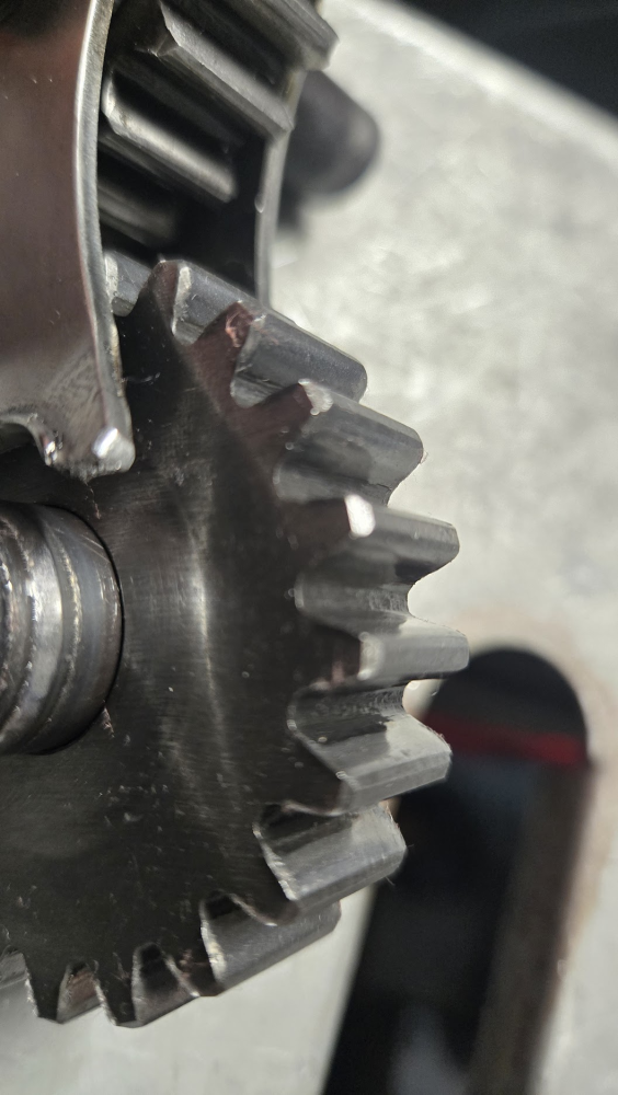

I had the Internet howl at me (not this community, but others (plural)) not to use the timing gears as they whine at high RPMs (IIRC, 5K and above). These doomsday inputs were from "experts" that raced V8 gassers. When I pressed these "experts" on how to get my 6.5 above 4K RPM without turning it into a grenade, they still howled that the gears would whine. Installed the gears anyway. In fairness, a mechanic did discover that the gears were noisy, but the only way to hear them was to remove the oil filler cover with the engine running. With the oil filler cover securely in place, the engine itself was the loudest thing in the room and could not hear the gears at all.

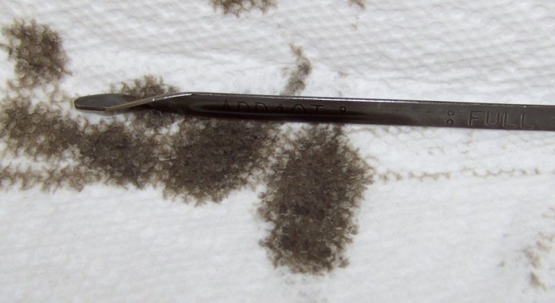

3000 miles may be too much on the engine oil. My 1993 called for 2500 mile oil changes under all but "driven by Grandpa to Church on Sunday" conditions. Towing the grades around here, HD use, my UOA's showed 3000 miles was too many miles on the oil. Changing the oil twice a week was buying it by the 5 gal bucket... Esp. since the 6.2/6.5's I had all burned a quart every 500 miles working this hard. No the continuous oil change didn't help the UOA numbers.
My signature has a link to my experience with Gapless rings. I pushed oil changes to nearly 5000 miles and had more to go. This is a dirty soot belching high compression engine. Less blowby with gapless rings keeps the soot out of the engine oil. Like you can read the marks through the oil at 2000 miles on it clean. Less, like near ZERO, blowby as the engine wears is also an advantage of gapless rings. Pic below is 2000 miles on a 6.2/6.5TD hybrid (6.2 block with the ATT turbo) with the wick turned all the way up and you can see the marks still because of the gapless rings I used. Kept my hands somewhat cleaner when wrenching on it as well. Not to brag, but I got 38,000 miles out of the engine before a IP with a bad governor showed me north of 4000 RPM on a Emissions Snap Test.

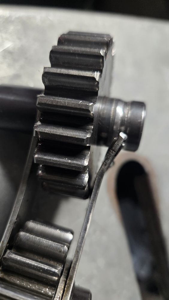

What are they running for race engines? Your phone call may save them an engine if they are using a gear drive and somehow overlooking the likely failure of the clearance step. Better to hear it from you than trip over it in a forum. It's not like you are asking them to cover the engine or anything. IMO this is the "I am my own warranty station" when doing thing different even though it's better than 1980's design. Unless the builder and you agreed on a warranty with aftermarket parts and changes to the engine... and even then you don't have to make a warranty claim. They may learn from their possible mistake(s) and never touch a gear drive again or change the way they install them. They may want to look at it and see what went wrong for their own learning.
