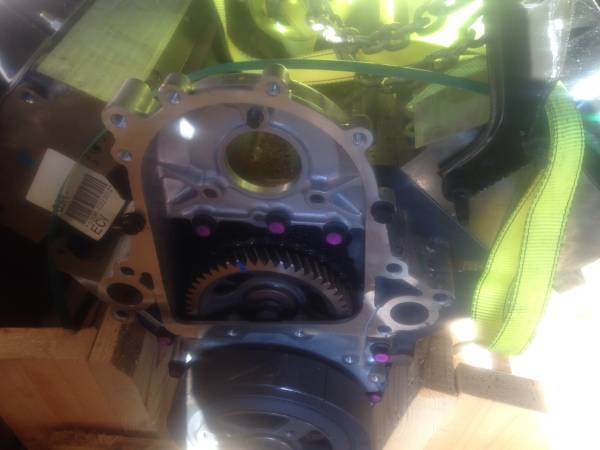

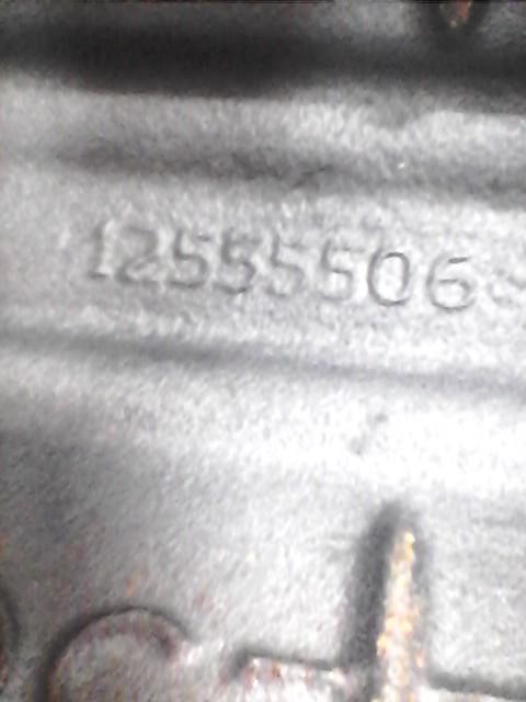

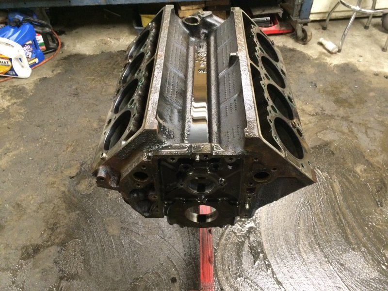

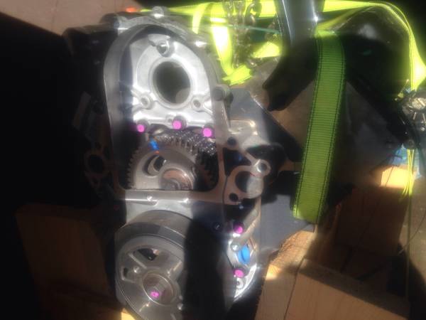

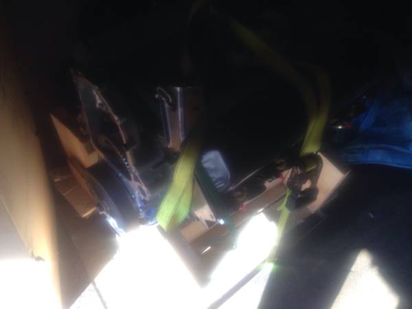

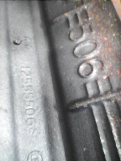

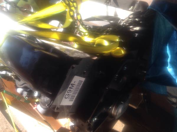

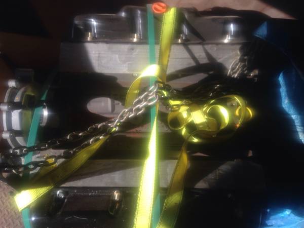

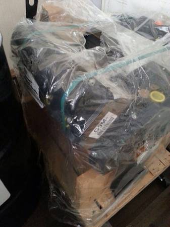

Ok, I got a couple more pics of the engine I found and I'm pretty sure it's not an Optimizer.....and it's not a P400....but what the heck is it? In the attached pics, the first 2 are ones that he sent me of the valley of the engine. I don't see a Navistar diamond in the valley, but from the pics it's obviously new. I've seen another one like this on that auction site, so I'm just wondering what the heck these are. In fact, here's one that Ted's is selling as new from AMG. http://www.ebay.com/itm/6-5-Diesel-...Parts_Accessories&hash=item54149991a7&vxp=mtr
So now I'm wondering, is it an Optimizer?? Thanks in advance for any info.

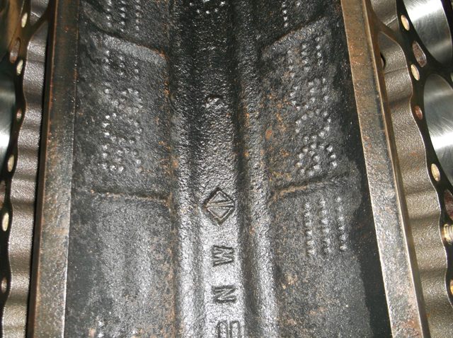

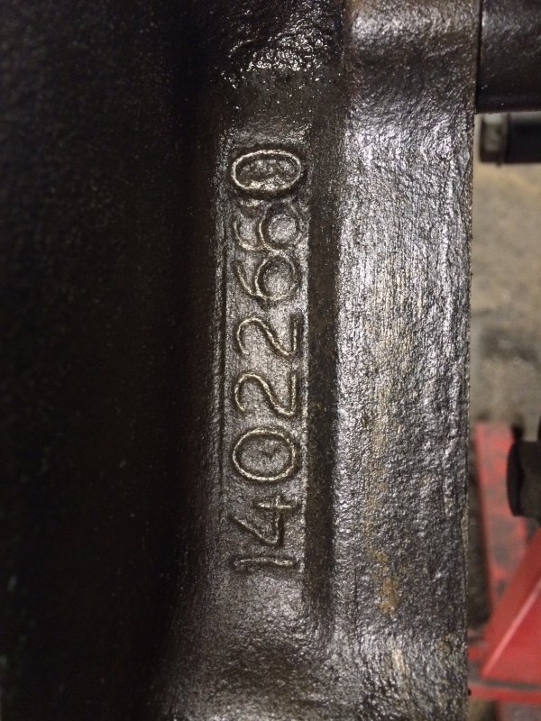

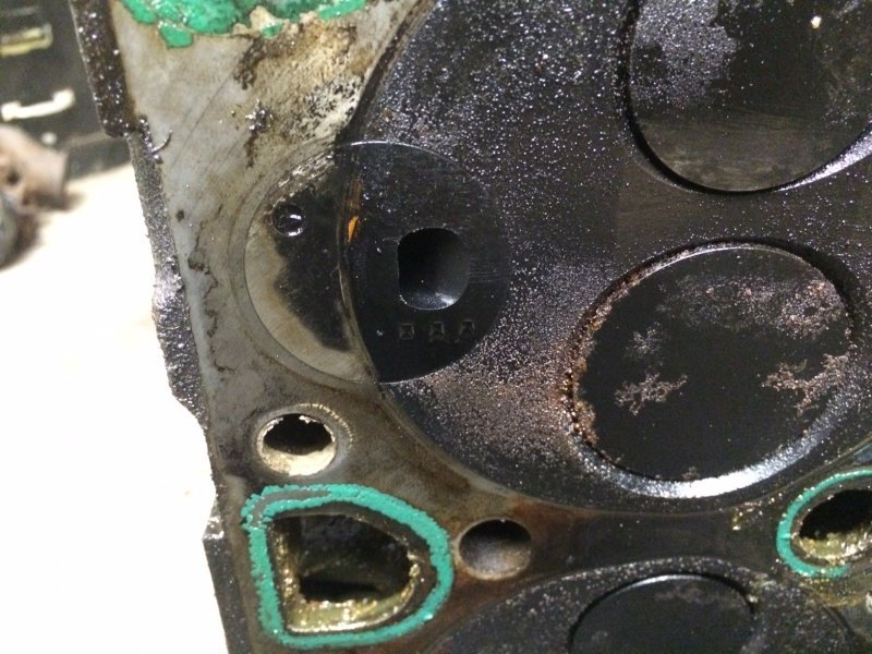

Photo's are all but useless as they got slaughtered on the upload somehow. Center valley photo with entire valley shown. Back of heads on block for casting numbers.
This could be a China knock off block.

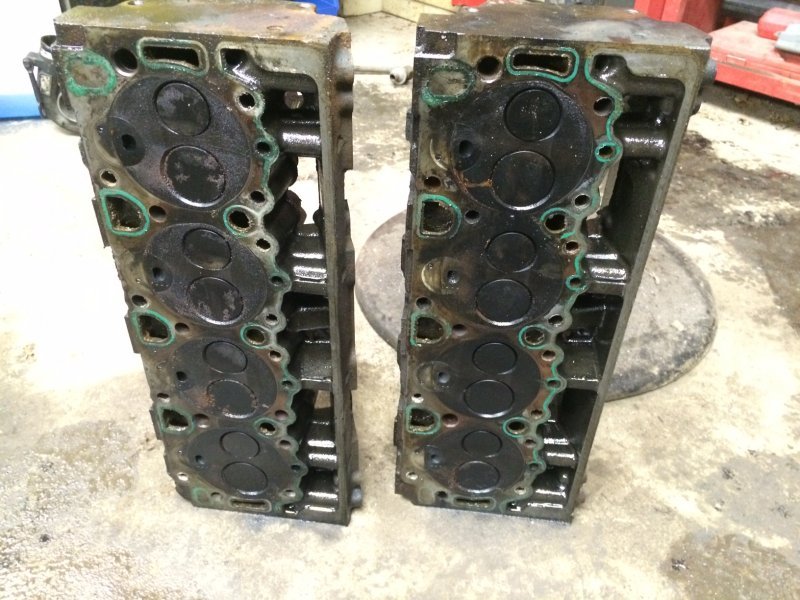

From the video in the other thread your cracked heads are likely the problem being cracked through to coolant. You could probably get away with just replacing them. The video is classic coolant from the cloud dissipating - oil doesn't. On the other hand there is no kill like overkill and and new engine will solve the problem. Hard to tell if you also cracked a cylinder that is causing the white smoke. You could pull the crossover off and water pump belt and look for bubbles in the coolant crossover. The side that bubbles has the problem.
Yeah, not the best pics, and I had trouble getting more pics from the guy, but from what he has given me so far it is the same as the engine that is for sale in that link - and that one has good pictures of everything. No Navistar diamond, but clearly new and Ted's says it's from GEP...I'm just not sure what to think. My gut is that it's probably ok, but who knows for sure, so I'd be better off getting something that has a diamond on it.
That video is a bit misleading. The thing I was trying to show was that it doesn't smoke at start up, but does after it starts to warm. I've had it running in the garage for a while and it's definitely an oil smoke haze that lingers and it smells of burning oil as well. I wouldn't be surprised if there's some coolant mixed in there as well, but it's predominantly oil smoke that I am seeing. I like your idea of looking for bubbles, and I will keep that in the back of my mind for any future troubleshooting. For this engine, I've already written it off in my mind and it's the overkill approach that I'm going to take to fix my problems.
My read of the photo spread is that the seller knows what you want and is angling to make you think you are seeing what you want. Simply put, if the seller wants you to buy this engine, you must get the photo shots you expect; otherwise, wish him good luck in selling it.
Yeah, I was careful to tell him where to show me, but not what to show me so he didn't just find pics on the interwebs to show me. He tried to tell me that 506 identified that the engine was made in 2014. I politely disagreed with him.
Gut tells me Chinese or maybe a GM unit?

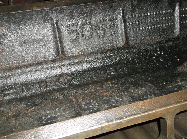

Heres a pic of my AMG 506 notice the "dot matrix" look not solid line and numberes.

Oh I forgot to post that I found the reason for the miss.....the head gasket was blown between cylinders 5 and 7. It was blown bigtime. So I'll need to check the flatness of the deck and head.
