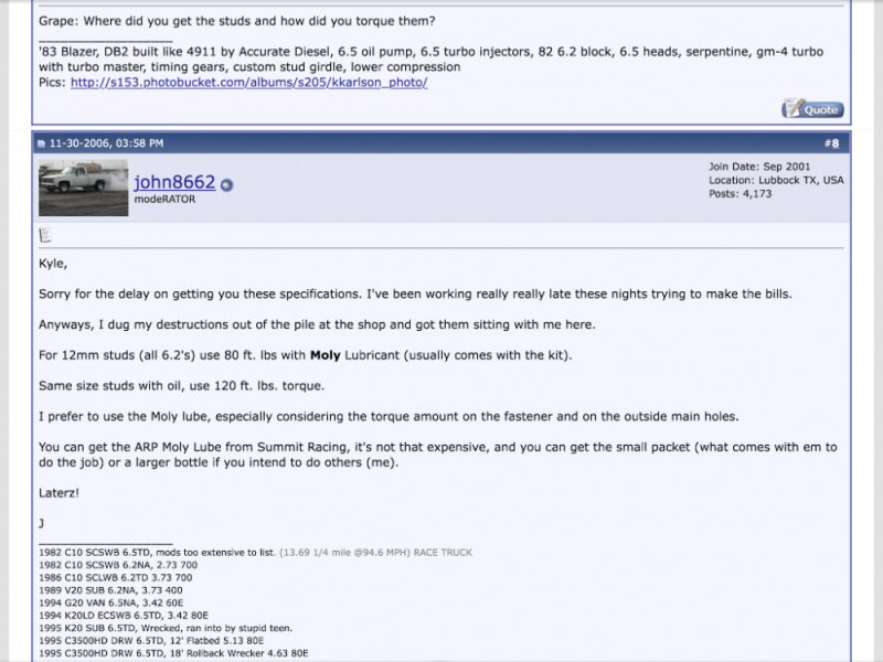

AKDriver has the opening part right.
You HAVE TO align hone the main caps when adding a girdle. The altered tortion change WILL WARP the main cap tension.
For the engine that keeps braking crankshafts: you need to have the rotating mass balanced after align honing. New balancer, crank, rods,pistons, flywheel.
The torque on studs vs bolts are way less because you rotational force on a bolt is drag of the large threaded area. On a stud it is a small cross section of threads of the nut. Also the lateral force is applied much more evenly with a stud.
It sounds like you are trying to "at home engineer" this. Doing that with a problem block/engine is not advisable. Imagine your assembly turns out perfect, with a perfect fit on bearings, cap to girdle, all torques, etc.
If whatever is the crankshaft breaking problem is not resolved- what do you blame if this one breaks? Too many variables.
