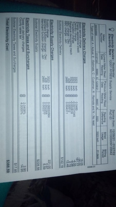

Okay this may sound like a dumb question maybe not.... And I'm going to post a picture after this so youll understand why I'm asking.... It's been getting down around zero at night time here but usually not anything lower than that... Usually I plug the truck in when I get home in the evening and it's plugged in until the next day when I decide to go somewhere... Not blaming this all on keeping the truck warm but I just got a electric bill for $388... We heat would nat gas but we do have an electric hot water tank... I know the truck heater isn't the whole problem but how long do I actually have to have it plugged in before I start it... As in can I leave it unplugged and just plug it in an hour or so before I need it?
Our biggest change in our electric bill is in the winter, some from the pumps for the in floor heat some from plugging in the vehicles. Don't usually plug in anything until it gets closer to zero. With my dual block heaters it usually only takes an hour unless it's really cold. I have used timers before.....

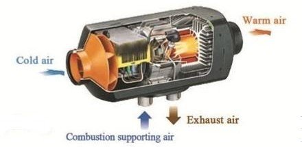

10 kW of energy can be obtained from one liter of diese, from one gallon 37kw. Knowing the price of a diesel, you can calculate how much one kilowatt from diesel. If you only need heat, have several ways. For example, use a Webasto heater or a similar, liquid or air heater. My garage is heated with a Chinese air heater. at maximum power, it consumes 250 grams diesel per hour. at a minimum of 100 grams per hour. it is about twice cheaper than heating with electricity. such a heater costs $ 100, about the same as an electric heater.
To heat the engine, there are also heaters built into the cooling system. They heat up very quickly. the power of 5 kilowatts is 10 times more than the heater built into the unit.
I have been looking into these chinese diesel air heaters for the house to heat rooms, also looking at one as a coolant circulation block heater to have on a remote temp sensing thingy. having one on the truck would allot me to have a block heater while it's parked at work or somewhere there is no access to electricity.

I have seen some youtube videos on these, it seems that the 8kw and 5kw are one in the same unit, but only the settings in the controller. they also show one that has two other ports by the exhaust that are for water.

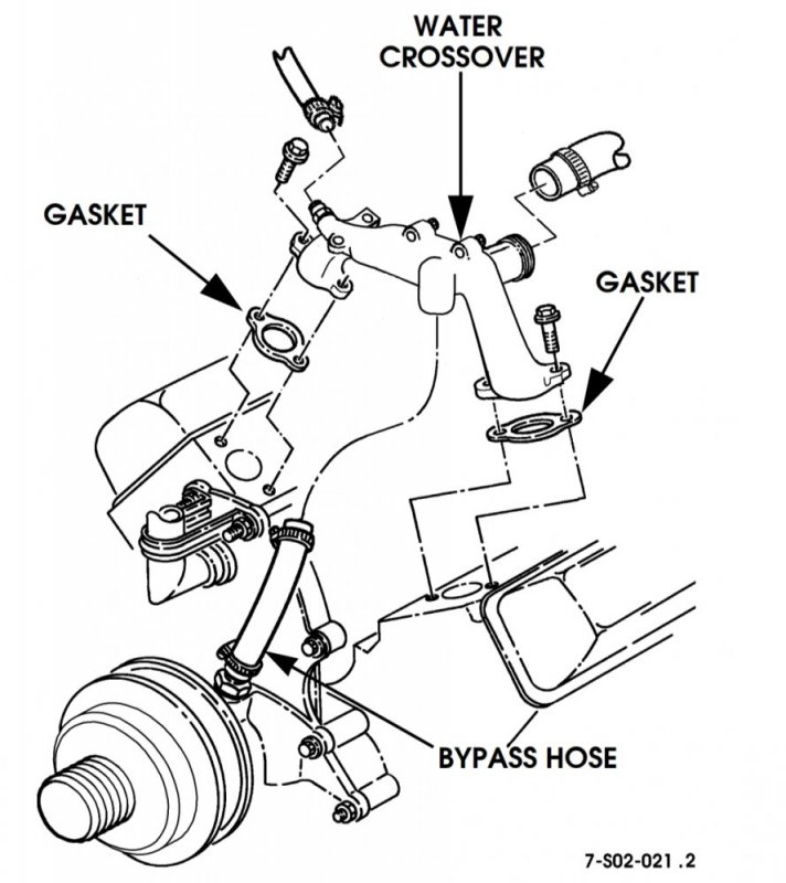

on the ones made strictly for water heating, I have been thinking in my head on the flow of coolant in the block if a circulation pump was to be tee'd into the heater core circuit. as it it now with the single stat setup (not sure about the dual setup) the flow would go through the heater core in the cab, but be forced mostly through the passenger head, some would also be forced through the drivers head also due to the block off plate in the t-stat being closed. I think it would do fine to keep the block warm enough to eliminate cold starts in low temps. the trick is to make sure that when the engine is running and the circulation pump is off, that the engine would still flow through as to not block off flow. I think this would be a trial n error run to find out.

I didn't buy an AutoZone starter... I just had them get one out so I could see what size bolt it was... On account of our power bill I love the truck unplugged last night and this morning I plugged it in about 45 minutes before we had to leave and she started just fine
