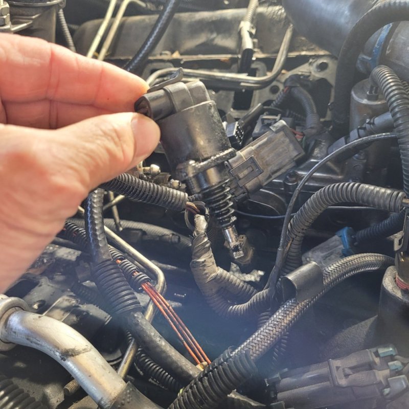

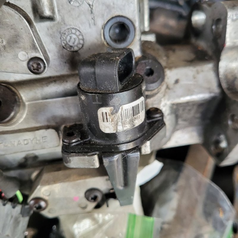

My son started pulling the IP and found one of the sensors came off the IP. Can we just reconnect? One screw is there. I have an old ip that I can scavenge from.

That is just a pulley not the harmonic balancer. Examine the balancer carefully.
You have two valid options for both balancer and the pulley.
Balancer: AC Delco or Fluidampr
Pulley: AC Delco or Leroy’s billet
The cheaper ones always fail quickly. Often with disastrous results.
Make sure the balancer is perfect and use loctite when torquing the 4 bolts through the pulley onto the balancer.
After reconnecting everything and topping off the coolant, it is still smoking. When we started it with no belt there was a puff of smoke and then it cleared up. So with the belt on it smokes and stutters. I think we'll take the belt off and run it a little longer to see if it smokes. It has new pre filter (no sock), new injectors, rebuilt turbo, pmd, etc. The only thing that would cause stuttering and smoke now would be the IP. Is my deduction correct? FYI the code (cant remember which number) points to IP.
Air in the fuel would cause stuttering and smoke. Address the loose stepper motor. If that does not clean it up, then you will need to address potential air leaks on the the suction side between the fuel tank and lift pump. My recent experience has been the o-ring seals are where the hard lines connect to the sender particularly with the age of the truck. Good news a new set of seals is less than $10 at Napa. Bad news, you get to drop the tank.

I realized that when I took the picture.
