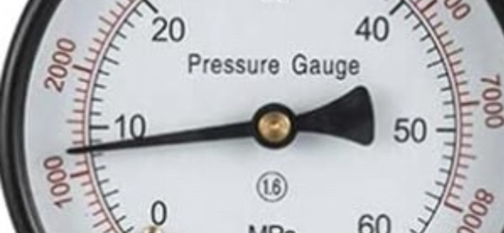

Thats a good price. I been planning to put one together hut at that price I am just gonna buy that and add my liquid filled gauge as one option -The gauge that comes on that is up 8,700 psi. Hard to get really accurate readings with that. Look at the close up screenshot of their pic: now imagine trying to get within 25 psi… is this 1200 or 1225?
When picking a gauge- understand 2 things:
1) like a torque wrench, always get one rated as close to the “in use” range as possible for accuracy. Dont get a 10,000 psi gauge when 5,000 will do. It isn’t better- it is twice as bad. And since a 3,000 psi gauge will do, it is over three times worse.
1% accuracy x 10,000 psi means off by 100 psi. But one time it might be 100 psi low, and the next time 100 psi high- so your real results might be off by 200 psi !
A 3,000 psi gauge with same accuracy is 30 psi off so max of 60 psi difference.
