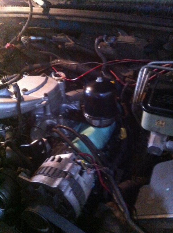

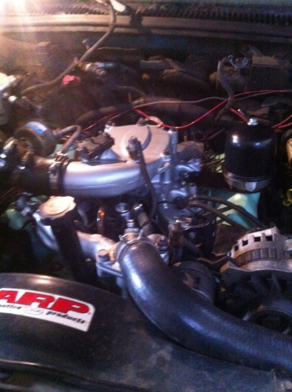

I bought this china block from bison and originally put on a remote dual filter bypass, the hoses leaked, so I use double braided hyd hose. I wasn't happy with the hose routing of the stiff hose so I went back to the 4X4 adapter. When I put it on, it had to push the freeze plug with the pin hole up about 3/16".I wish there was a good way to ramp that oil pressure to 90/100 psi just before the centrifuge.
How high is your pressure running down the hiway?
