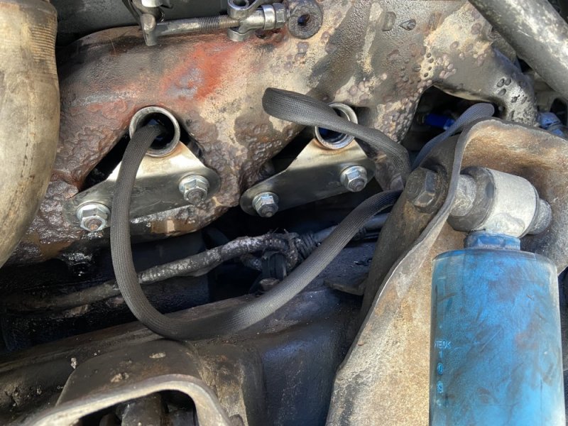

For the glow plugs on the passenger side, I used my little 1/4" drive Craftsman battery ratchet. I get in with the 3/8 to pop them loose and spin them out and back in with the battery ratchet and wobble extensions from Harbor Freight. then torque them. Seems like I could never get much swing with the 3/8 ratchets.

I took out Bosch and they were 10mm. The AC Delcos are 10mm, but the height on the nut is taller which provides more to grab.

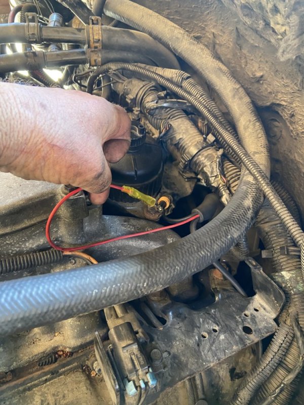

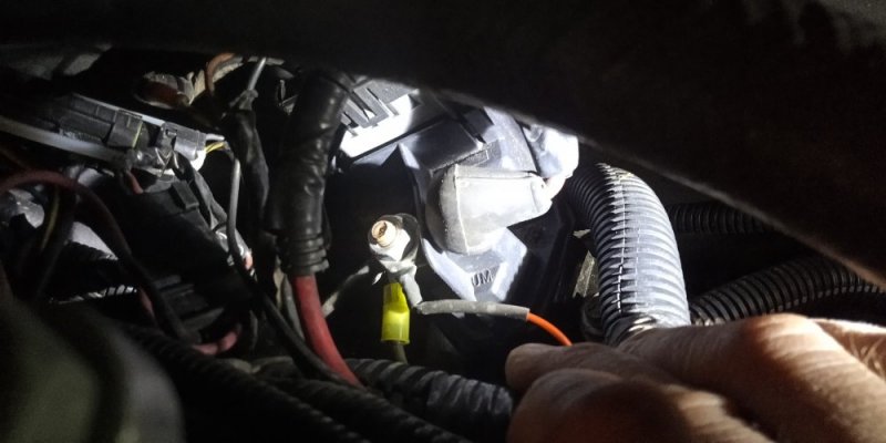

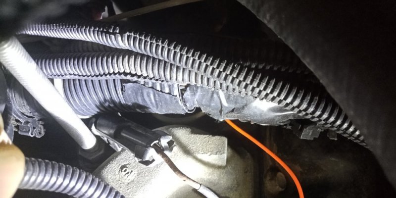

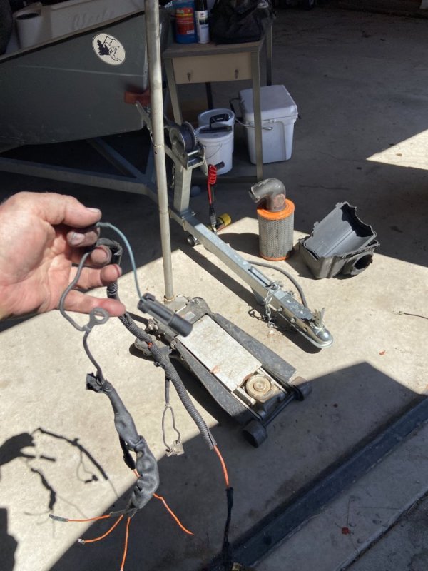

OK, got the shields and harness in on both sides. The new PT Wiring harness has a red wire with a butt splice. The old harness had a black wire with a plug end. Is that where the red wire from the PT Wiring Harness goes?

Looking at your last picture you have a big wire in that group with the rubber cap. Looks like the main battery power wire, nothing should be connected with it. My first picture shows the output side of the relay with 3 wires, one for each side of the glow plugs harness and the 3rd wire goes to the one you unplugged.
The PT Wiring harness has separate ring terminals for each side as opposed to OEM which has all going into one and on that terminal. Both PT and OEM have a single wire (red in the case of PT) coming out of those ring terminals. In the case of PT with two sides, the red wire comes out of the passenger side ring terminal with an butt splice on it to be crimped to a wire. His instructions say to pull the old harness to find the wire, but then
speaks of two orange wires, so it’s confusing.
Anyway, the only other wire that went into the OEM harness was the one with the plug in it, so that has to be it.
Seems to me you should cut off the end from the old harness, crimp and heat shrink it onto the new harness. iirc they don’t all use the same connector, so that’s probably the hy he left it as the butt splice end.
I cut off the harness side of the plug and butt spliced to it, then connected the plug.
