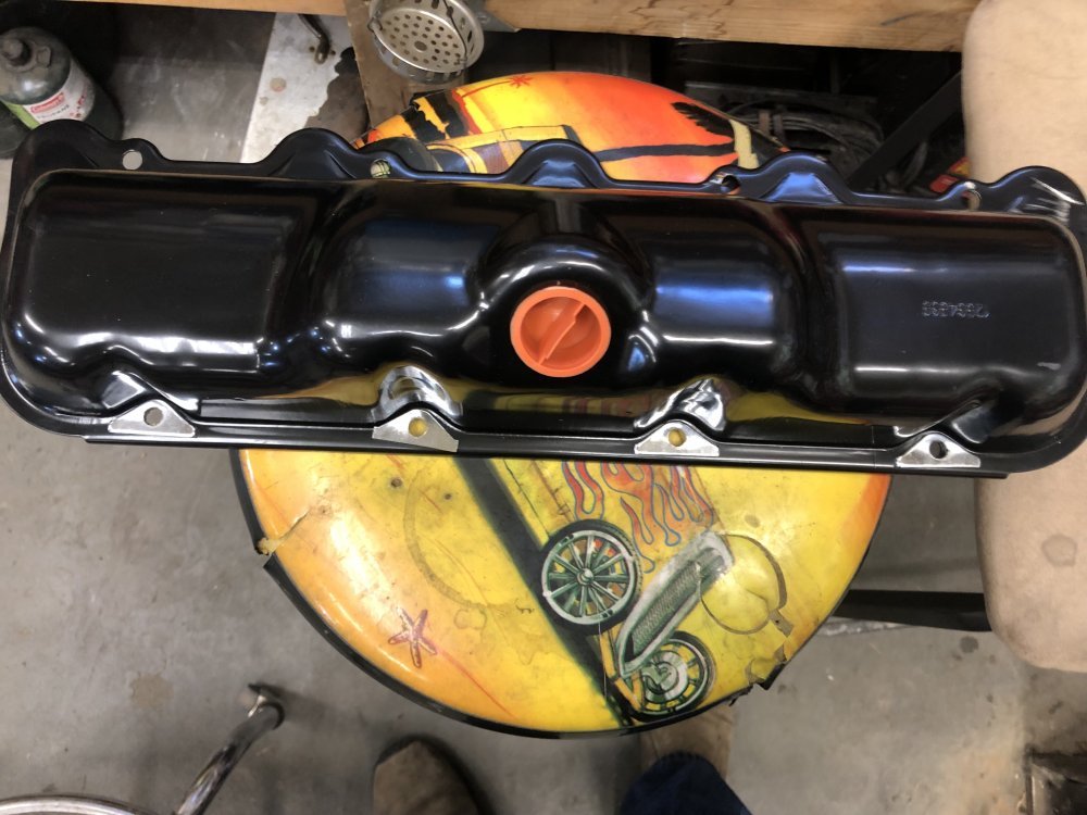

I used the Dorman units. Stamped steel is stamped steel.
I really think you should consider the cork gasket under the cover and the girdle directly on the valve cover.

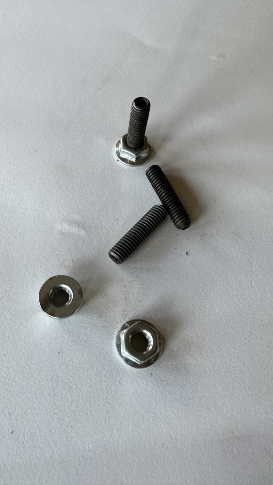

Corked mine. Sourced the studs and flared nuts through McMaster-Carr, Ace Hardware, Tractor Supply or your favorite nut and bolt store. M6 x 25mm 1pitch studs, black oxide. Steel Nonmarring locknuts (aka Flared), zinc coated.
Right Stuff on heads and rim of the covers (I wasn’t too sparing). Let it skim over while inserting studs into the heads.
Set gaskets over the studs, Set the valve covers on and just snugged the nuts till the Stuff was evenly squeezing out around the perimeter and let it set up. Next day, torqued ‘em down. No leaks and several years later, a pissed off mechanic can’t get ‘em off.
Those are called flange nuts for anyone trying to find them. You can get them with a smooth bottom or a serrated bottom and you can also get them with a pinched top for locking.
I usually use stainless serrated flange nuts. For no more than I use. Total expense doesn't add up too fast.

Cork gasket under the cover, girdle directly on the cover.
I know some have trouble with leaks, knock on wood I have yet to have a leaker in the many I've built. I found the flange on the cover is wider than the rail on the head, thus if sealant is applied to the cover it almost misses and does miss the head rail in the corners.
App " the right stuff " on the head rail first, a nice tall wide bead, let sit for a good while, while waiting, apply a bead to the cover, not as big as the head tho, let that sit a while.
Then install cover and only lightly wiggle it, don't push down much.
Take a q-tip or something and clean out and line up the holes, install the bolts loosely only, gently push the cover down, the idea is to NOT squeeze the goop out, next day snug the bolts.
Don't rush it and you won't have a leaker...
