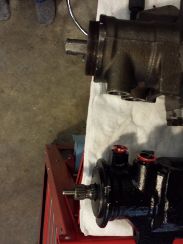

Here is a pic of the GMT400 splined input shaft (swapped into a Delphi 800 out of an '04 K2500) & the GMT800 smooth w/ two flats input shaft. So at a minimum, to try the 680 box, the lower steering shaft coupling would have to be adapted to the 680 input shaft's smooth/2 flats shape.
