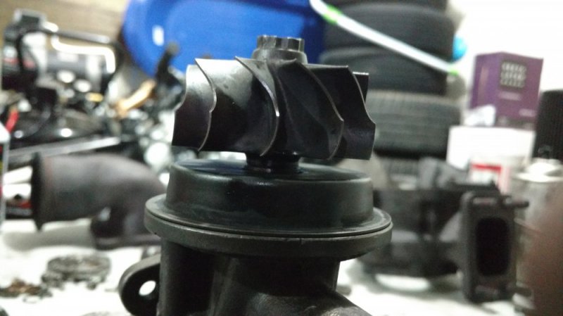

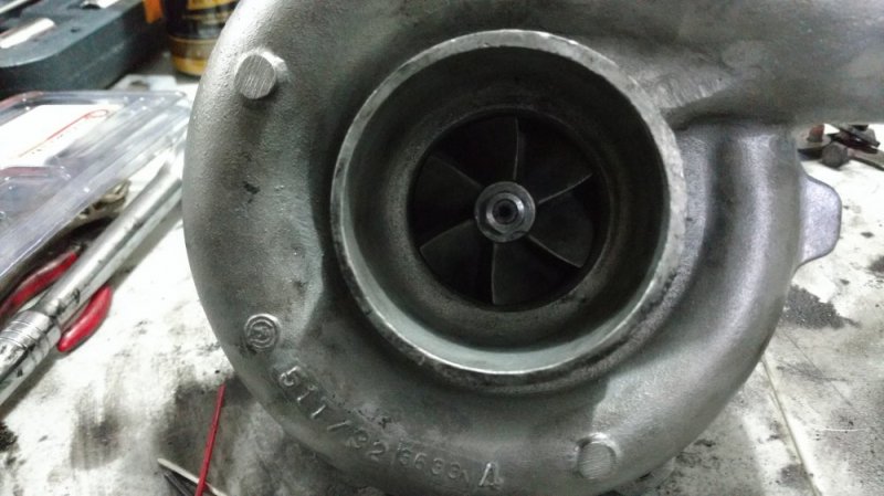

Hoping someone is still around here that can answer a couple questions for me. I'm rebuilding my GM-4 turbo off my 95 K1500 suburban. Everything has gone pretty smooth until I went to put it back the housings. I'm attaching pictures, I feel like the blade on the exhaust side isn't seating deep enough but after several times apart and back together I can't see how this would change. Additionally once I have the housing around the intake side the turbine no longer spins, is this normal? First stab at something like this rebuild so I appreciate the insight.
Been awhile since I had one apart but it sounds like the wheels aren't seated on the shaft fully.
X~2
Might have to remove the wheels and compare the new components to the old to make sure that all the parts are exact and precisely what the old components are.
Make sure that there is not something that is keeping one or both wheels from seating on the shafts.
Also, I believe there is a gasket between the housing and the ends, make sure the gasket{s} are of the proper thickness.
Thanks guys, I did check the old and new parts against each other to confirm sizing. The bearings both spin smoothly and seat to the same spot on the shaft as the originals when not installed on the turbo and are sitting locked in the right spots internally so I will have to pull everything apart again and see if there is something I am missing.

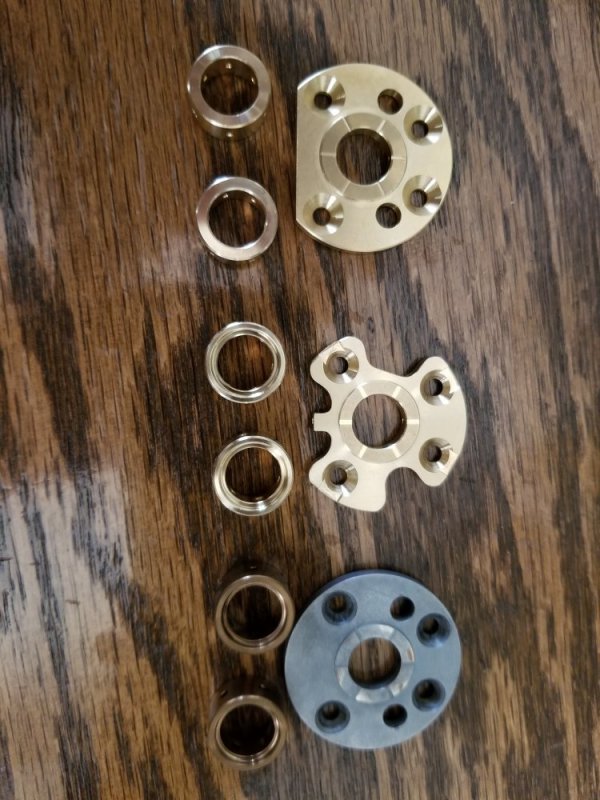

Ok, so I got my rebuild kit in today. Took all my old turbo main parts (core, snails, blades, bolts, etc.) to work today to use the clean tank, gonna let those sit overnight in the solvent. As for the replaceable parts... what is the differences? Apart from the brass bushings (one has a lip & is taller, the other is flat & shorter), what are the differences in the trust plates? In the picture, the two on the left (top) are new & included with the kit. What came out of my turbo is on the right (bottom). Does the full circle hinder oil flow? Does the half circle hinder oil flow? Does the star shape hinder oil flow? I don't know what the reason in different shapes is other than oil flow/control. I would go with the star shape for better oil flow would be my guess but maybe I'm wrong. Ideas? 20180611_173743.jpg
Any idea as to design differences? I haven't found much guidance in the ways of changing which bushing to use, but as far as trust plate design, I'm leaning more towards the middle. Obviously someone didn't machine that piece out for no reason compared to the others. The others (to me) look like someone just said "meh, it's good enough" & shipped it.
As for the bushings, I'm going to use the same style as what came out of it, the bushings with the lip on the edge & not the flat ones. Anyone else have advice on this?
Also, the kit came with a bunch of small screws. From Really short, to short, to medium, to long. They are all the same size, just length is different. Looks like they are all for the trust plate depending on what screw length you need? These new screws are philips though & not torx. Any advantage to either? I find torx aren't as likely to strip but from what I've read, these torx screws are prone to strip? I can replace the trust plate torx screws, however the aluminum end cap will get the same torx screws put back as the kit did not come with the bigger size screws (not sure if it was supposed to or not).
