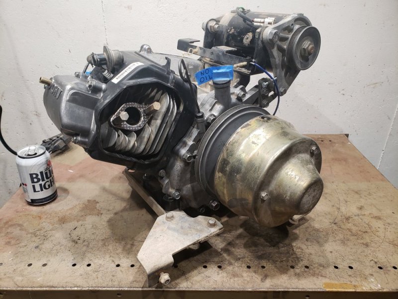

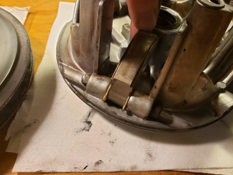

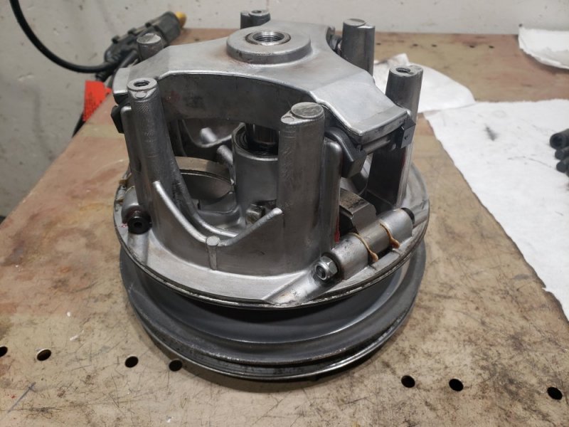

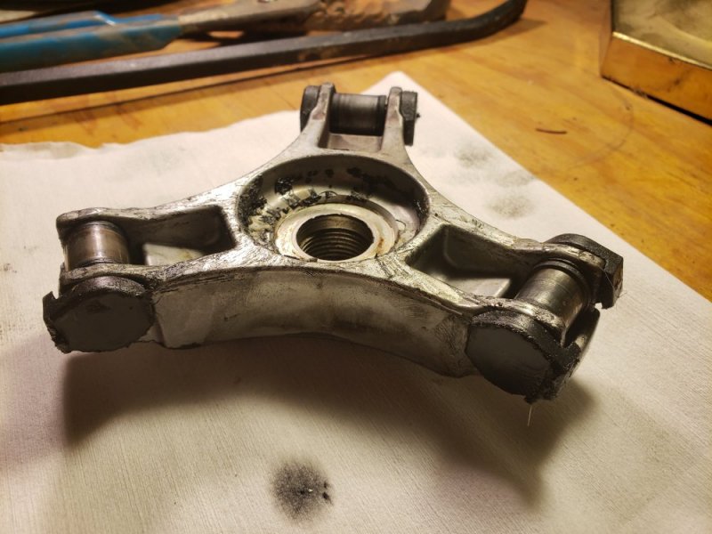

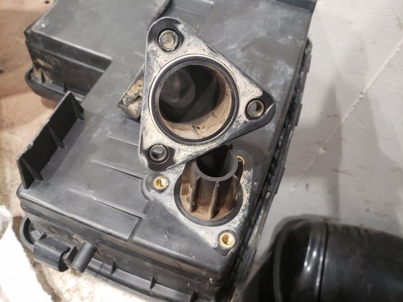

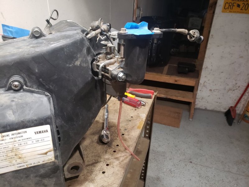

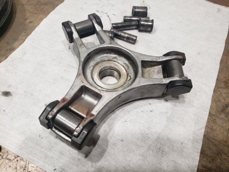

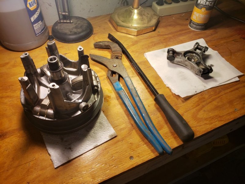

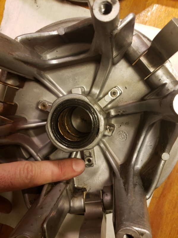

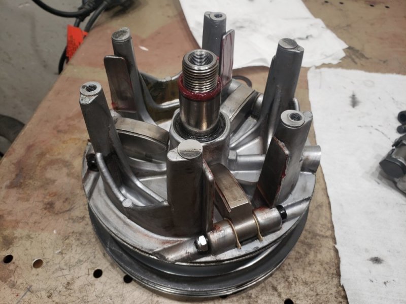

Got the primary rollers replaced and greased. Also got the crappy eBay carb cleaned and back on. Mix screw set to 2 revolutions out from bottom.
Gonna guess dirt ingestion was the demise of this engine previously. The intake was just horrid.

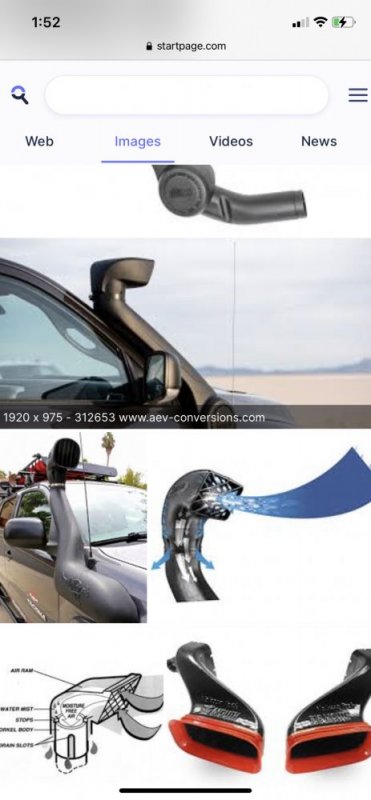

To be honest with the roads at camp being dirt and dusty in the summer the stock intake systems under the cart worry me. My plan is to eventually do some type of custom canister filters and route the fresh air like a snorkle up above the body. Main worry is sound. I really don't want to hear it sucking air all the time but the dust beneath the cart kills filters fast.
With a large diameter "ram" type snorkle, intake air velocity should be low enough at head level that you shouldn't hear anything. Especially if the mouth of the snorkle is above the canopy/head height and behind you. Heck, with one of those you could go fording through the golf course's water hazards looking for your lost golf ball! Just like @Will L. going fording with his Hummer!
I hope so because I want to do it on all 3 of the family carts. We will definitely do a test run with one of them this summer and likely convert all. Was also worried that large intake tubes may hurt the velocity on these small engines (well the 2 stroke and my 301cc, not worried about the 670 v twin).
Large intake mouth and smaller than the mouth snorkle tube. Look at snorkels for Jeeps and Toyotas. Gives you a ram air effect while driving, especially if the intake mouth is up above in "clean" airflow. Wouldn't matter at idle/off idle. At 20 mph it would definitely be cramming air down the snorkle, who needs a turbo!
It can hurt performance a little, depending how long it is. But it you do one that is foreword facing, there will be a tiny lag from a stop but foreword air speed negates it quickly.
The water isn’t really what I am as thinking. It’s the dirt, getting that air intake away from the ground is always a good idea off road for cleaner air.

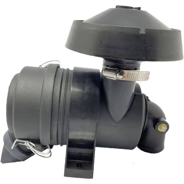

Hey, @DieselSlug , look at what I found in the new 2022 Surplus Center catalog! I don't know your lug pattern or if the rim/tire set would fit and work on your golf cart or if you can fit 14" rims to it and run the UTV radial tires on it, but the prices for either are damn cheap! Also, check out this air filter assembly for off-road, too.
