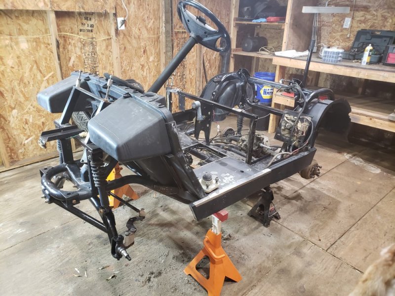

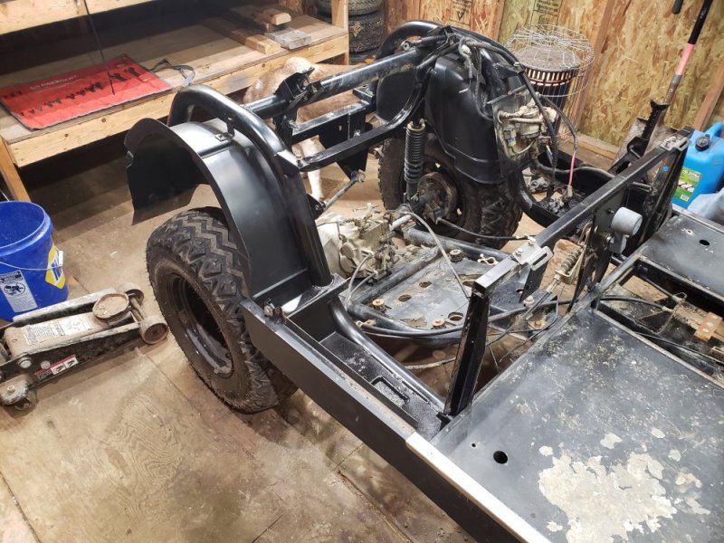

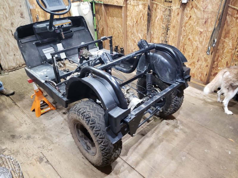

Got more done, but no pictures to prove it.

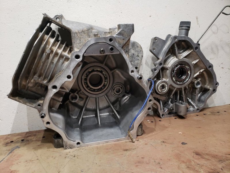

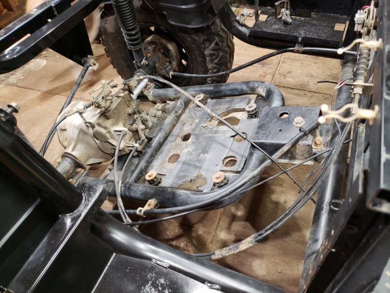

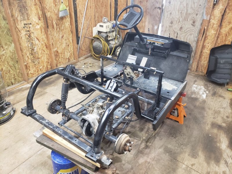

Cleaned out the rear pumpkin which all looked good. Scraped off the gobs of blue RTV on the cover and replaced with form-a-gasket. 85w-90 gear oil added and plugged. Also removed the 2 crank seals in preparation for new installs. The crank bearings seem to be in very good shape, nice and clean with no grinding or roughness throughout rotation.
Currently at a standstill waiting for parts. Hopefully this Project will get started back up the week after Christmas.

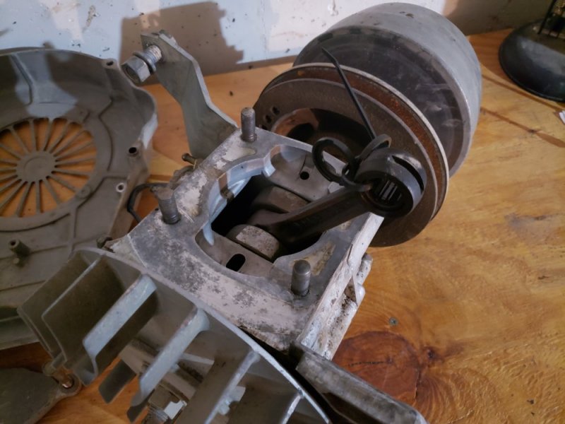

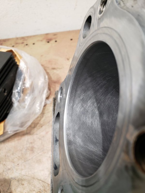

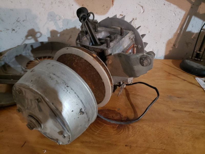

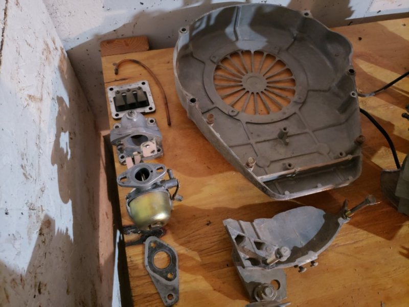

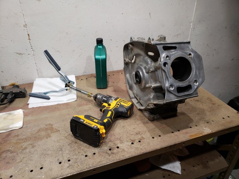

In the meantime we started cleaning up the 2pg out of the Marathon. The new jug, piston and rings came in the other day. We scraped the mud from the crank case and cleaned it out the best we could. Will try and throw some pictures in soon.

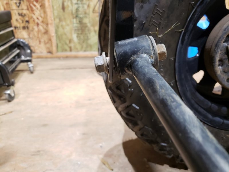

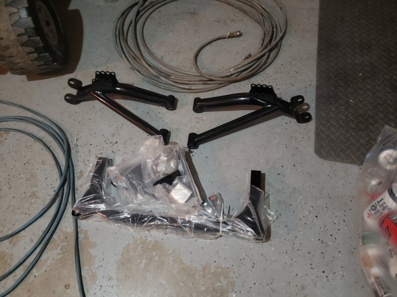

Well got the Rhox 6-inch lift started. Had some struggles and still do woth the angle of the rear track bar. From what I see on their how to its just a crank it down scenario. I don't really like that idea. Anyone have alternatives or did I do something wrong?

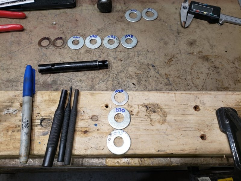

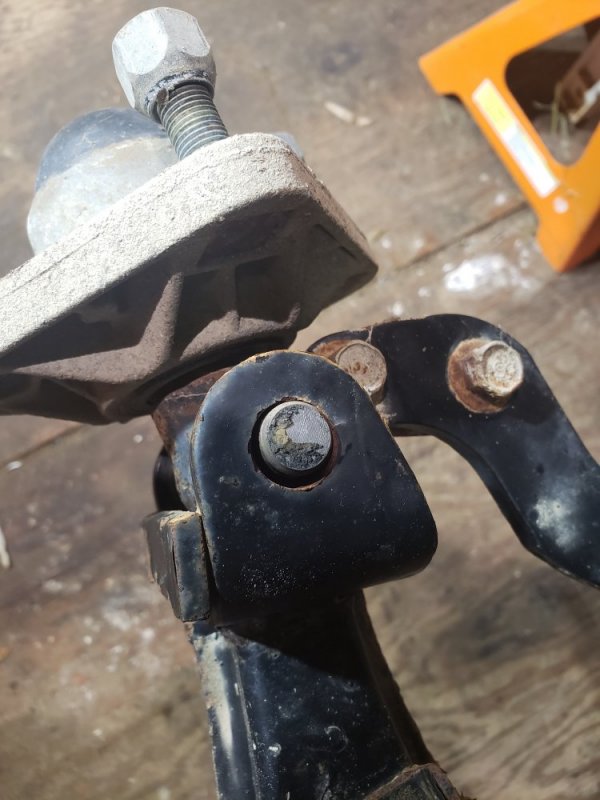

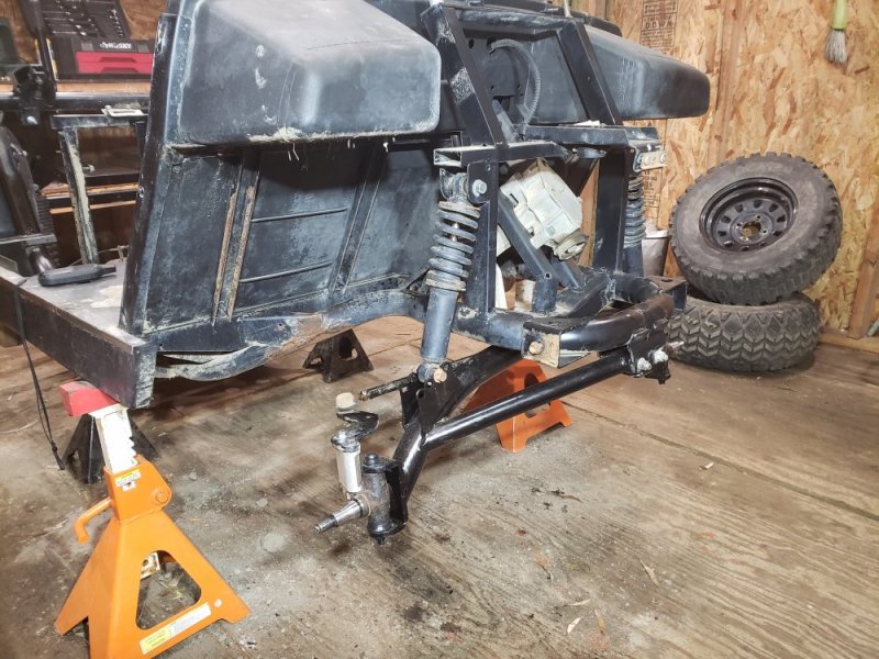

The fronts need shimming of the kingpins vertically in the c-channel of the a-arms. Awaiting a drill bit to make it work with some smaller I.D. shims.

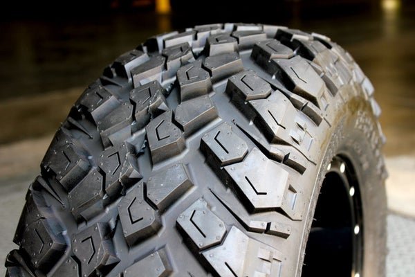

So, I take it you got everything all shimmed and good to go? Can't wait to see that thing with the 11.50x15 BFG All-Terrains on it, LOL!
Yes. At first it was just too tight. Had to pull a washer out and grind a bit after I enlarged the I.D. its not "perfect" but with washers as shims I guess I am happy with how it turned out.
Not gonna lie, looking for more of a road pattern type tread. BFG mud terrain?
Mud Terrain is big lugs with lots of void, very noisy on pavement. All-Terrain is civilized on the road, with very good off-road manners on dirt, in mud, snow and sand. A lot of the winners of the first ten or so DieselPower annual Diesel Challenges (which included sled pulling, drag racing, mpg competition, maneuvering with a trailer, etc) where competitors could only use one set of tires throughout all the competitions, were won on a set of BFG All-Terrains.
