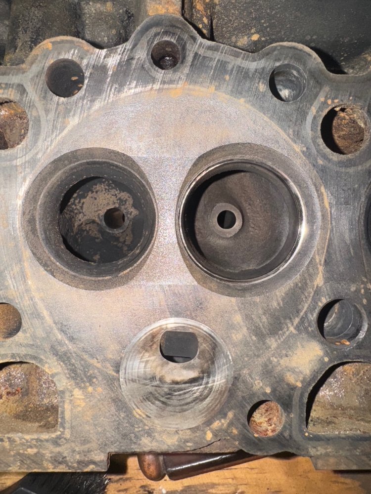

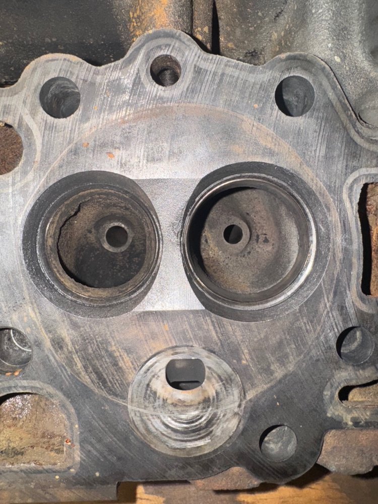

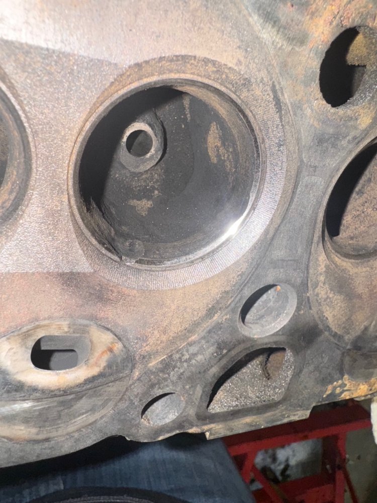

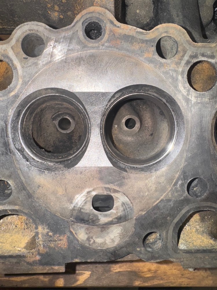

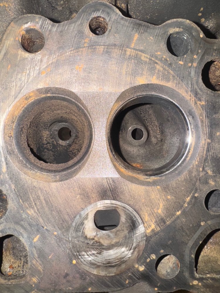

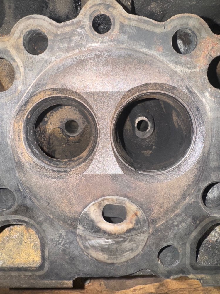

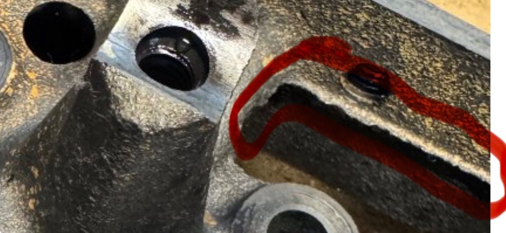

Once the flashing is all out, you can choose to spend a little time taking the edge off the oil return holes. Doesn’t really help a ton- but for 5 minutes more per head is worth the time imo.
