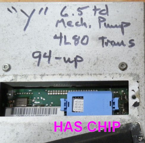

G Glagulator GM diesel junkie Messages 168 Reaction score 501 Location very south Texas Aug 30, 2024 #42 Has the van worked correctly before these problems or did you buy it like it is? It would help if you could get the code and part number off the eprom chip in the TCM. EXAMPLE - Attachments TCM-Chip-only.JPG 43.4 KB · Views: 3
