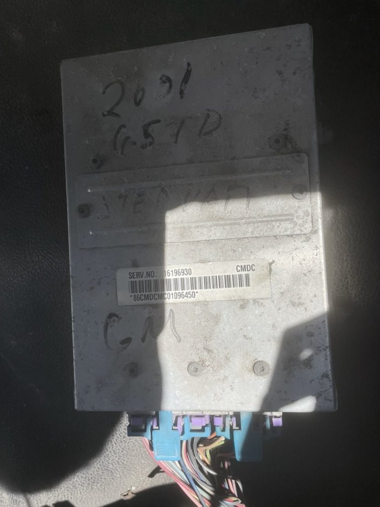

Hello all, 2001 Workhorse P42 step van: I have this same issue with Speedo running fast and not shifting into 4th gear. Trans has been rebuilt but still has the same problem. My mechanic thinks it’s the EMC/TCM since it doesn’t look like it is the one that came stock in the van (it has paint marker info on it from a junk yard). I contacted workhorse parts and they said I need this part number #09357159 that they are out of stock. The current ECM in the van has this number on it 16196930 and I can’t figure out what vehicle it came from? Any ideas where I can get a new ECM/TCM or get the existing reprogrammed?
If you have a vin "Y" L57 diesel engine and 4L80e transmission
then the correct TCM is GM 16196390. Maybe you made a typo?
09357159 is workhorses part num for the same TCM.
Does your TCM have a 4 letter code, like BJDM ?

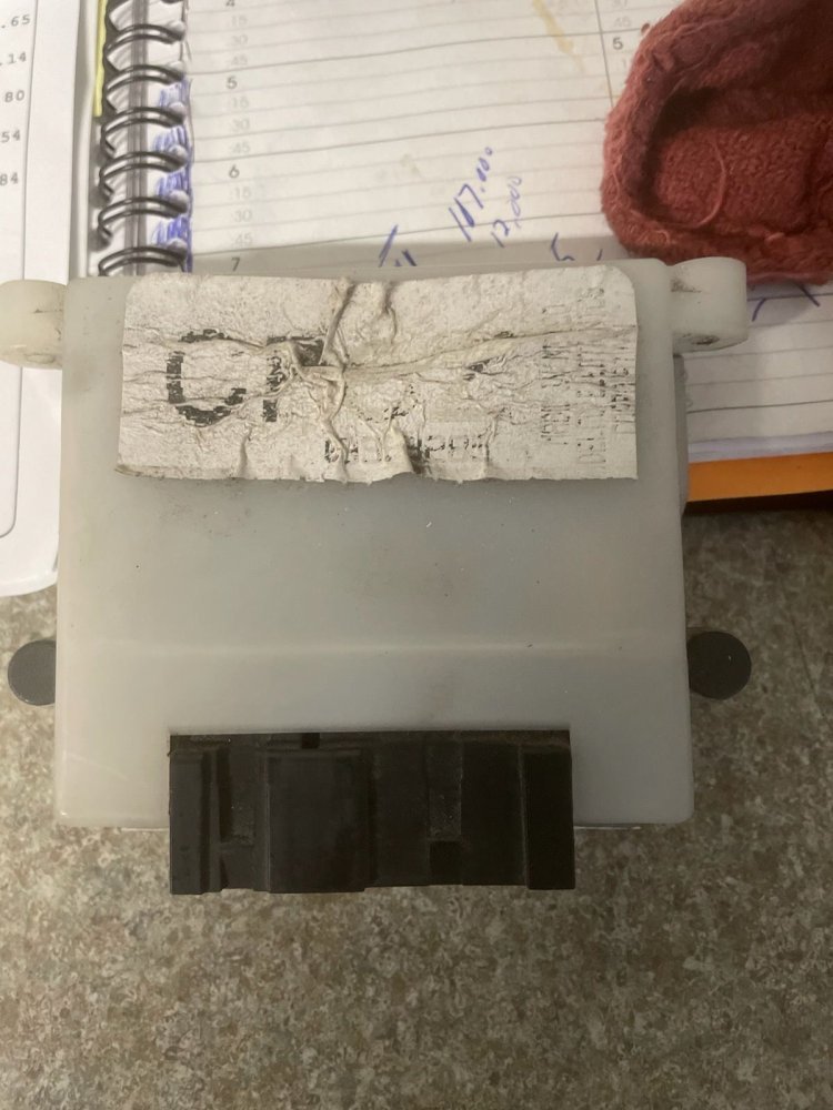

Could be a bad or wrong VSSB. What is the part num on the VSSB?
