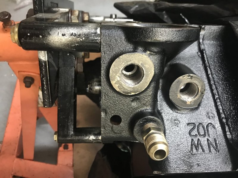

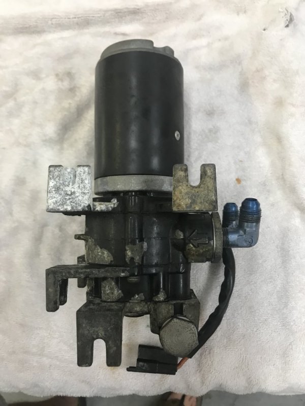

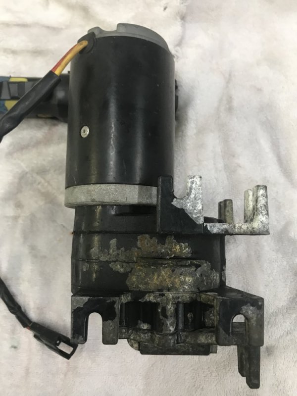

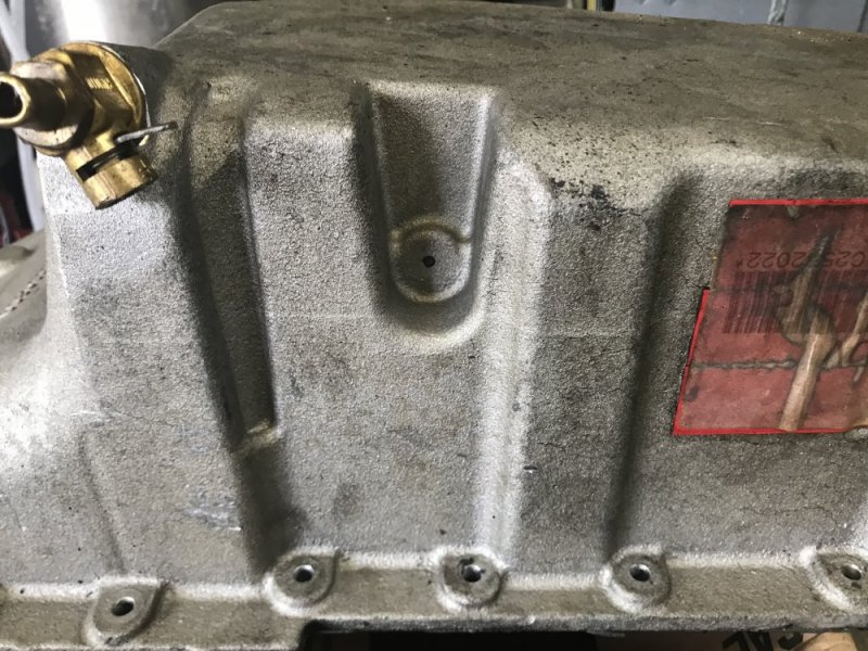

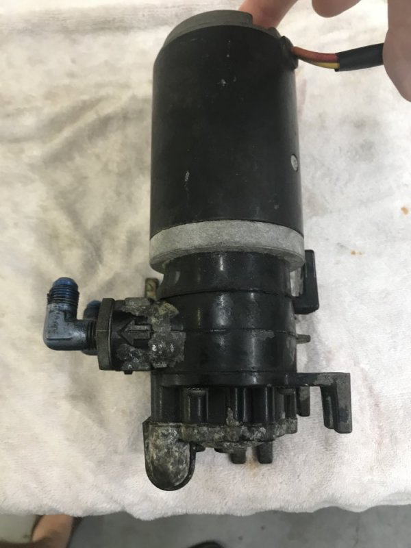

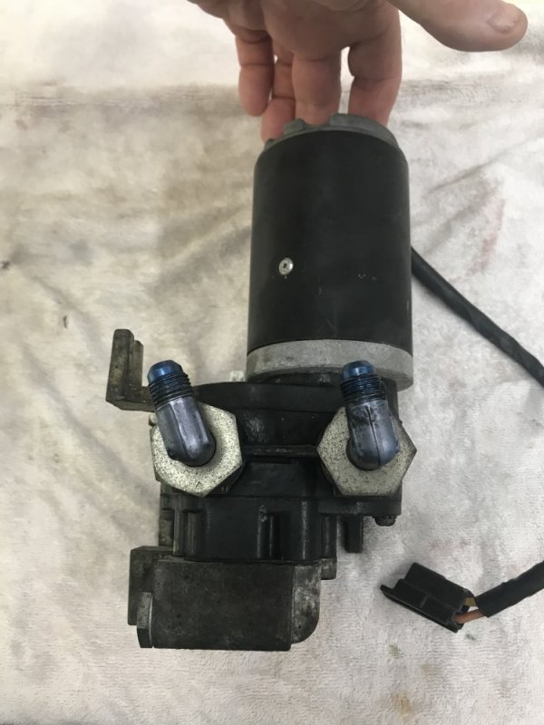

Here are some pics of the pump and how I'm thinking of plumbing. This thing has been laying around my shop and when I blew it off with air it blew all of the paint off the pump portion. I don't think I will use this pump for a permanently mounted setup due to it's size and age, also it would take up too much real estate under the truck which I'm pretty short on being it's a suburban with a cat pre fuel filter, lift pump and 6"X 26" stainless compressed air tank on the drivers side and the exhaust on the passenger side. I would not even think of mounting something like this on the outside of the frame subject to road debris and such. The other two photo's are the one where I would go into the block possibly with a check valve (not for sure if needed) and the other is the black dot on the oil pan. I would drill and tap and put a #6 AN fitting there. I did a test with the pan level, 4 quarts just barely covers where the hole would be but 4.5 quarts puts the level about 1" above the hole. Not sure if this location is low enough in the pan but the pan is cast for something to go there I think, oil level sensor? maybe for the Hummer? Sorry the last two pics are upside down.

So I was studying the oil flow schematic and from what I understand the operation of the two OEM bypass valves located just above the oil filter operate as follows, one is if the oil cooler becomes blocked or oil density (from cold weather) is above 9-11 psi it opens and bypasses the oil cooler and directs oil to the engine. The other bypass valve operates the same but it is if the oil filter becomes blocked and the pressure reaches 16-19 psi it therefore bypasses to the engine. So under normal operation I would think that there would be no positive pressure to the port that I am considering using, but under bypass situation there would be whatever positive pressure that the mechanical oil pump is producing. Therefore either the preoiler pump would have to prevent reverse oil pressure bypassing back to the oil pan or a check valve would have to be installed to prevent such a reverse bypass condition. Open to opinions, correct my if I'm wrong. Does anyone know anything about a oil level sensor in the pan on the Hummers?
I forgot to add that the oil provided by the preoiler pump with this configuration would be unfiltered directly from the oil pan. Which I believe the benefits would outweigh the negatives, especially in a new p400 with Total Seal rings that I will be running.
