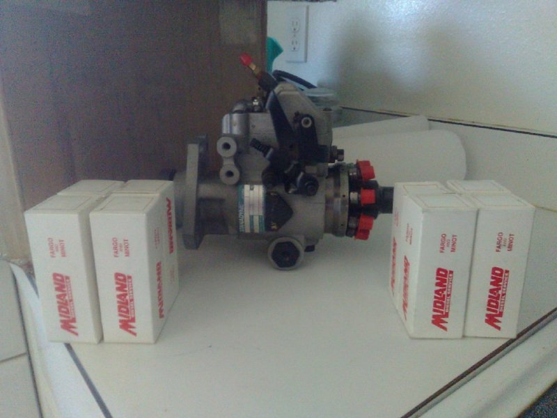

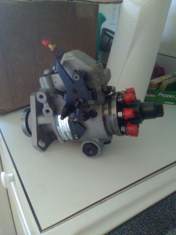

Well, the engine is almost ready to go. It's sitting at my house. Oil pan with it, along with some of Leroys nice and shiny oil cooler lines. And today's present: Injection Pump and Injectors. Courtesy with a new and handle dandy torque screw as well that my pump guy installed. He was curious what we could do with it. Said the way he has it setup now, it's stock fueling levels. Adjust it all the way out, and it's 100cc's. And anywhere in-between. I assume he set it up to full fuel in the fuel screw and then adjusted it back through the governor. Should be handy to try out. To my knowledge, I don't think it's been done yet on a 6.5L pump. I know on the 7.3L IDI pumps they come with one.
