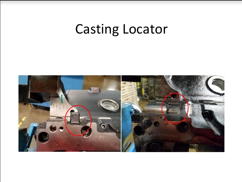

Straight from AM-General
[email protected]
8:04 AM (2 minutes ago)
to me
That would normally be machined to provide clearance for the starter.
Careful grinding of material to allow mounting clearance can be done, paint the raw metal after grinding with a good high temp primer and paint suitable for the casting.

Small update on the warranty issue, from GEP:
[email protected]
7:43 AM (10 minutes ago)
to me
I just received a reply from GEP, since this casting is normally removed, there is no warranty ramification if it is removed to the normal level as in the attached photos.
They apologize for any inconvenience this has caused.
