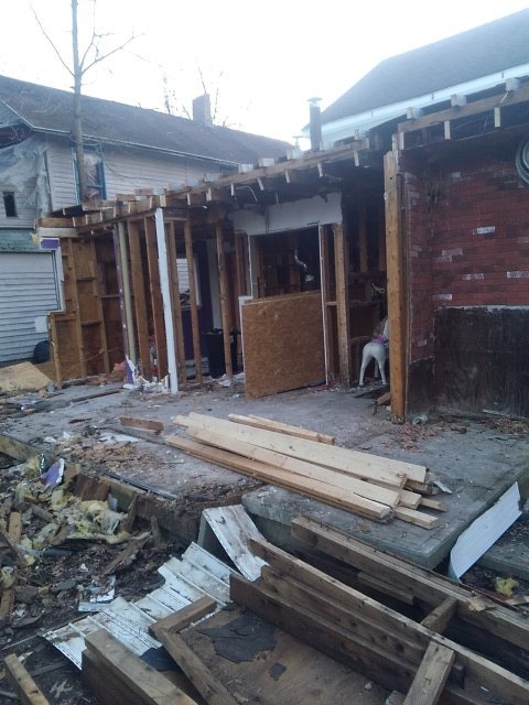

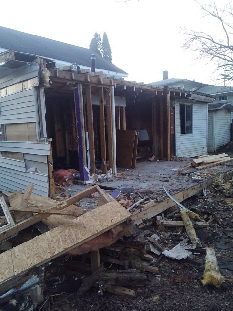

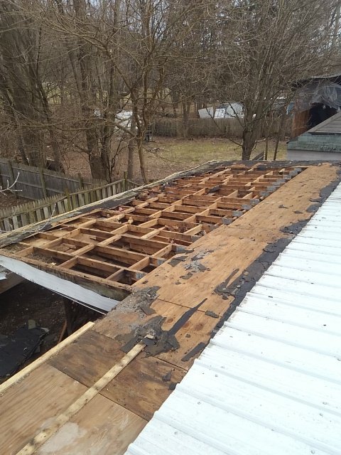

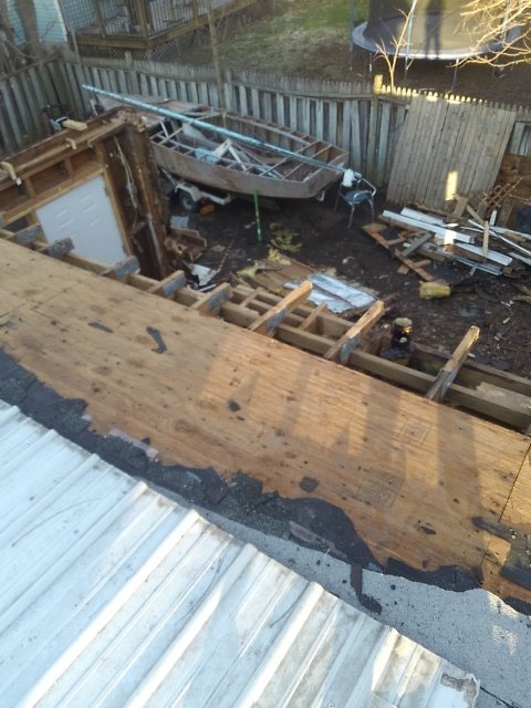

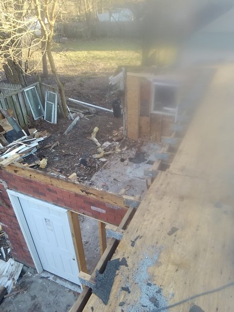

Well proved once again, don't let a guy have anything that ends with the word "saw" when he's bored.... reciprocate saw is my favorite, (unless I can use a demo saw which is rare)... We wanted the addition off the back of the house anyhow, so when a branch of the neighbors tree decided to fall on the roof of the addition in a storm, I figured well it's as good a time as any... Doesn't help that neighbor house has been empty for years, and nobody has a clue how to get ahold of the owner. Doubt there insured anyhow especially for act of nature...IMG_20210327_191126.jpgIMG_20210327_191126.jpgIMG_20210327_191126.jpgIMG_20210327_191100.jpgIMG_20210323_181354.jpg

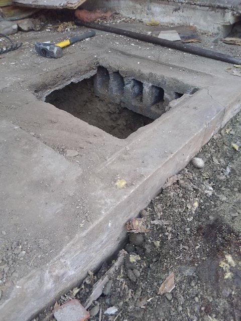

Still trying to figure out what that square hole in the concert was.. (could possibly be part of the bomb shelter that come to find out is under back of the house..still haven't opened that up.) This part in the pic has 1/2 " copper pipe going into it, and a drain pipe.. where the square hole is there was concrete poured to seal it off loosely.. one hit and that fell out leaving what you see in the pic.. whole thing has me confused
And concrete blocks are not designed to bear the load the way those are set in. They should have the flat side and holes verticle.

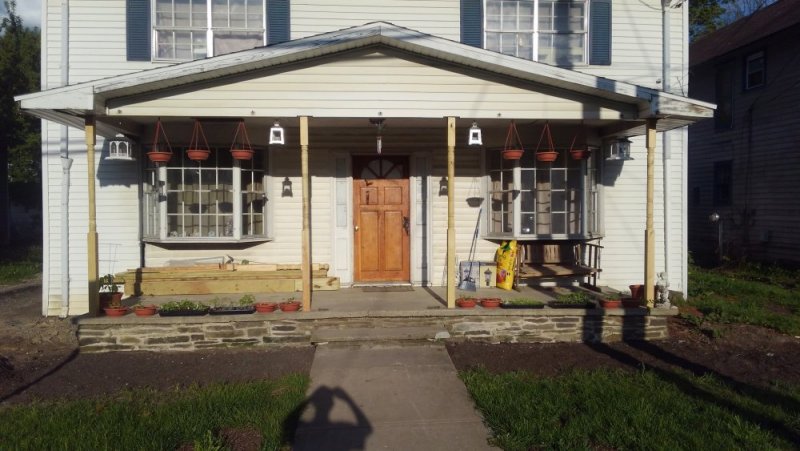

Decided we didn't like the shrubs in front of the house a couple weeks ago...so we cut them down...🤔. Didn't think this through..now there's stumps in front of the house...nope that don't look good...tried digging them out, but that was to much like work...sooooo, screw it hook the truck to them...couple hours and a helpful state trooper later and there out...( He blocked traffic so I could back in the road pulling them .) Gonna attach pics before and after.Decided we didn't like the shrubs in front of the house a couple weeks ago...so we cut them down...🤔. Didn't think this through..now there's stumps in front of the house...nope that don't look good...tried digging them out, but that was to much like work...sooooo, screw it hook the truck to them...couple hours and a helpful state trooper later and there out...( He blocked traffic so I could back in the road pulling them .) Gonna attach pics before and after.also changed the porch posts . And exposed the stone work..the first pic is from the listing when we bought the house. Shrubs had gone to hell since pic was takenScreenshot_20200213-113525~2.pngKIMG3946.JPG
