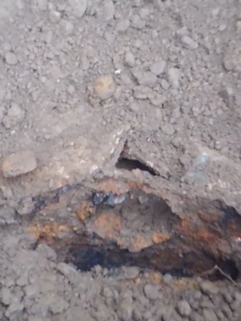

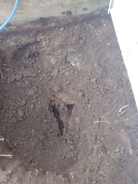

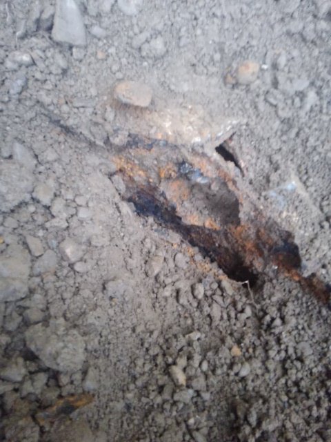

Had to scratch the idea of using electric baseboard heaters.. with the cost of the breakers that I would need and how astronomical the cost of 10/3 cable is now, there's just no way I can afford it. So I'm going ahead and putting into black gas pipe for natural gas and seeing if I can convince somebody to do a pressure test on it so the gas company will turn my gas on.. I already have a furnace and duct work that I can install they're used but still work.. and I have a gas stove I can put in.. only downside is I have a brand new electric hot water tank that I won't need. should be able to throw it on Craigslist for a couple hundred bucks and get some of my money back out of it. I just figured for all the breaker and cable it would have cost easily 5 or 6 hundred dollars. To put the gas pipe in and the valves for maybe a 100-150$... Plus whatever I have to pay to get a pressure test done which can't be that much. .. but as luck would have it I decided to investigate the sewer main today, keep in mind I bought the place as is and only paid nine grand for it so I can't b**** about very much...when I dug a hole in the ground where the main comes out of the house attached pictures show what I find... I'm not positive but I think the tank is caved in. But I've never seen a metal sewer tank. If you look closely you can see where the busted pipe comes in to what looks like what's left of the side wall of a round tank.

I don't think the whole thing is caved..(just a hunch) I say that cause there's not a huge sunk in spot in the ground. I would think if whole tank was caved in the surface of the ground would resemble a bowl. But not sure...gonna try to unearth the rest of it in next day or so to find out. Before cold weather comes back and ground freezes. I'm digging by hand with a shovel so frozen would be bad..lol.. if it's not completely caved maybe I can just drop a plastic tank in there.. don't know much about septic tanks so any input on extremely cheap way of doing it would be greatly appreciated.
I'm in way over my head on this place, story of my life...lol..
Given the house's age, would not surprise me if the 'tank' is not much more than a plank covered pit. Equally not surprising is if the 'tank' is just about silted-in, or almost up up to the top. Chances are good that the drain field was isolated from pipe collapse as it probably used the old tar pipe, so that might be salvageable. Put another way, condenser starting to work on a budget for something modern like a concrete tank and plastic lines.
Went through this drill not too long ago. I got lucky with the drain field as it was cut-off decades ago from pipe failure. Good news is that now I know where everything is. Price for a new holding tank was reasonable, but I can see where it might be a stretch when sidelined from COVID...
For heating, might look into wood gassification as I know it is somewhat common in the New England area. A little expensive on the up-front part, but quickly pays for itself. Can also plumb gassification boilers into hot water.
Oh, and careful where digging. You already hit bones once :D
