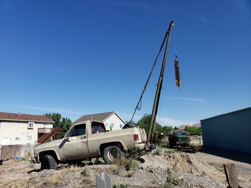

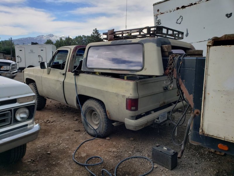

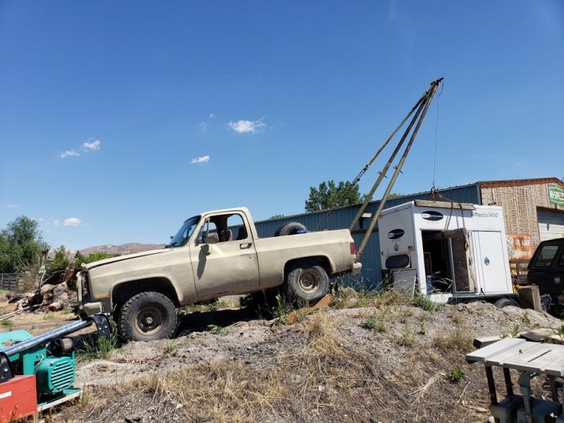

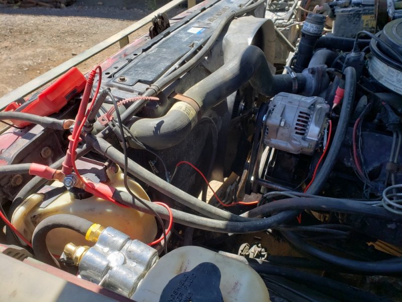

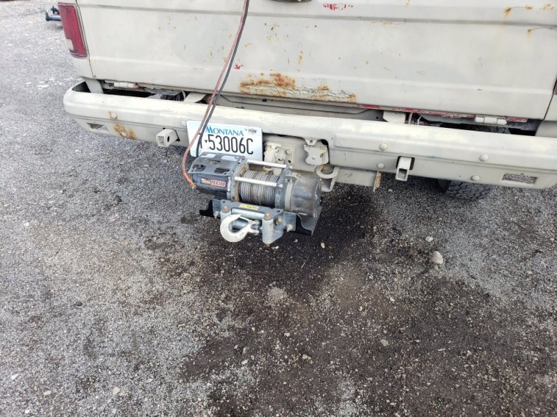

Got the power problem taken care of at the shop so decided to focus on the gin poles again. Using the Mile Marker 4500 lb winch I have even though it's a little small for the k5, with a snatch block it can pull it out and I have 3 snatch blocks available for it. Set it up on a receiver hitch mount so it can be mounted on the front bumper, rear hitch, or in the bed (yall might get a kick out of that mount haha).

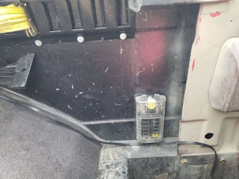

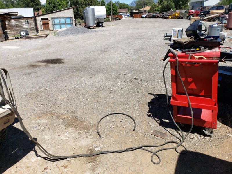

For now the jumper cables are serving as the main wiring for the winch. Won't lie the wiring setup looks half assed right now since the solenoid box is falling apart after all these years (plastic has been crunched many times).

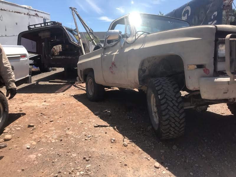

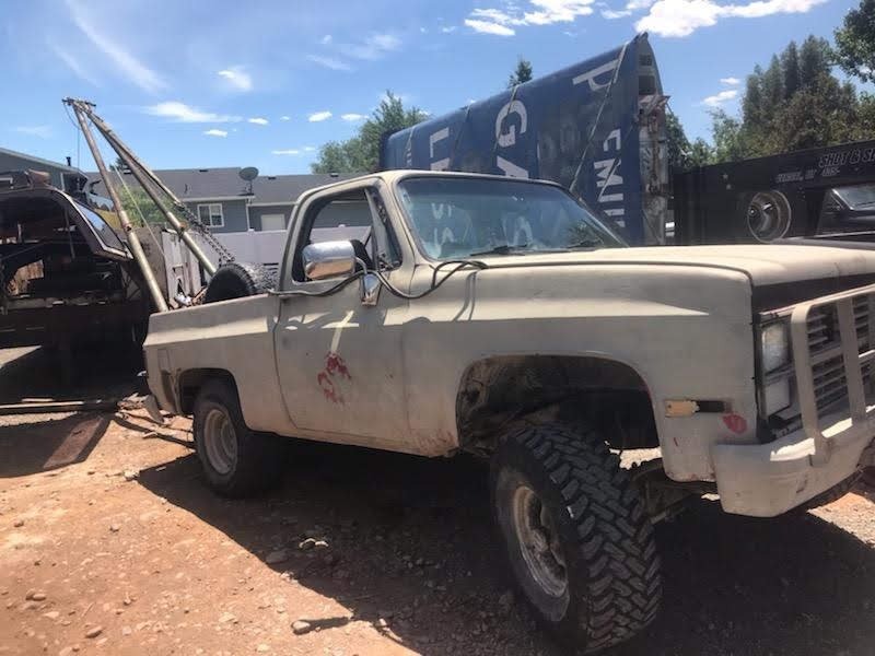

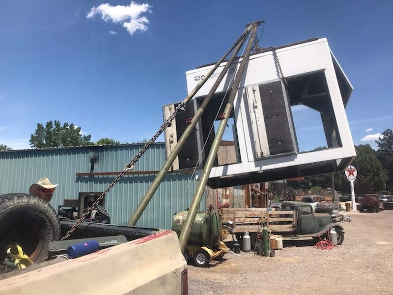

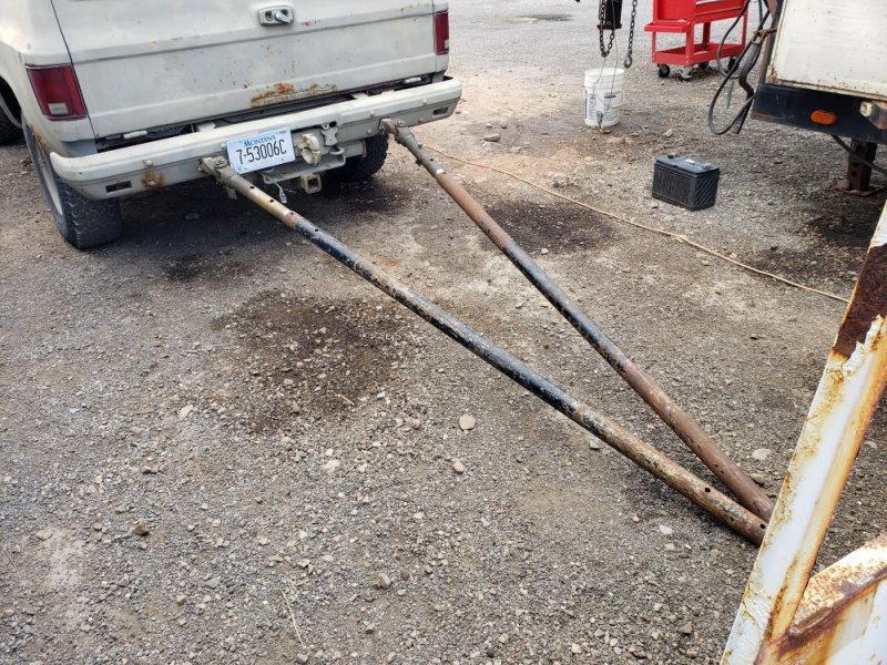

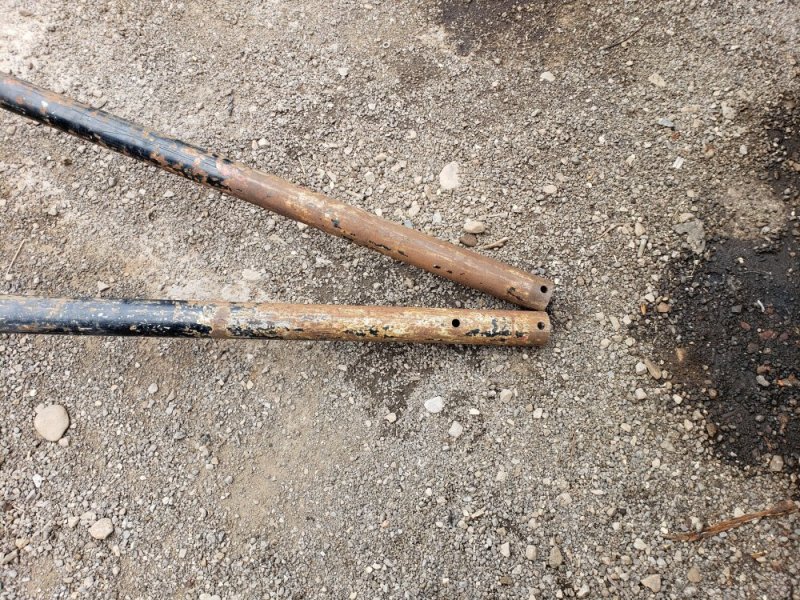

With that operational went to the gin pole legs. Using the towbar feet and lower legs from a military surplus medium duty towbar because they attach to the recovery points on the truck already. For the upper legs there are 2 sets. Shorter set is about 6ft long and are the axles from the dolly on the wrecker. Need to design a top piece for them.

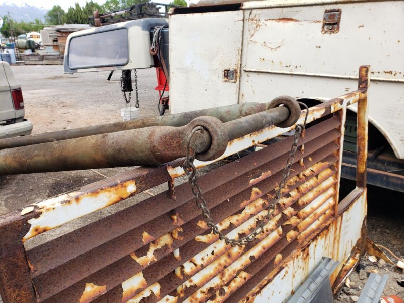

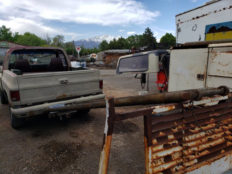

Longer set (about 10ft long) are the inner legs from the old m816 military wrecker I had. Way overkill in strength for what the k5 could lift but the extra reach can be good when needed.
The top spin will get 2 holes drilled and bolts put through those which will tie the legs closer together making it nice and stable. Support chains and a snatch block will also attach to the top pin.

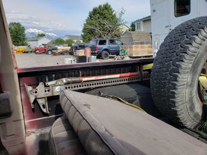

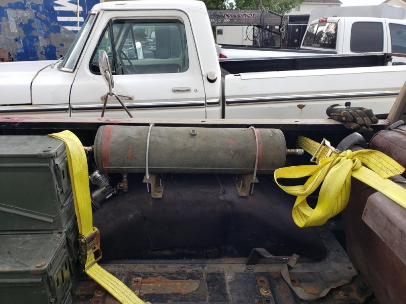

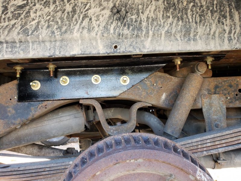

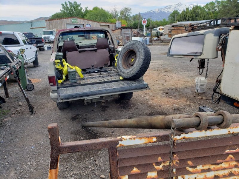

Now, where to attach the support chains, and a place to mount the winch so it can be used for lifting as well as raise/lower the gin poles. Well the support chains need to be in the bed, and placing the winch there will make it the most versatile as well. The E track is just secured to the body and would be ripped out trying that. Same problem with the seat anchors so ...................

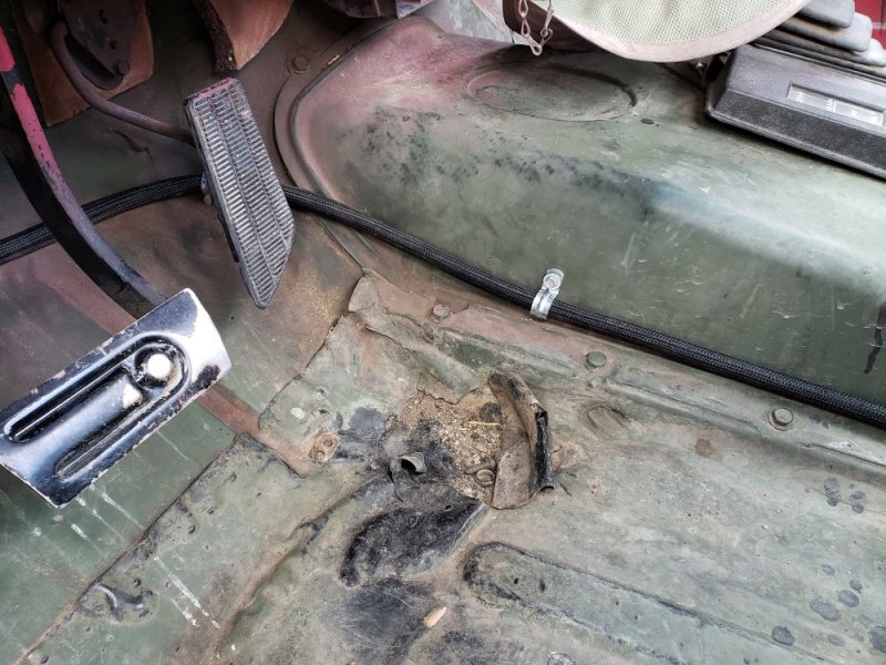

The rail does fit under the seat. Using either a flat plate or the lighter model gooseneck hitch plate can easily attach a piece of tubing for the winch mount, and some shackles to hold the support chains.
