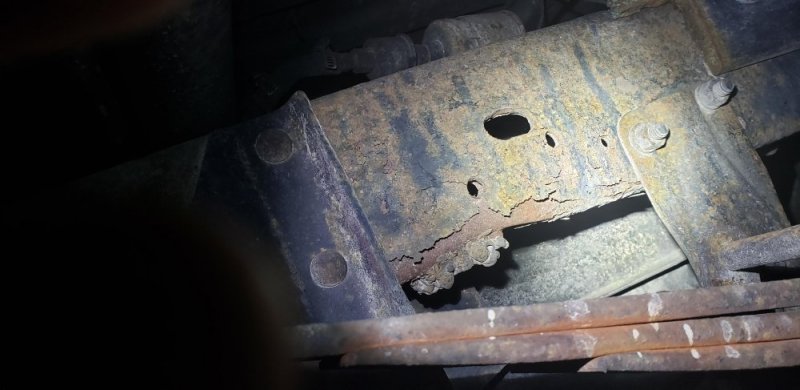

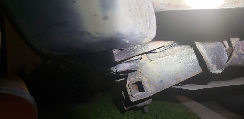

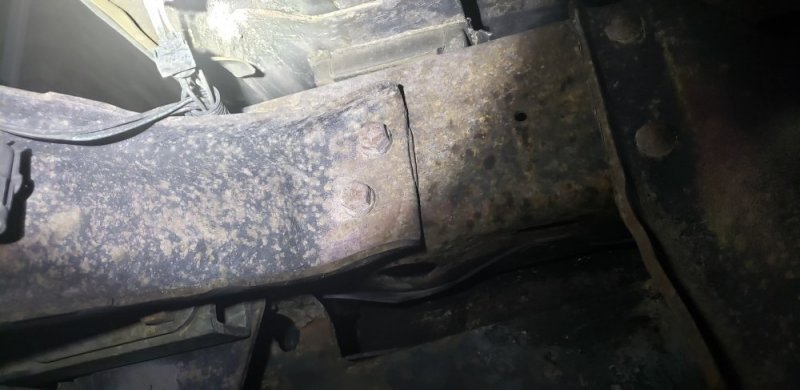

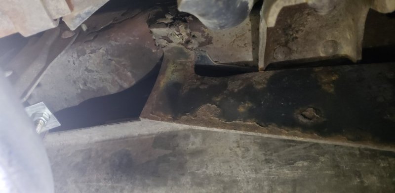

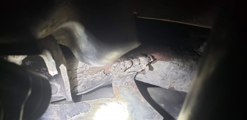

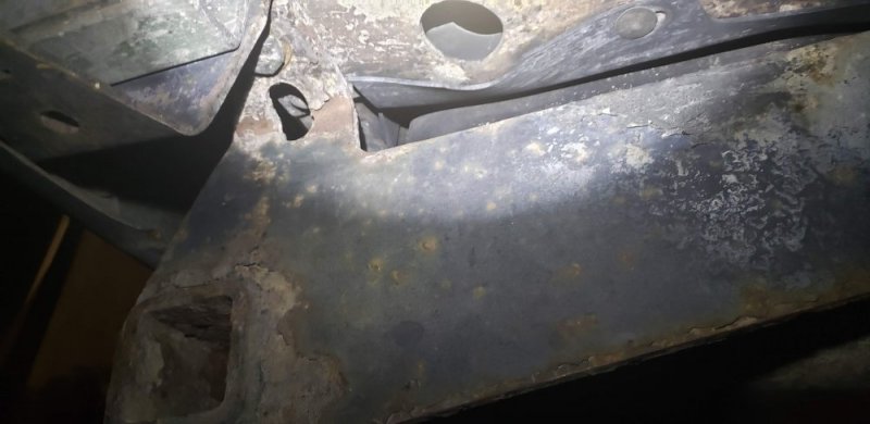

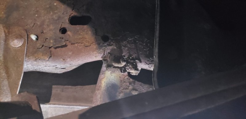

Looking like it's probably totaled. Hitch took the direct hit (accident happened at the top of a hill) and bent the frame. Gotta wait for insurance to do their thing but I'll be amazed if they don't total it out.

How bad is the frame? I get it’s totaled and not safe if someone gets rear ended in it again. But is it driveable or is it dangerous in the rear suspension area?

K5 new issues:
Frame is bent from where the front mount of the receiver hitch attaches, so a few inches in front of the shackle hangers for the rear springs.
Radiator leaks coolant and there's a external leak from it's trans cooler fitting area as well.
Slight wandering on the road. Used to be could let go of the steering wheel and it would stay straight. Now it needs correction from time to time.
Alternator died.
Rear bumper and the pintle hitch are no longer attached to each other.
New rattling noises and vibration at higher speeds from the back of the vehicle.
Very healthy 6.2/th400, one of the smoothest running 6.2/6.5's I've been around. The wandering isn't extreme (drove it about 70 miles on thursday) but is noticeable. Vibration is most likely the ujoint at the rear axle since the frame bend has rolled the pinion up some, and I bet that's the cause of the wandering as well.
Buying it back, options are to either part it out or make it the dedicated offroad toy. Parting it out would make a little bit more than buyback price. Dedicated offroad toy has the benefits of absolutely zero concern regarding body damage when rock crawling. But the crew cab handles the local trails easily enough and is capable of rock crawling, only the front fenders/cab area have the potential to get damaged.
