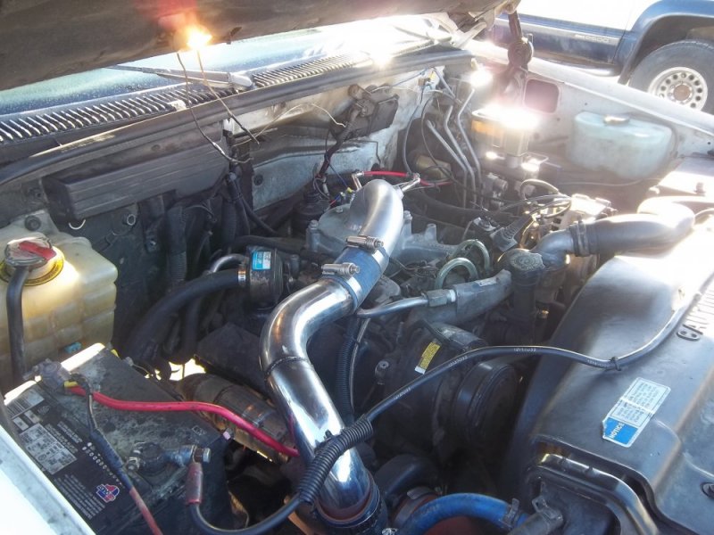

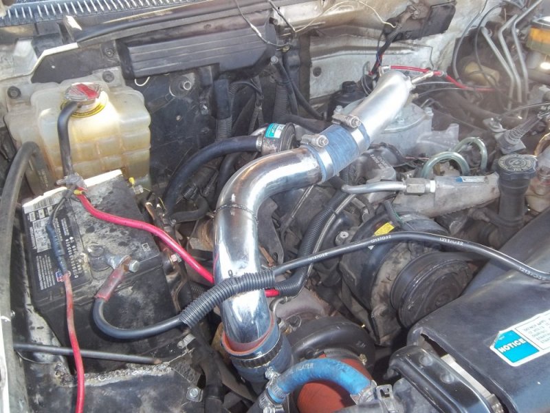

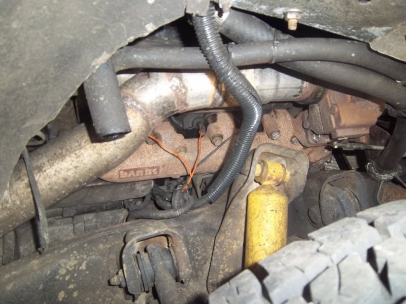

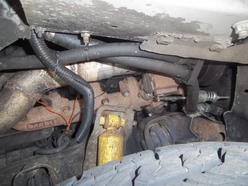

RESULTS: Ok, some first impression results. It definitely hits harder. Sort of feels like when I used to drive with my WMI on, but it's not on. Holds in a lot more heat for the turbo system. Before, when I pushed the clutch in, boost dumped to zero instantly. I'd be hard pressed to downshift to 3200rpm and see 1psi. Now, downshifting to 2200rpm I will see a pound or two. And when I'm cruising and let off the throttle, boost drops slower down to about 3 psi then very slowly comes down from there. Oh, and also, EGT's are down about 125*F. I haven't driven it much. So this is just in the maybe 30min I've driven in. But will keep updating the more I drive it and collect data
So been driving it a bit more, and wow. The low end torque is much more impressive. I don't have to drive it like a 2 stroke anymore. Lugging is a thing of the past. 4th gear, 1000rpm, and she will pull herself right out of it no problem. The rpm/power drop from 3rd-4th is no longer a problem. I wish every 6.5L had come this way from the factory

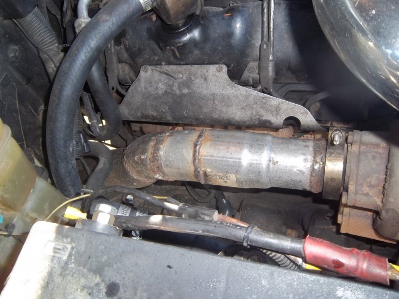

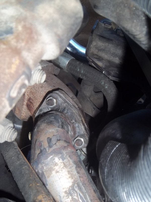

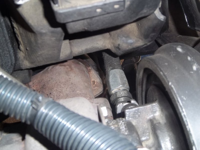

It is. One major thing I noticed is that everything on the rear is now MUCH easier to get to. The starter can be accessed easier, the oil cooler lines and fittings are a 2 minute job now, oil filter can be taken off easier, just stuff like that. I am loving it for that part too!!!. And the crossover pipe up front takes about 5 minutes to take off, and can easily be removed for access to anything up front should the need arise.
Injectors on Pass side are readily accessible too!
You did a great job here. Love hearing your results! You're making me wish I had done a variant of this for my header project though one of my goals was to not disturb my earlier work. I like that you have improved serviceability of components while improving performance. Fantastic project, thanks for sharing!
Thanks. I've been spending the few days of free time I have cleaning everything up under the hood and re-routing wires and everything. It's been a CHORE to say the least doing this project, but the bottom end torque gains are so substantial that I wish I had it in my ability to make these into a kit and sell. Hands down, it is THE best mod I have done to my truck probably. I am really excited to see the results of your project!!! Yours is a LOT cleaner too lol Mucho jealous

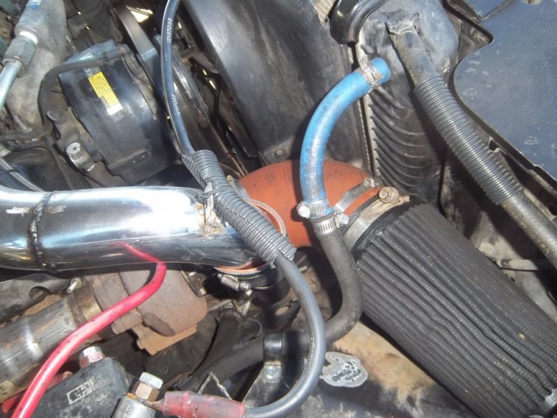

I run the ATT on mine. It does require an elbow set up to mount it if you don't want to cut up the inner fender.
