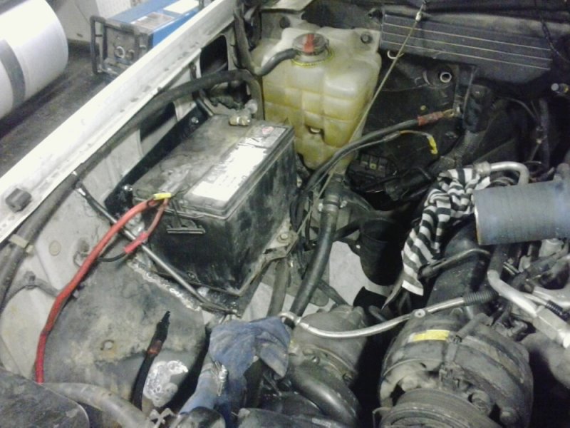

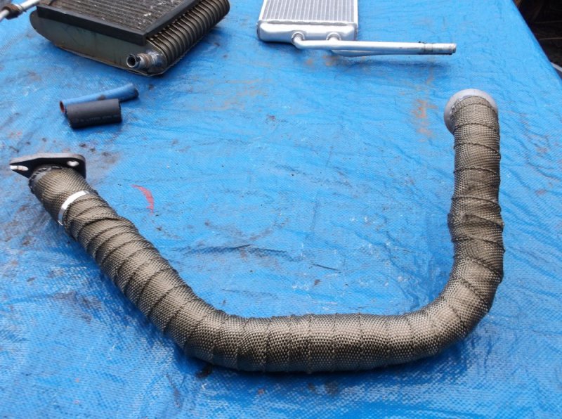

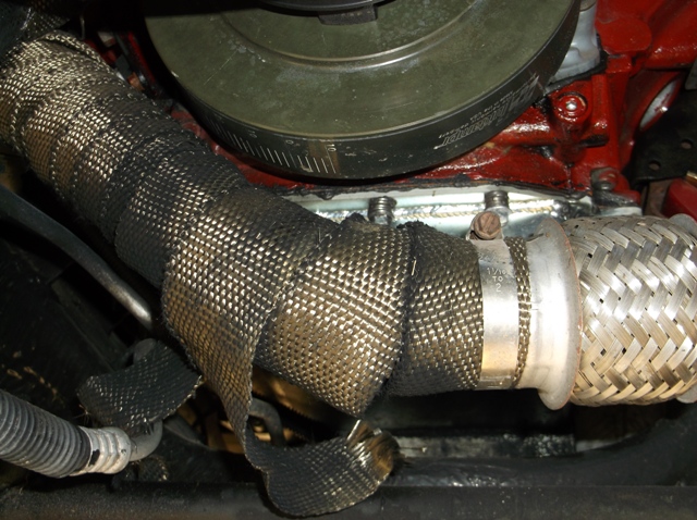

160107_001.jpg UPDATE: So I didn't get too much done today. I was going to put the battery where the air filter box goes but the towers on top the battery I think would have hit the hood. Even if not, just too close for me. So I made a drop down box for the battery. Used some round stock, a torch, an anvil, and a hammer to make some battery tray braces down both sides. It ain't going anywhere. Is extremely in place. Turbine and downpipe will be wrapped. I got a lot of wrap left from when I did the crossover pipe.

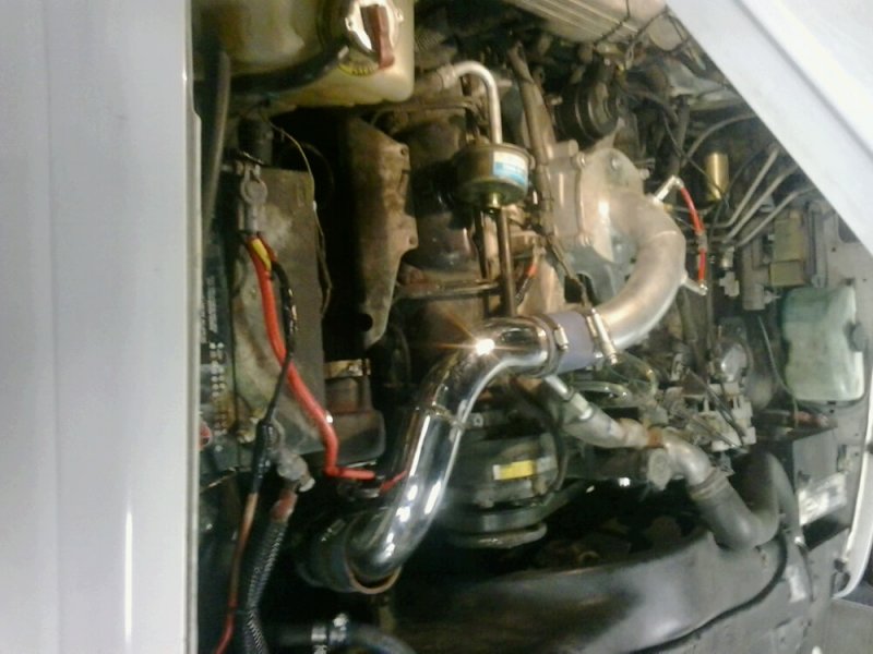

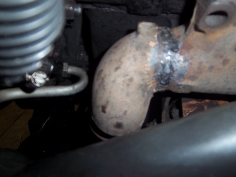

UPDATE: So now pictures on this ones, but did some drastic changes to the system. I did not like the pinched down part of the pipe, or where it joined up on the v-band side of the crossover pipe. So...I noticed the sharp 90* elbow that is formed into the drivers side up-pipe on a centermount system. I liked the tight turn. So I cut the v-band off the manifold and welded the 90* bend from the other up-pipe into it. It looks like it should have been there from the factory. I will get pics up as soon as possible so you can better see what I am talking about. Then I am going to weld in a bellow to the crossover pipe as well. I just could not let it go and be satisfied with it. I have to make it better. I think you guys are REALLY going to love this new design!!!! Will keep updated ASAP

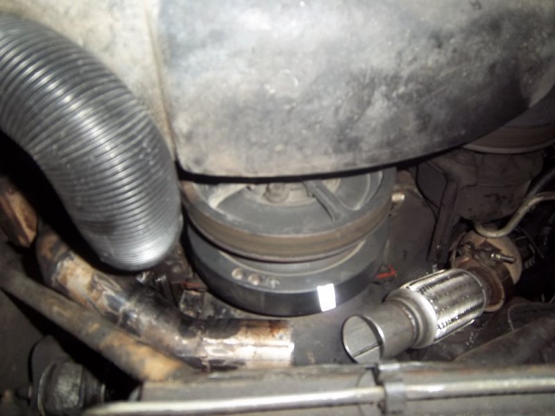

I took some pics but forgot the camera at the shop. Will have to grab it tomorrow (if I remember). But I got the downpipe done today. Full 3 inch from the turbo back. Just got some minor oil drain leaks to finish up and it's done
Actually I went to grab my hat from the truck and found I had put my camera in there at some point. Great success! Pics to follow
