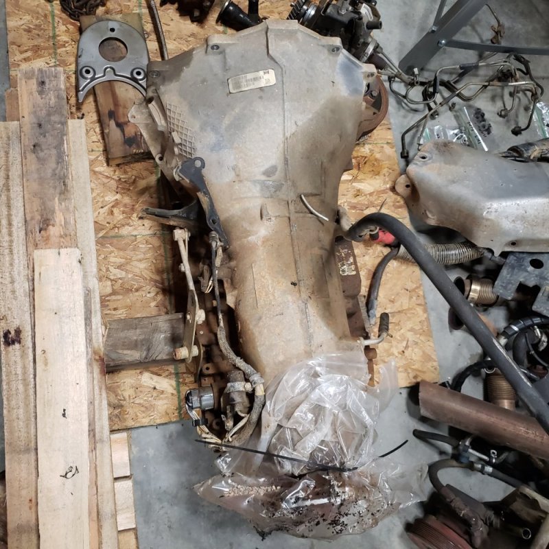

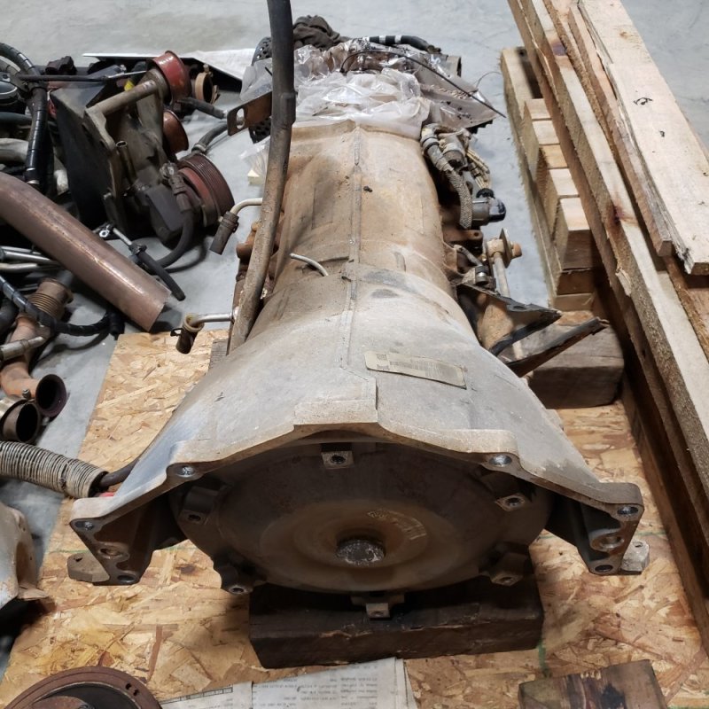

@SnowDrift do you know what year this trans came from? I remember Ferm saying something about the 94 and eariler having a valve inside designed to back flush something where the newer ones changed. I can't remember exactly how he described it, but there was something that could be changed in them to make them work (newer to older and vice versa) Maybe @THEFERMANATOR can tell us more and refresh my memory . Tell us what can and cant work for Chris's truck.

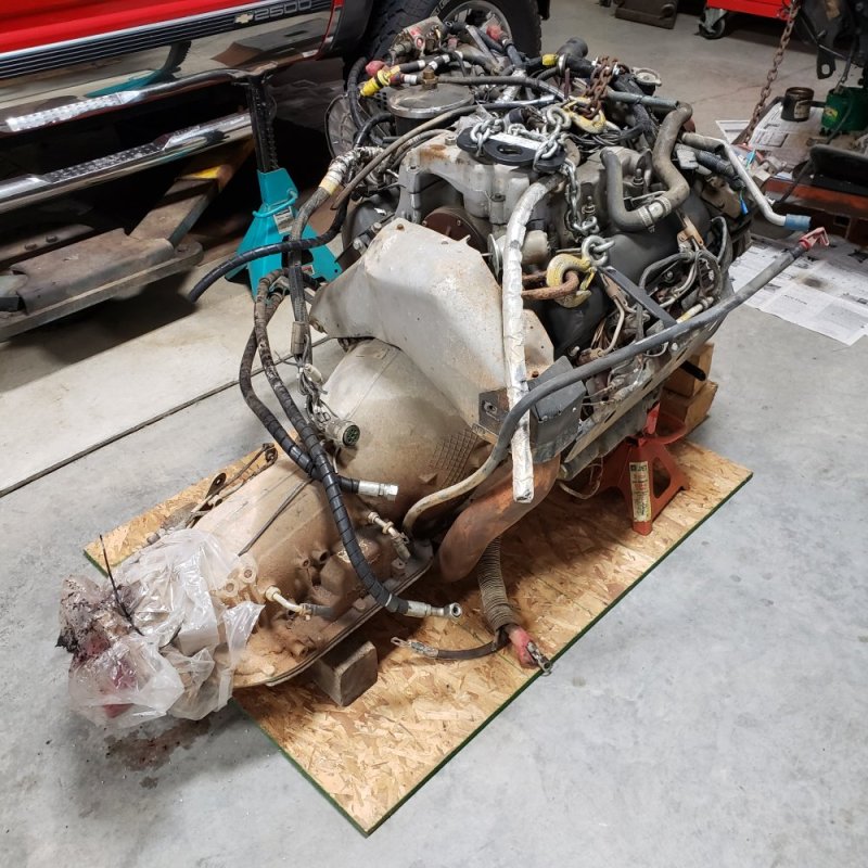

2004 HMMWV. 2011 block
I would think if that HMMVW engine had a DB2 on it with that trans, the trans should work just fine in Chris's truck. it shouldn't be any different.
