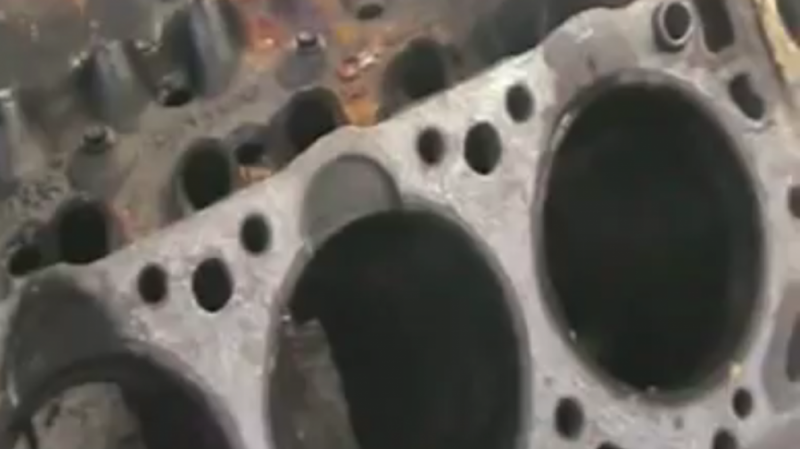

Here is a pic of a 6.9 idi that played the ether game.
Notice the cylinder to the right does not have the caved in area on the block from the precup blowing into it. That is how it is supposed to be. That cylinder didnt fire yet. This shows you it is compression activated, not just glowplugs igniting the ether.
Of course the head and precups were destroyed. The glowplugs were inactive.
