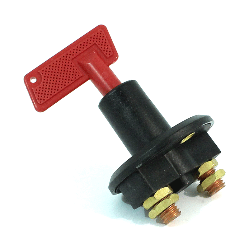

New info. This exact style switch was on the truck the first time I messed with it. (I know its just a master disconnect....) Went from ground on starter to I don't know where else. I put 2 fresh batteries in it that night and found this switch. When I turned that red key it started cranking on its own. The keys were in my hand. I figured cylinoid at first and still am but my problem is there is a 12 gauge wire that goes from hot post on cylinoid to hot post on battery. Makes no sense. I can't figure this wiring out. In the video of me trying to crank at the end the horn honks. I didn't hit the button on the steering wheel. Serious wiring issues or something simple that Im overlooking? Took sandpaper to both grounds for both batteries. I can add any pictures that might help yall
So the 12 gauge wire is in parallel with the 4 gauge wire? If it's hooked to the small terminal it would cause it to crank all the time but if it's hooked to the same terminal as the big 4 gauge wire it wouldn't do anything.

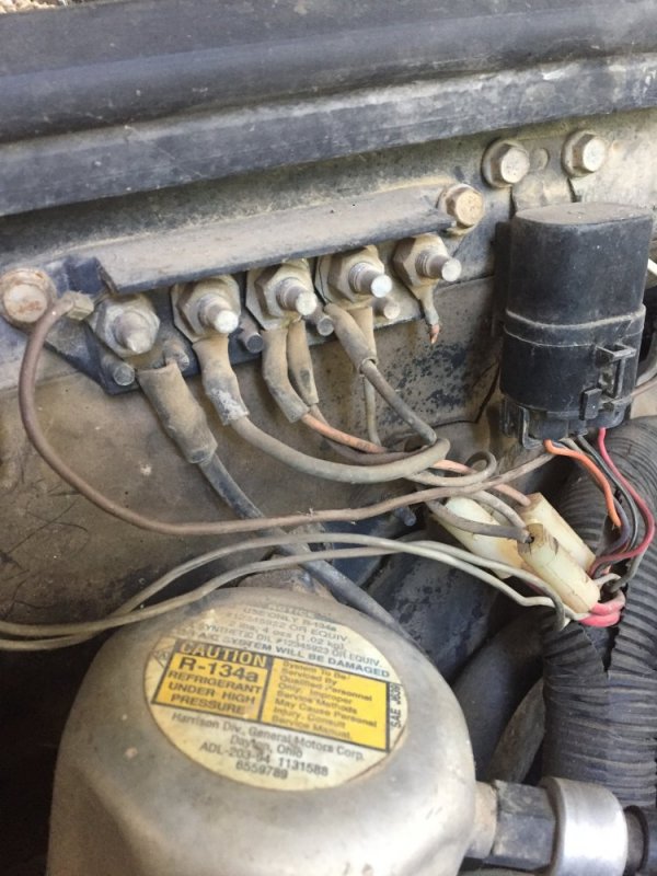

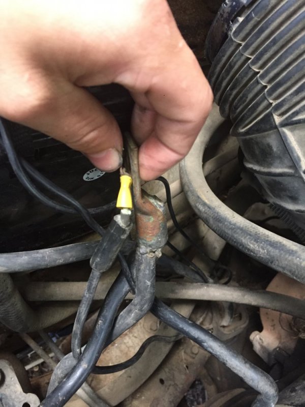

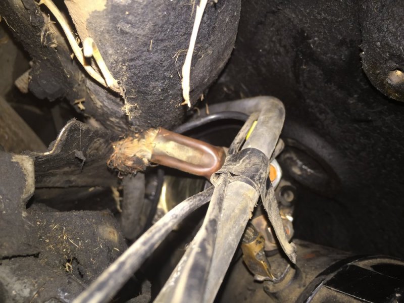

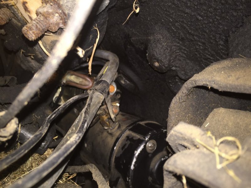

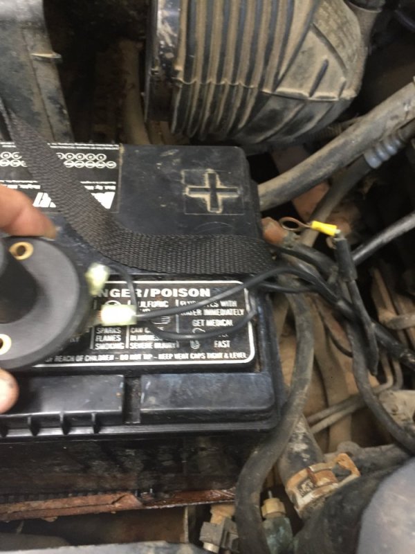

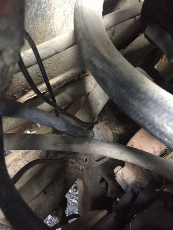

AD7E2986-3D9C-4884-AFC8-F645EA95544A.jpeg3965C97D-CBA1-444C-A1E7-79AD5CC77CD9.jpeg2FB41986-C3E8-4CC2-91B4-791B3AA5F2D9.jpegB6BD3D4C-F836-4AF2-A481-0DC62CC025B8.jpeg1DBB2B11-C2CD-475D-AB1F-32FE91EFF937.jpeg

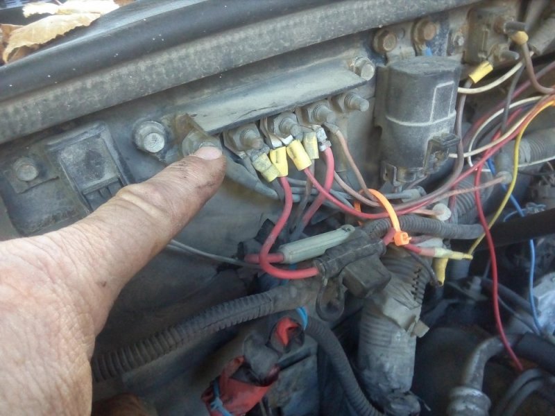

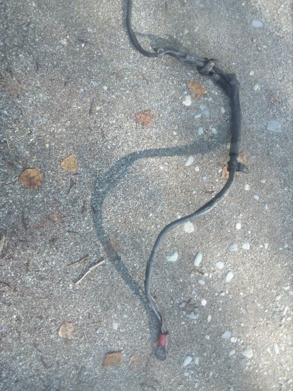

The wire I had with the battery cable by the battery actually goes to S on the cylinoid. Where does it need to be hooked to. What about the one that is with battery cable on starter?
If someone has one or can draw me a simple diagram of how many wires I need and how i need to run them off the starter that would be awesome as of right now the starter has the small wire off small post of cylinoid and the battery cable and then one more of same post as battery cable
On unaltered wiring it goes directly to that wiring block without going to the starter. I believe that larger piece on there is a fusible link
Don't have a diagram but I believe that wire supplies power to that block.
One of those wires that was on that master has power constant but that block can’t get power with out a wire on it or a different wire touching the battery. I’m beyond confused I’m headed to look at A parts truck maybe I can get something figured out if not I’ll let y’all know where I’m at
