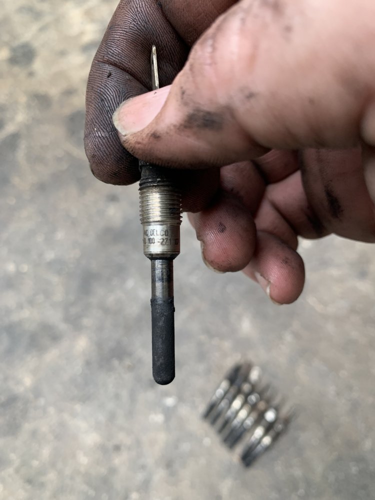

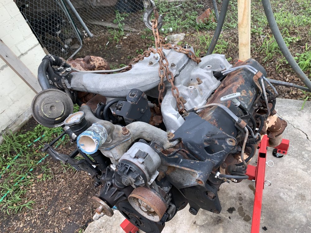

to start off with, I received a call from a buddy at work who had told me the shop who I had install the new ring and pinion set in my truck had a diesel engine he pulled from a 94 K3500 pickup. the owner of the pickup was converting it to a gasser. I ran by the shop and low and behold there was a complete engine that he said ran fine but just leaked oil badly and had some type of issue with the IP. He sold the whole enchilada to me for $100.
Oh and I have to give credit and a shout out to Jerry and Casey from Rodgers Racing who installed the gears and thought of me when this engine came available. Here is a link to his FB page. Don't know why it shows up in spanish lol

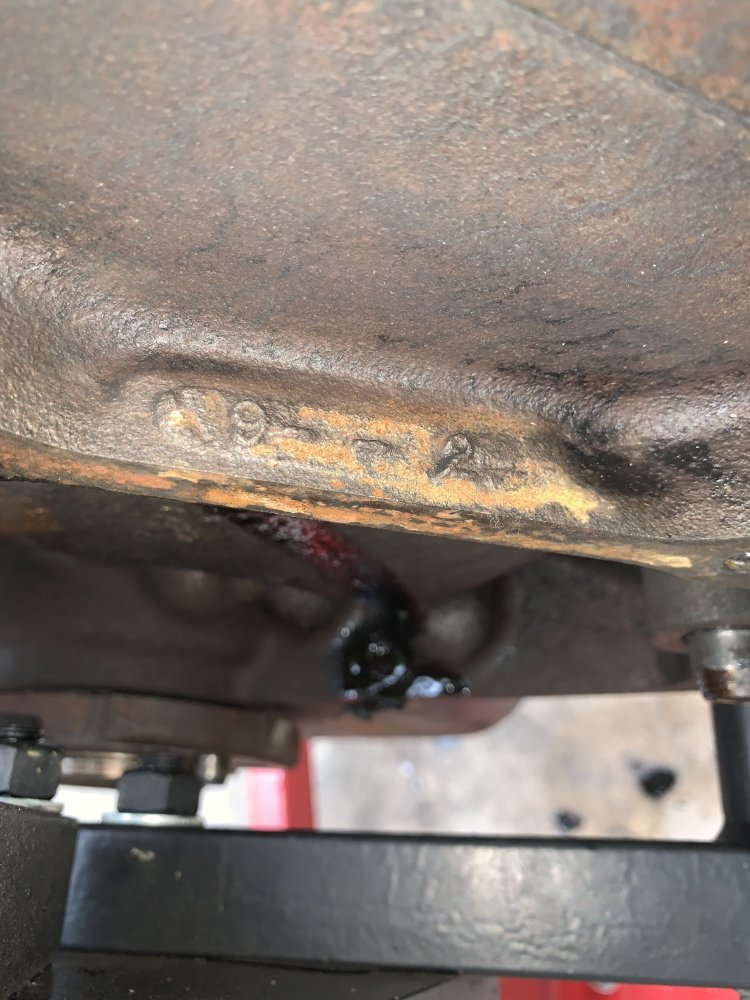

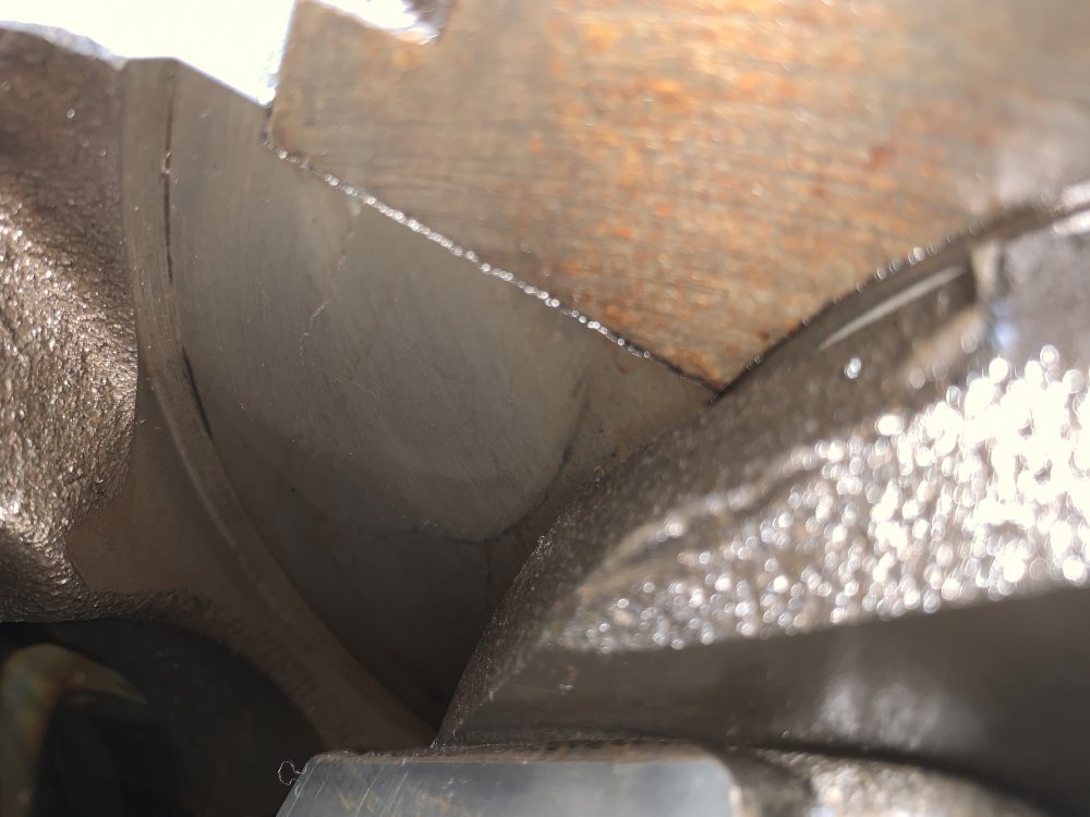

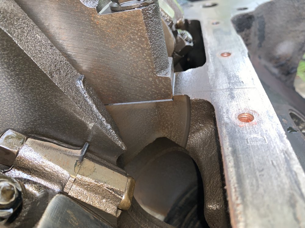

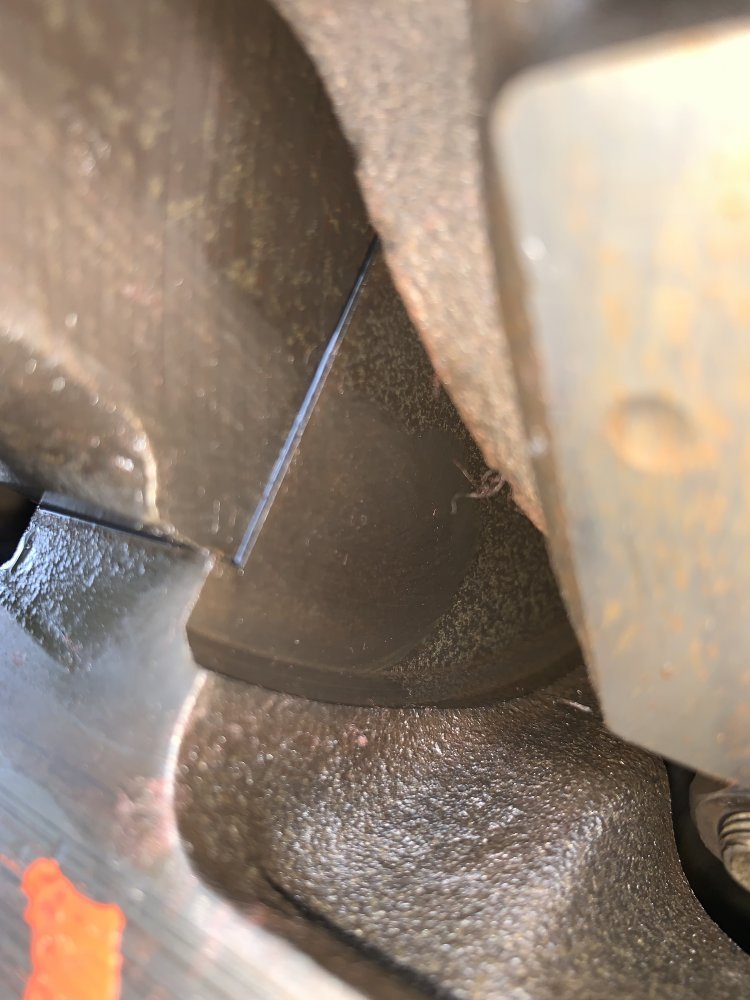

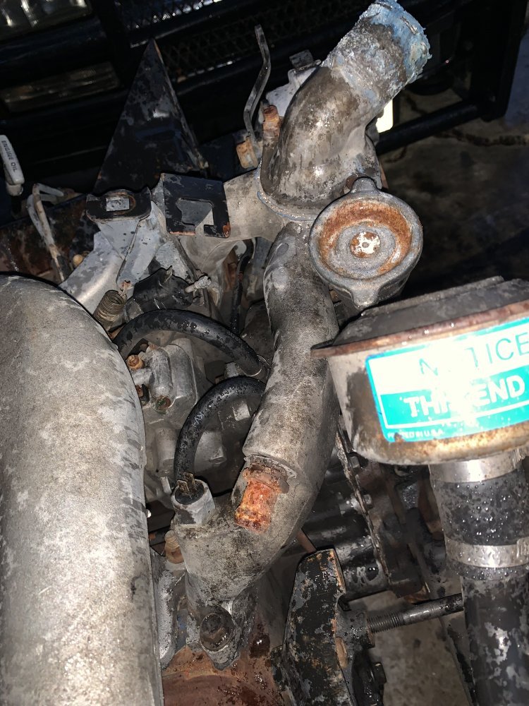

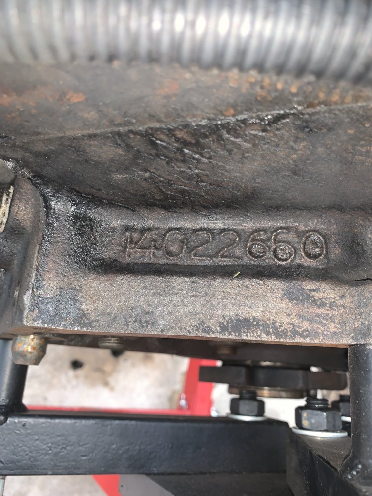

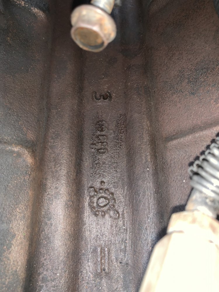

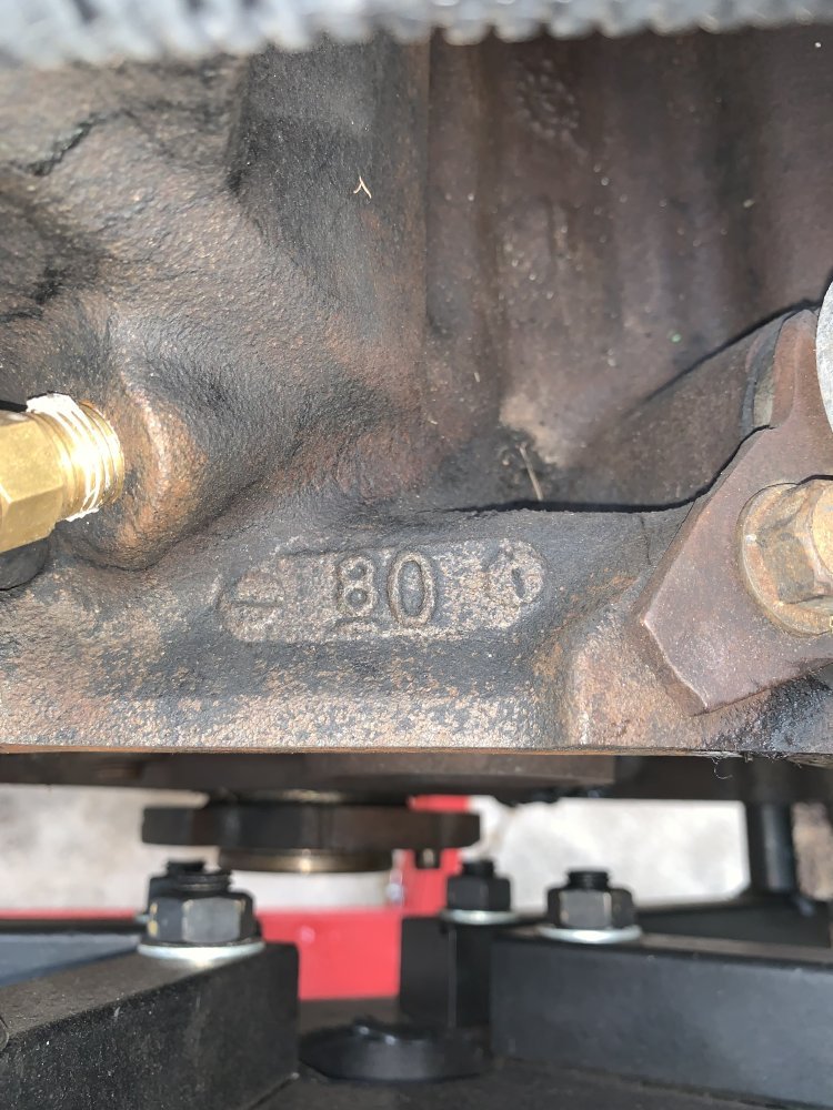

Now to dig into the details of the newly acquired engine. at first glance I had thought it was a 6.5L since it had came from a 94 truck, also noted that it has the DB2 IP and a factory GM-3 turbo. I cleaned up the areas on the block so I could see the casting numbers and learn some details on the engine.

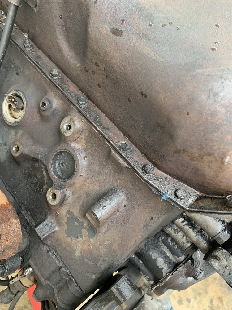

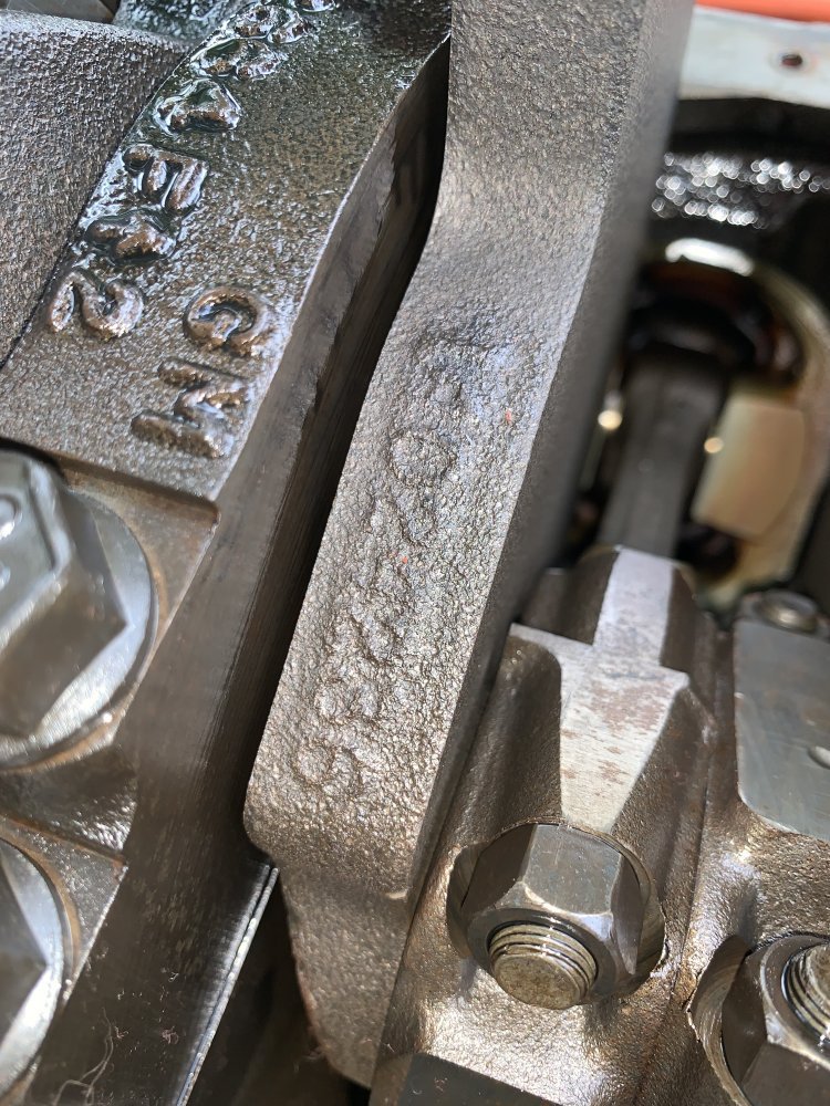

Block casting number is 14022660 and stamped on the front of the block reads GM 6.2L.

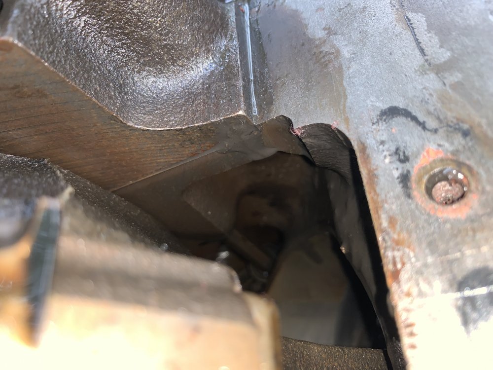

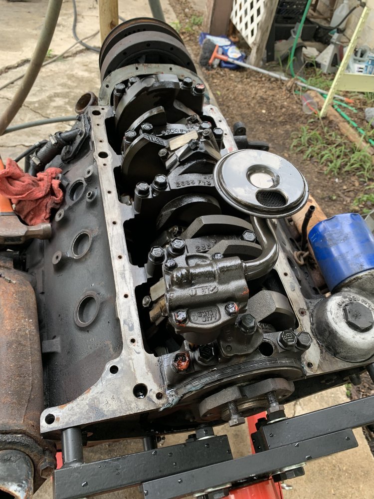

so learning that this is a 6.2L with a turbo tells me this wasn't the factory engine in the truck they pulled it from. There are some other casting numbers and symbols that I took pics of hoping to try and identify what year the block is and learn more details about it. Hoping this is a good one to work with.

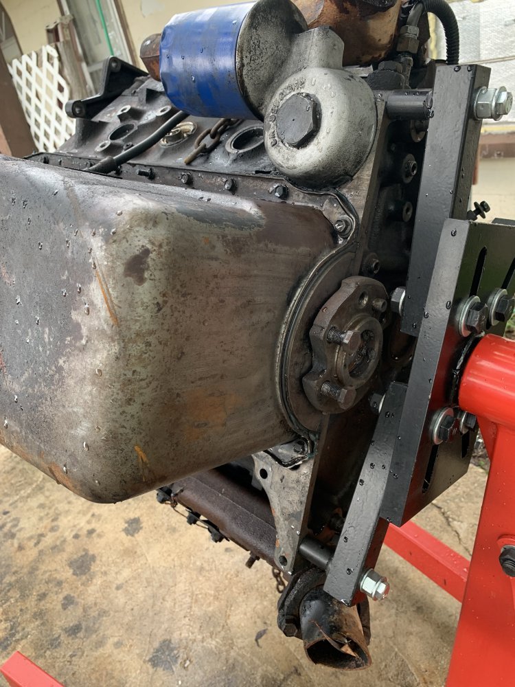

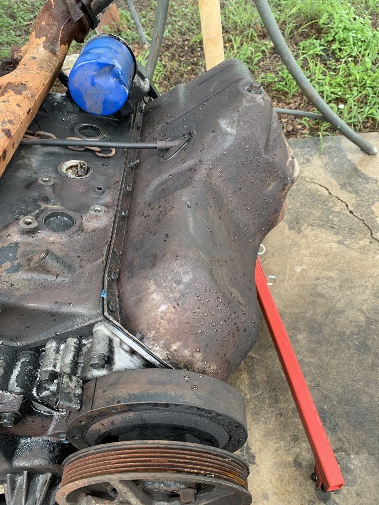

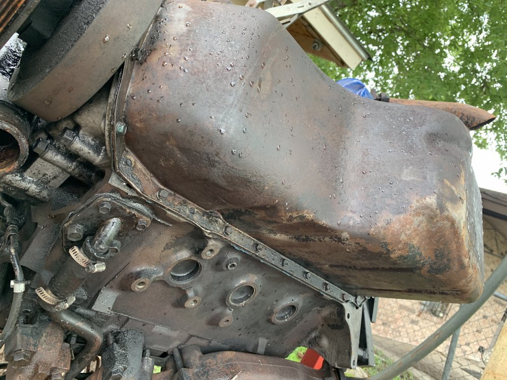

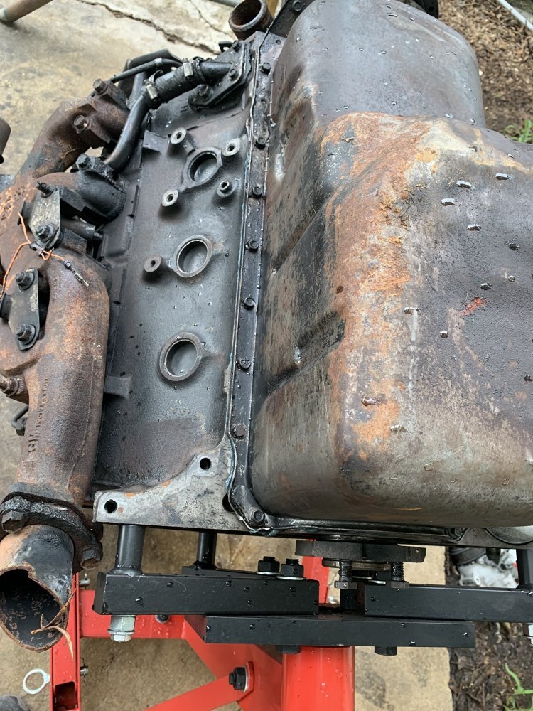

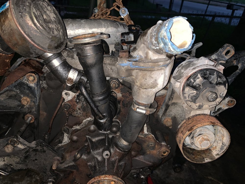

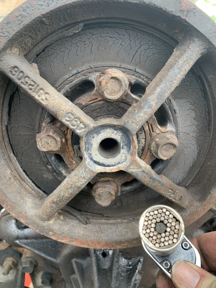

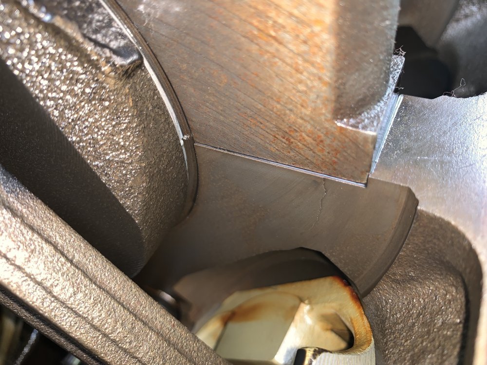

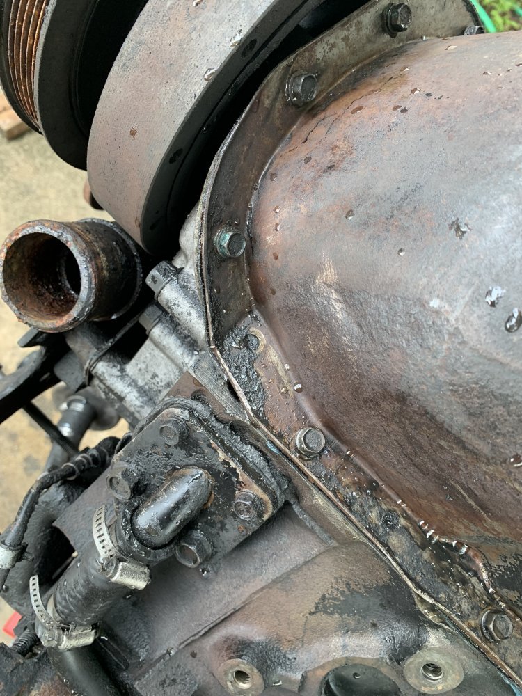

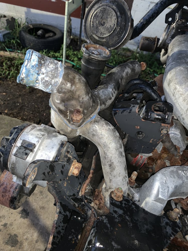

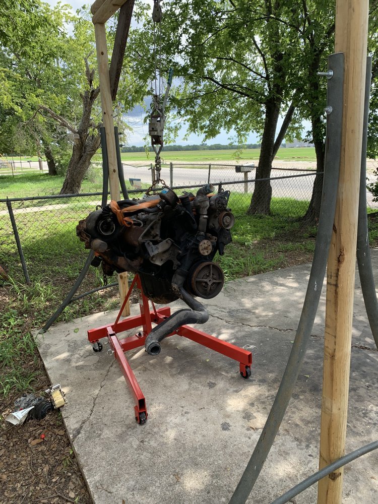

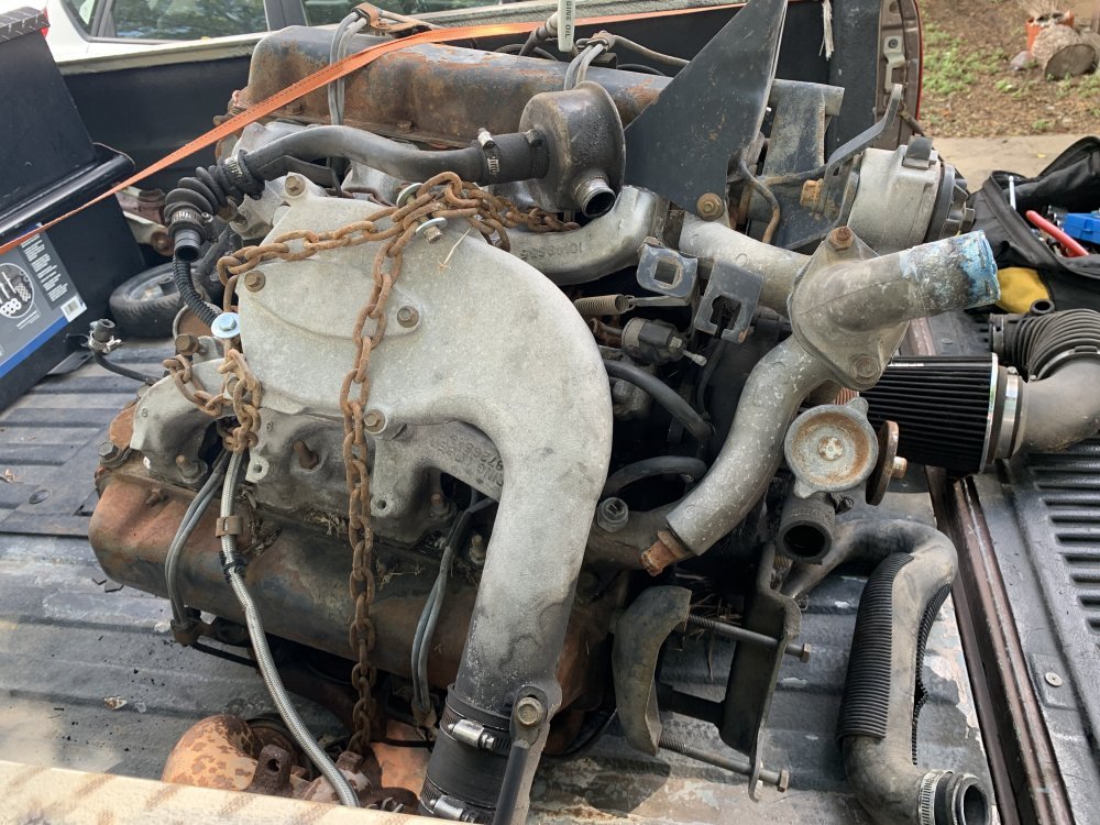

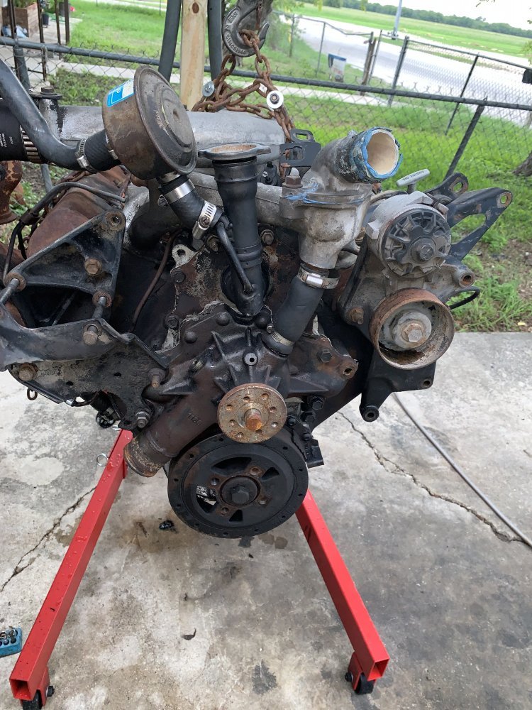

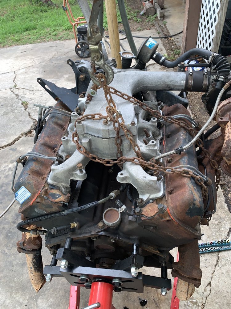

below are some pics of the engine as it was when I got it and after using the power washer on it cleaning it up some on the stand.
