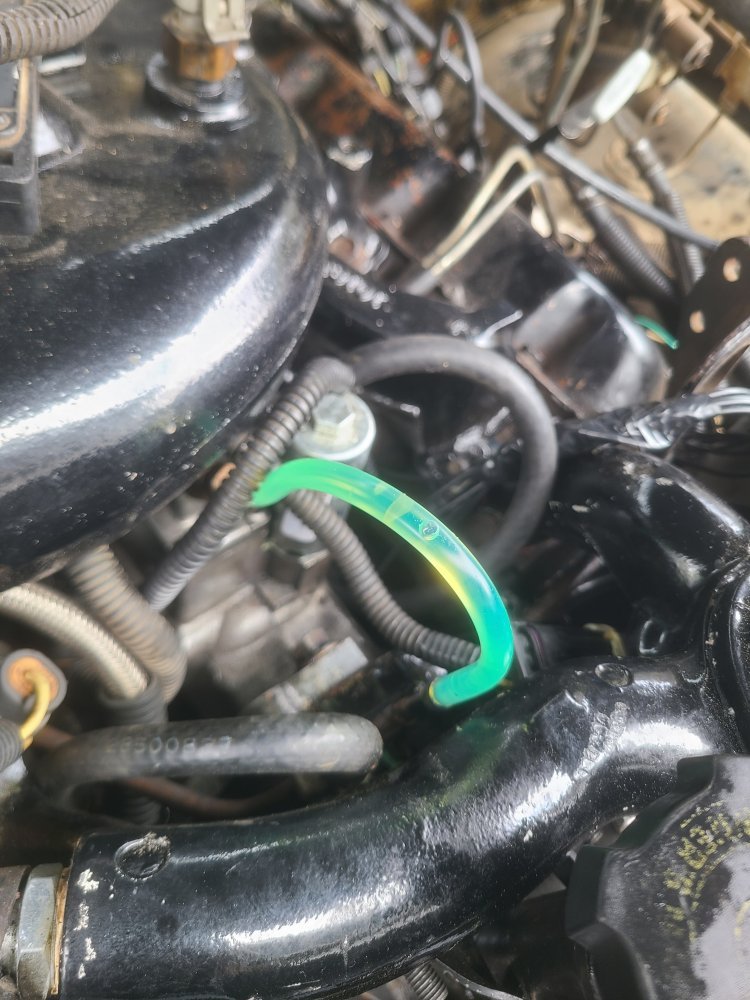

Ok- the tiny bubble like that is fine and expected. You can leave the clear line on and In maybe 5 years it could need replacing. Anytime something acts silly- just glance at the line to see bubbles or contamination.
