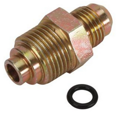

like this adapter commonly used on power steering systems? it takes the metric port and converts it to standard JIC. I have a set of them in my tool box when I was doing some testing on my P/S system
can you tell what size the ID is on the tubing they used for the hose made? I bet it's 3/8" tube or thereabouts.
18mmx1.5 to an-6 JIC
