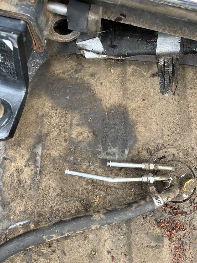

If you're interested in bypassing the stock FSU, I installed this draw straw kit on my truck. Have yet to use it as the IP died shortly thereafter and truck has been parallel parked ever since, but I was personally excited to get away from the stock setup
I drilled a hole for the rubber grommet behind the tank FSU and made my own 1/2" fuel line using NPT and -AN fittings instead of the supplied quick connect ones as I just don't trust them.
Bonus of this setup is you can use the original feed line as another return port if you ever install a fuel pressure regulator that needs a return line
I know you're not in salt country but I can't stand how the factory fittings always freeze up on the steel lines and how it's a stupid uncommon fitting. I know Leroy sells fittings to adapt to barbs but at the end of the day you're still sucking fuel from the tank from a 3/8" fitting and then into a 1/2" line. How much of a restriction this creates leading to sucking in air elsewhere I don't know, but the draw straw kit linked above seemed like the easiest route in terms of fab skills (drill a hole, cut a plastic tube to length) and time (took a few minutes when I swapped tanks last fall)

Changed the feeder and return seals at the fuel sender unit. Took a bit to prime, but putting back about 10 gallons of fuel fixed that. Took it on a 4 mile drive and it is now running smooth. Will do some more test drives and if all is well, I will re-install the pre-filter.
