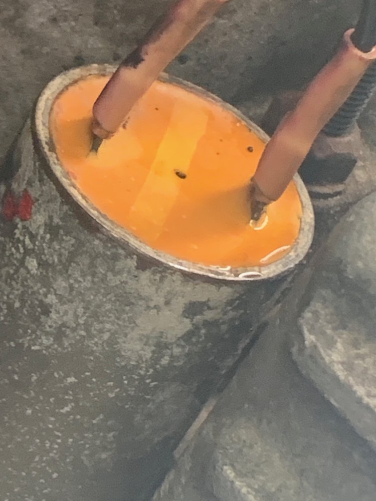

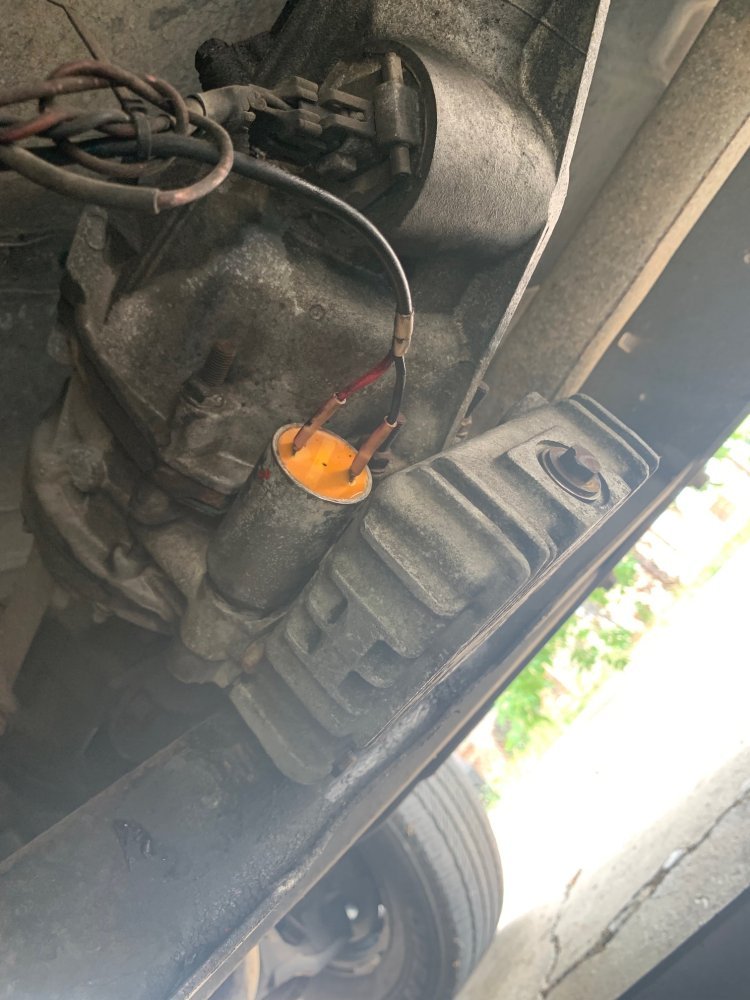

I wanted to post an update since I will be needing to get some parts for this GV unit. the truck has been sitting for the better part of a month. after I pulled it in to get the AC working, I noticed a small puddle of oil in the driveway. crawling down there revealed that the electric solenoid on the GV unit has a weep hole which gear oil is slowly dripping out even when not being driven.
I checked the oil level and it was low but not by much. I topped it off, cleaned off the wet areas with some brake cleaner when I immediately found the source of the leak. If you look closely at the center of the solenoid, there is a tiny hole. this is where gear oil is actively seeping out from. the little bit you can see in the pic flowed out within seconds of spraying with brake cleaner and wiping dry.
@Will, iirc you mentioned some of the hummer guys run these GV units. would you mind asking around if they have experienced this and possibly what needs to happen to stop the leak? I'm hoping it's simply a seal or o-ring that needs replacing on the shaft of the solenoid. but I also don't want to attempt removing this solenoid not knowing if the entire unit needs to be pulled or if it can be serviced while on the truck.

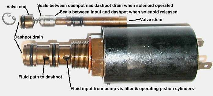

I did run across this post on the oil burners forum with a photo detailing the solenoid. it looks like I might be able to remove it and replace the seals maybe?
Yes you can replace the seals.

I sent an email out to Gearvendors asking about a seal kit for the solenoid. I also sent the two photos to them. I just received a response this afternoon saying that the solenoid is about to fail and would be in need of replacement. $260 plus shipping. Not sure if I should attempt to pull it and at least have a look at the condition of the seals, but I am tempted to try this weekend. if they are simply neoprene o-rings, I might attempt finding some replacements before ordering a new solenoid.

Well its time I need to address this leaking solenoid on the GV unit, the truck has been sitting for a while now. I have been doing some reading on the innerwebs and found out that these GV units seem to be basically the same as a J type layland OD unit for a Triumph. Not sure what year though.
I would like to find out what make a model Triumph they came with from factory, maybe I can find a less expensive solenoid replacement. for now I plan to do the thing I'm not supposed to do.... plug that hole up on the end with some RTV I also need to see if there is a case vent on it somewhere and make sure it's clear.
I drained what was left of the oil in it (wasn't much) so I can clean and dry that area prepping it for the RTV to have a chance to stick. I was going to attempt removing the solenoid and re-oring it, but I don't have a thin 1" wrench nor do I want to take the chance of finding out it's special size o-rings that I can't easily get. it's still functioning as it is now so I don't want to break it before I can get a replacement in hand.
