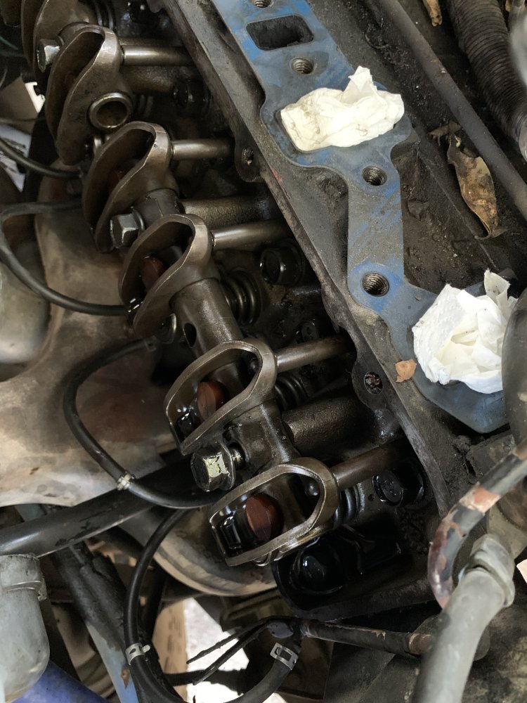

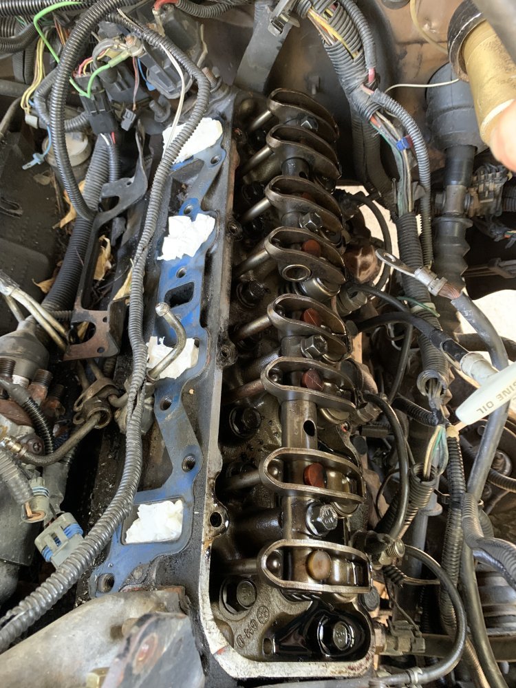

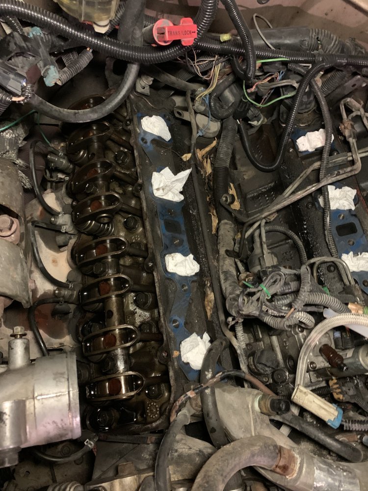

I went fourth tearing into the engine. So far I haven’t found anything yet. Got the passenger side valve cover off and all the buttons and rockers are intact. I still have the driver side to open but my suspicion is something deeper with all the blow by I saw earlier.
It was not easy getting in under the turbo to get the lines off. We’ll see tomorrow about the driver side and go from there.

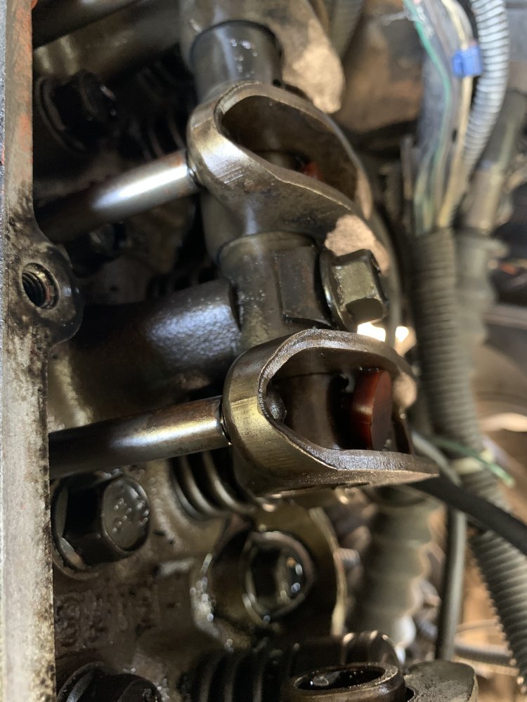

I unscrewed the bolt with my fingers and looked at the threads, there is no evidence on the bolt threads that it has pulled out of the head and the bolt was smooth when unscrewing it. looking online I found an attachment @Twisted Steel Performance posted on another thread that shows these bolts need to be at 40ftlbs if torque. the shaft is lifted ever so slightly but does not look cracked with out removing it.
I think I am going to torque it down and check the rest. unless others say I need to look at or do something else.

This the bolt for the rocker arm shaft?
Replace the buttons while you’re in there. They are cheap and it’s a quick job.

Just torqued down the passenger side. None were torqued I probably got a good 1/4 turn out of the other bolts before it clicked!
No one has the buttons called our local Chevy dealer and they could only get their hands on 8 of them for Monday and would have to get the rest in about a week unless I paid over night freight! I want to replace with new but I’m not sure if this is the whole problem. So I’m torquing them down and putting her back together without spending much money and see what happens. If she runs, great, if not I guess she’s gonna be parked. I think I need to turn my attention to the 6.2 on the stand and see if it’s a viable engine of not

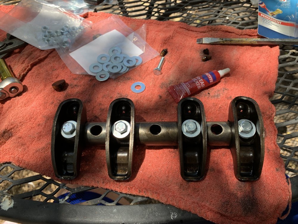

Amazon shows them but not with prime. Ended up getting about $30 in hardware from Home Depot. Couldn’t find any pinch style lock nuts so I grabbed some red thread locker too. Now it’s assembly time
Out with the plastic in with steel
Using 1/4” x 3/4” bolts, 1/4” flat washers, and 1/4” nuts. I figure grade 5 should be good enough since it was placing holding them in place. Had to do a triple stack of flat washers to make up the thickness of the button and the diameter is slightly larger than the button but the rockers still have play and move freely. Also using some red never come off juice on the bolts too. Gonna get them all done and button up the engine and see what happens.
