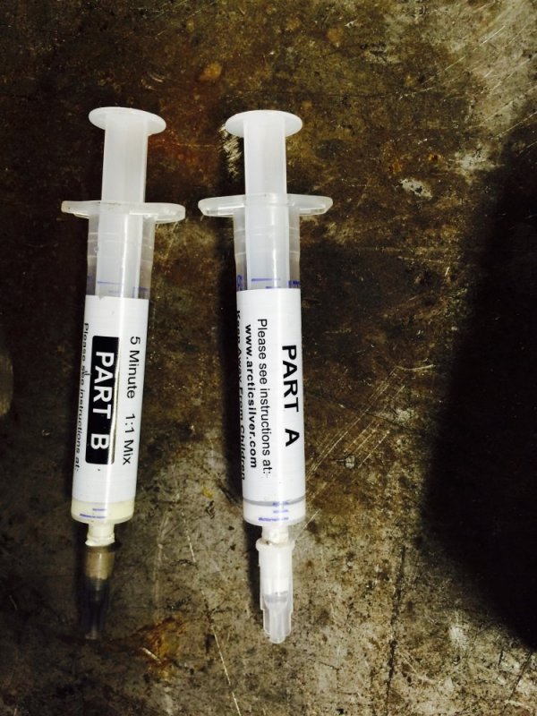

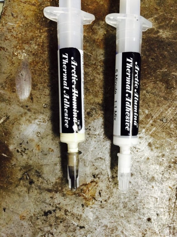

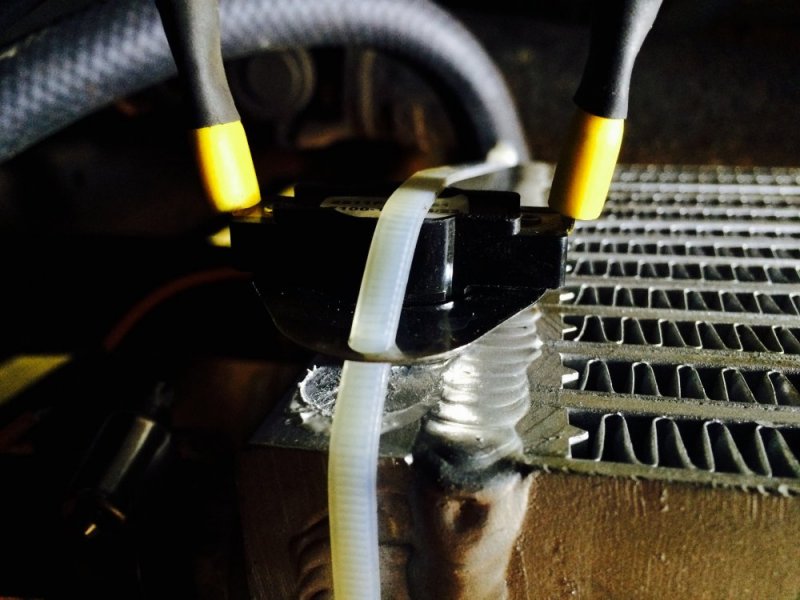

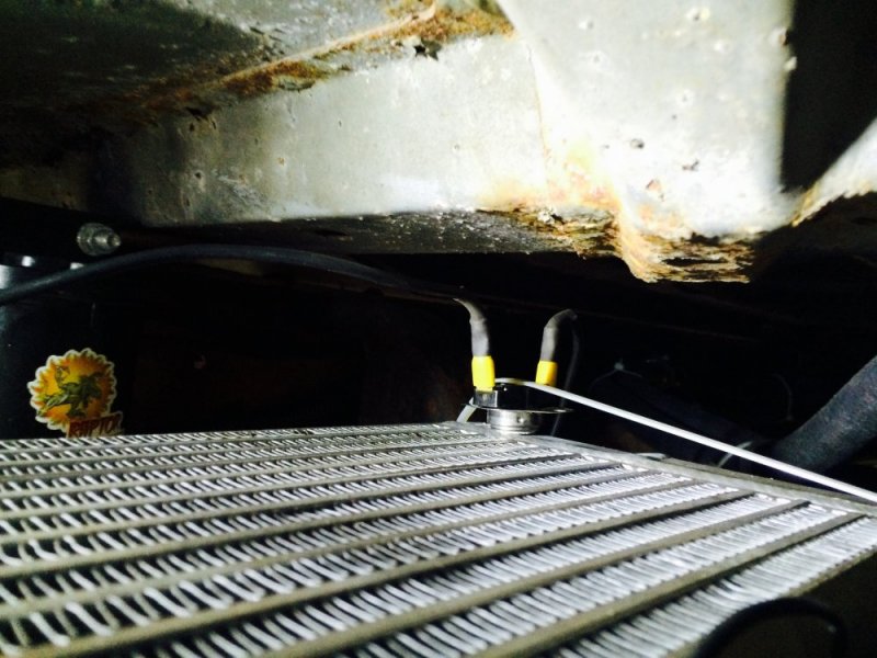

I finally got the temp switch for the fans installed tonight. I borrowed some left over heat conducting epoxy from work but found out that the Part B was pretty much dried out when I went to use it. After I scuffed the switch and the radiator with a sanding pad I mixed what I could and applied the switch. I decided I would also use zip ties for insurance and just that pressure broke the bond. It should be ok with just the zip ties but I may try to epoxy it again some day. I also made a jumper to carry with me in case I have troubles with this switch so I can just go back to a hard wired setup anytime. It is nice not having those fans howling as soon as you turn the switch on. image.jpgimage.jpgimage.jpgimage.jpgimage.jpg

Let us know how the fan switch works. How long it takes to come on daily driving and when it cuts off. Interesting stuff.
Will do. There is a 1/8" pipe thread port in the radiator that would be cool to thread a temperature gauge into, but I don't have any immediate plans to do so. Maybe if I get bored I'll do that :D

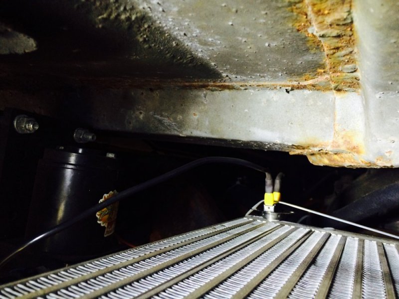

Wow, I just looked at last night's pictures on the computer for the first time. Look at the rust, ewww!! Damn salt.

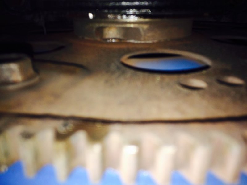

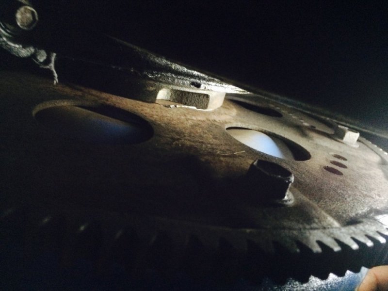

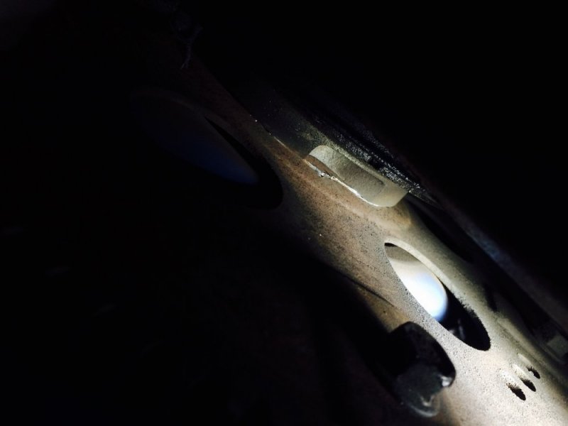

Good news, it's just the flexplate!! Took the inspection cover off and you can see it's sheared all the way around the crank hub. My brother is a mechanic and he had never heard one sound this bad. Unfortunately I can't find a heavy duty flexplate for a 6.5 so hopefully just getting a new one will last me a while. I'm gonna start yanking the engine today.
I'm not sure how nasty it sounds in this video but it is AWFUL in person. This is with the inspection cover off but it's just about as bad with the cover on.
