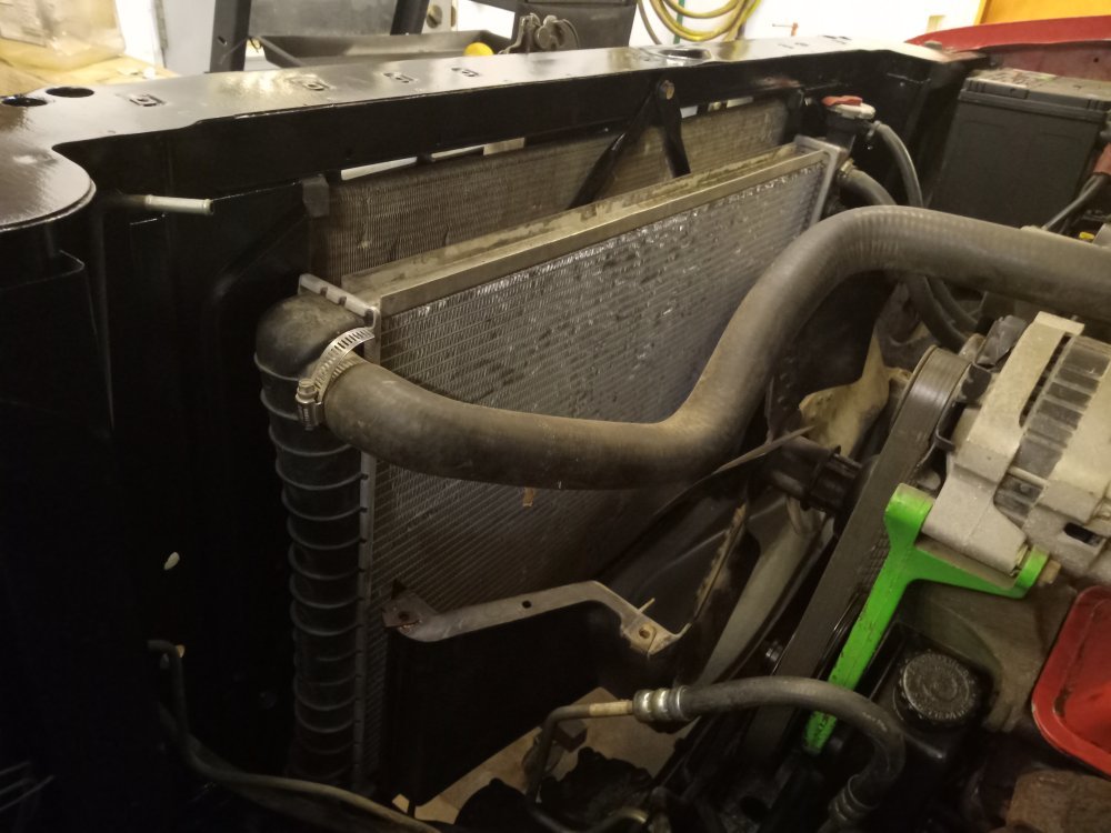

Core support is installed. Waiting to find a deal on some abs pipe to use in modifying the upper shroud half.

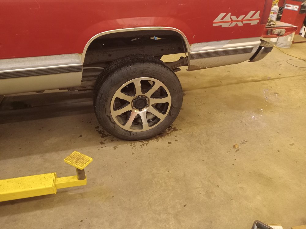

20231208_165934.jpg20231208_165721.jpgpicked up a 97 burb for parts today, supposedly has a new transmission. The engine is supposed to run and the part it needs is supposed to be inside. It also had these wheels and tires on it. 275/55/20 with pretty good tread, one tire has some waves on the sidewall but the others look good. Can get another on Amazon for about $203.

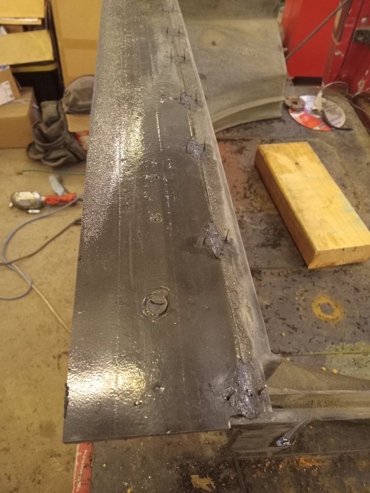

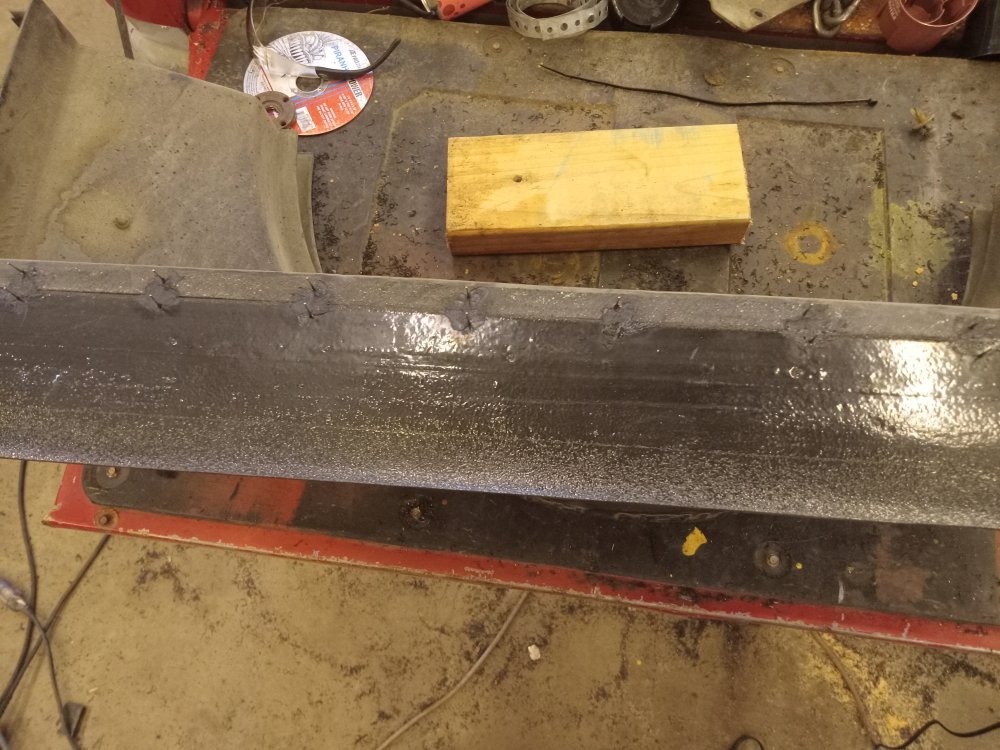

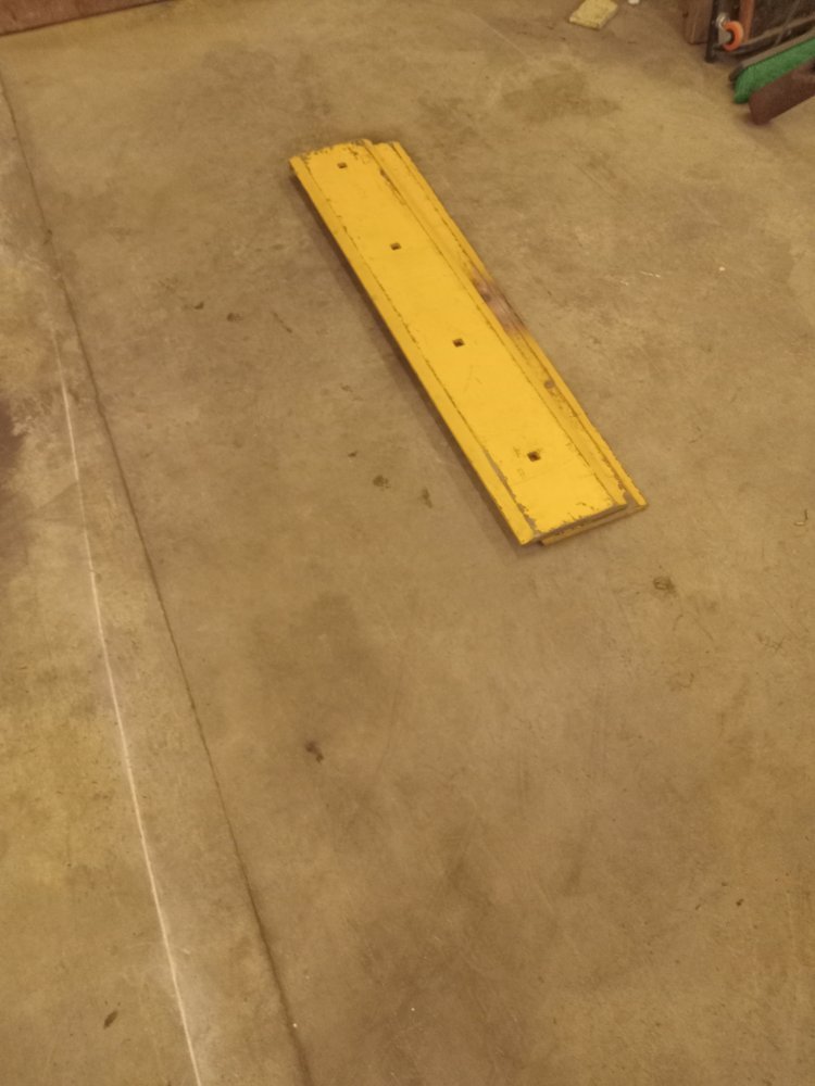

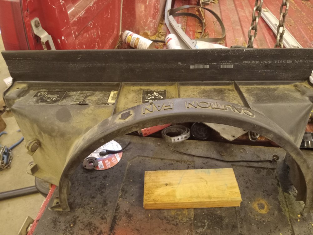

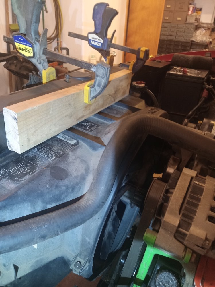

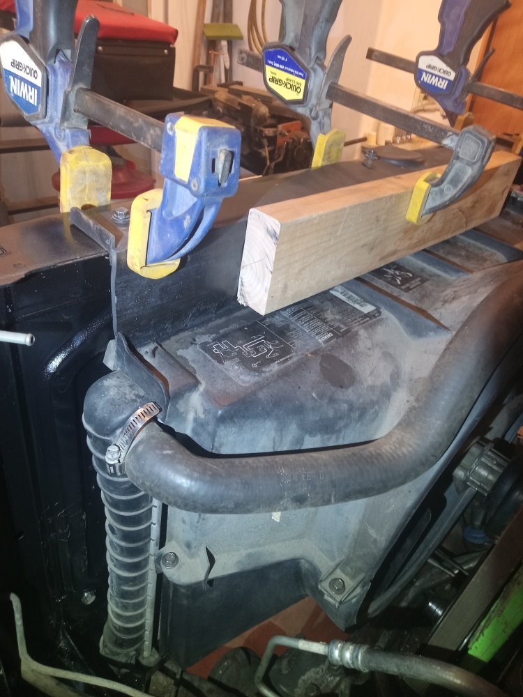

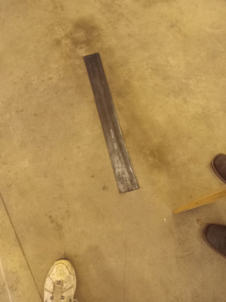

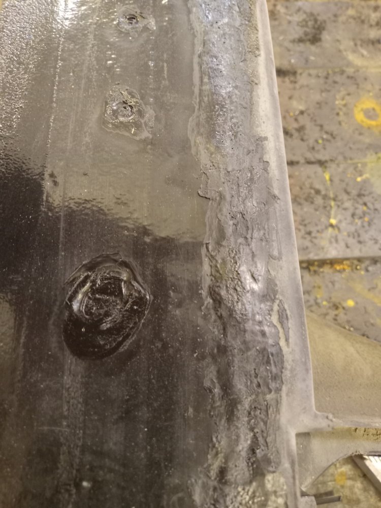

So I couldn't find a scrap of 4" abs long enough, without buying something, so we used a piece of 2". Cut it so it was a little big, good thing because it shrunk about 1/4" both directions. Heated it with my weed burner flipping it over periodically. Then we laid some cutting edge steel on top of it until it cooled. Then we trimmed it up and installed the fan shroud so we could fit it better. Then we put some of the reinforcing wire in.
20231212_200914.jpg20231212_201000.jpg20231212_210548.jpg20231212_210556.jpg20231212_210611.jpgTomorrow I'm going to get some abs glue and see if it is compatible with the fan shroud material.
Get some that works on multiple types of plastic. Iirc, the fan shroud is imjection molded, fiber-reinforced polyethylene. It certainly isn't ABS.
The plastics epoxy I bought worked pretty good. It might have been jb weld. I think I got it at Menards

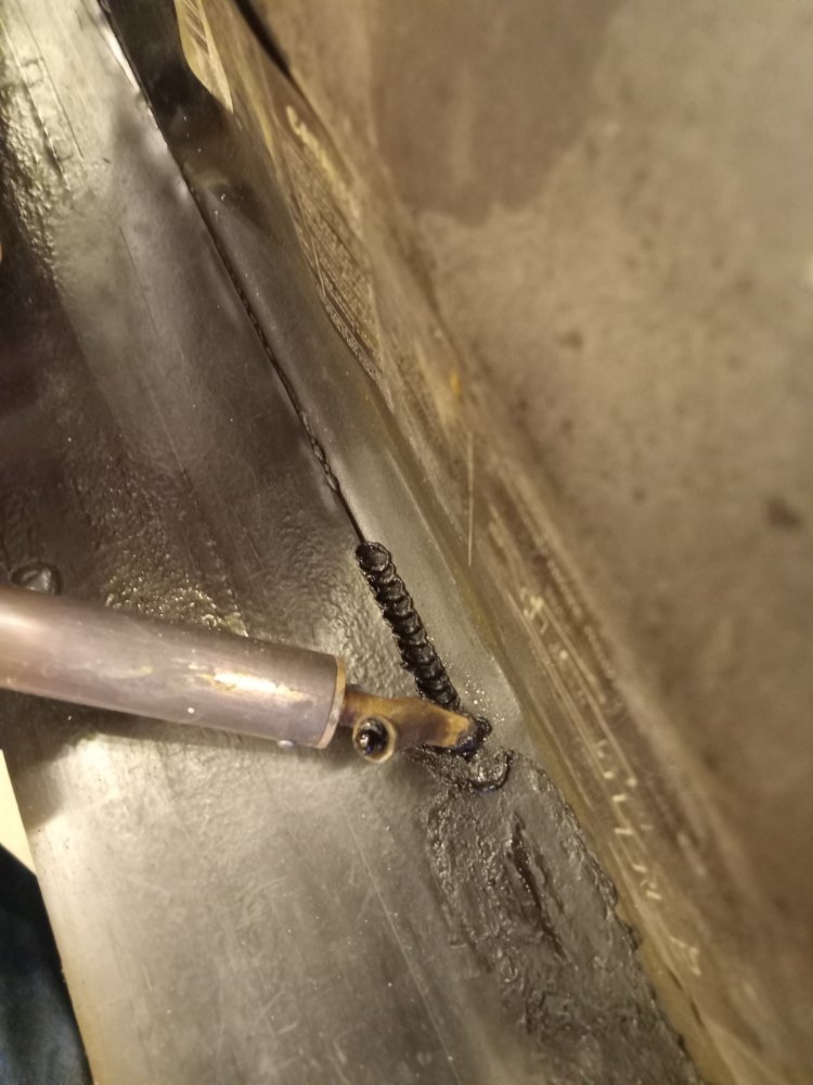

So I tried my hot air welder but no Bueno. Materials melt at different Temps, so I got out my trusty welder that I always use. It allowed me to control the heat and be able to blend the different materials together. Also using some black zip ties for filler where I need it.

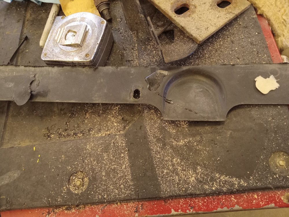

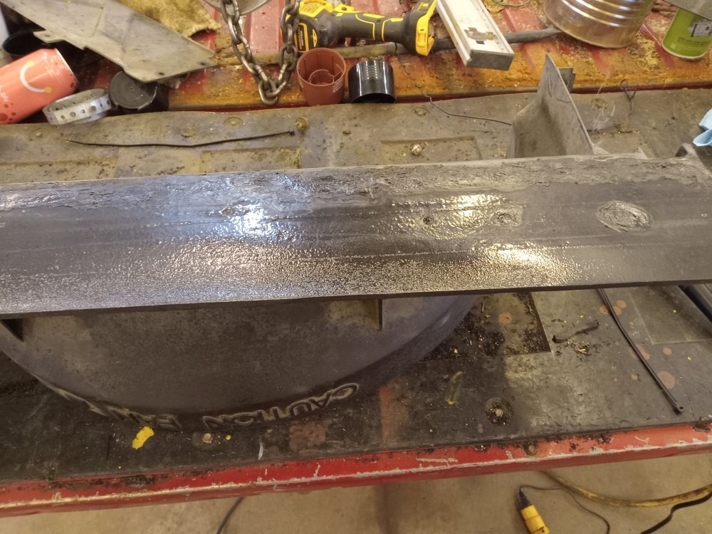

So I tried 3 different glues as well, from left to right abs glue, jb plastic weld, jb plastic bond. The abs glue peeled off pretty easily, the weld isn't fully hardened yet so was sticking fairly good but I think when it does harden it will peel off too, and the bond was about the same as the abs glue.
Lots of luck trying to bond anything to polyethylene. Google and you'll see why. It is essentially solvent-proof, which is why it's used for things like gas cans, commercial dish machine soap, farm chemical containers for weed killers, etc. There is a special solvent used to bond polyethylene to polyethylene, and it is damn expensive, like $35 for a ½ oz tube.
Lots of luck on the welding of two dissimilar plastics together. Hopefully it doesn't fail between the two types or between the filler and either one. Guess you'll find out on the first few jolting bumps or -30° day/night.
Once it's all welded up, I'm curious if a good scuffing and covering the entire area with fiberglass would help reinforce it all. maybe even drilling though holes in the plastic and in the fan shroud for the fiberglass to bond through on both sides like a sammich in various spots encasing everything.
