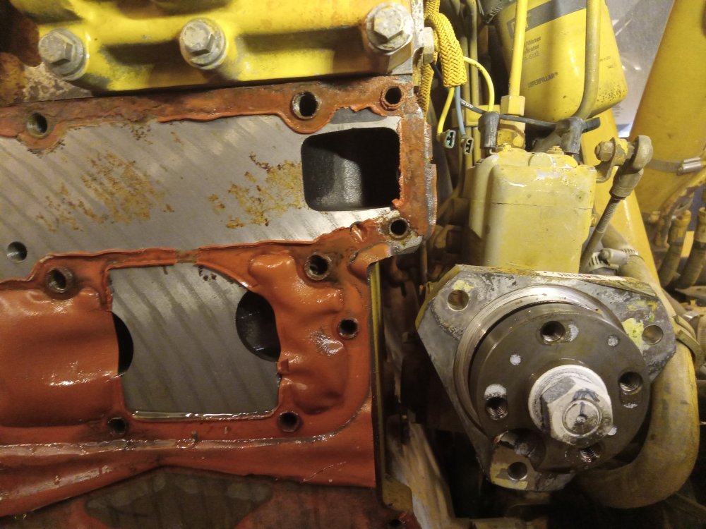

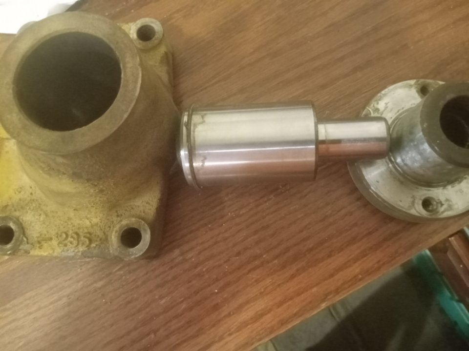

So the cover that bolts to the engine is in a large part held tight by the fan drive assembly. My fan drive bearing had just a touch of roughness in it. So I checked with Cat and I can buy the housing and I can buy the hub that presses onto the bearing but not the bearing. It appears that it was never available from them, wth?? So the bearing is made by koyo so I called them and talked to a field engineer. He came up with the part numbers and I ordered one. $76 including shipping from France vs $379 from Cat. Sheesh
Even look and see if Timkin will cross over that bearing. if not, get the dimensions and see what a local bearing shop can do.
the design of that bearing would make me wonder if you could find a couple of bearings having the same OD and ID of that shaft, machining a shaft along with making the housing able to take grease for maintenance. something that would outlast the engine or equipment it's in.
Used to be able to buy water pump bearings through the parts stores.
Getting a waterpump bearing to fit this application might be a monster for another story. 🤷‍♂️😹😹😹
