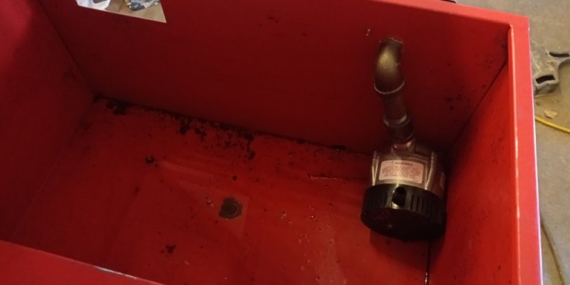

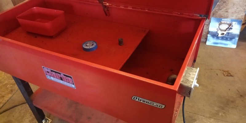

Also working on getting this parts washer going. Put it on casters and bought a new pump, which I have installed, ordered a filter and a flow through brush. Thinking of installing a small pipe with tiny holes drilled in it for air to bubble out at the bottom of the tank.

Idk if the air pumping in would help that much with agitation. You’d need a lot of air to do that and that means running a compressor for it. I would say try it since it’s easy and if it doesn’t work, your only out an hours effort.
A vibration/ rotating brush system in there might do better but requires more effort building.
The parts washer was free so it will only cost me what I have into it. I don't use one very often hence the casters so I can put it outside when I'm not using it. I am planning on a 3 way ball valve so I can have both the flexible nozzle and the brush. I've been around the air bubbler system before and it works pretty good and doesn't use much air. My big air compressor would probably last all night so I wouldn't leave it on.
Free is good! Haha
The air ones I have used never seemed to help a lot, but maybe they were made poorly. If you know how to set it up a good way, please post it.
