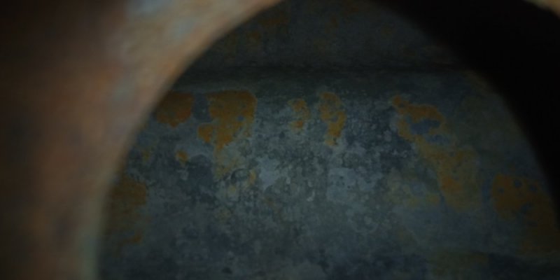

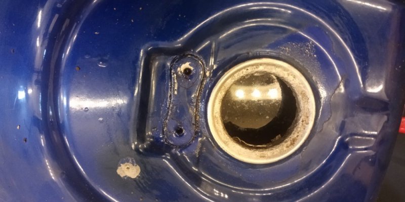

Definitely making some progress. The filler hole hasn't had vinegar on it much. Three or four times I dipped my finger in and rub it around, and periodically when I would check it it was trying to overflow because of gas building up in the tank. I took a small wire brush to the lip and it cleaned up pretty good. I'm thinking of tumbling it too and trying to decide what to use. Definitely want it to be magnetic so I can get everything out.IMG_20200716_120516.jpg
So I drained the vinegar out and rinsed it out. Then I put a gallon of hot water with baking soda in it to neutralize it. Then I rinsed it out with acetone and dried it. Looked so much better inside.IMG_20200717_140510.jpg

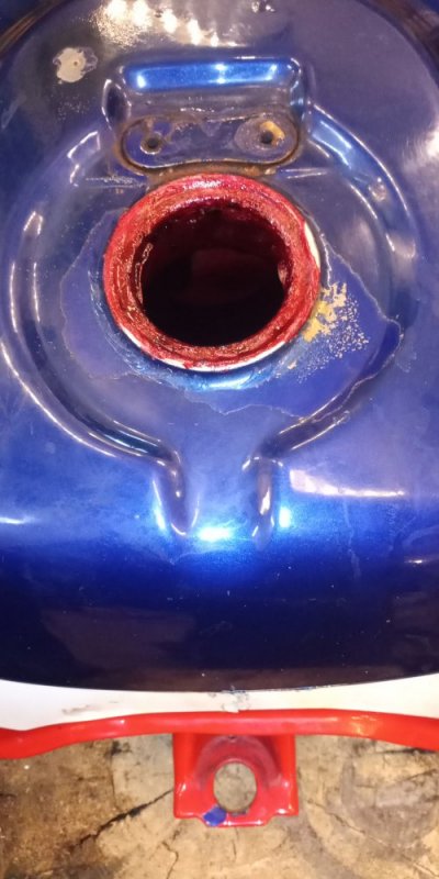

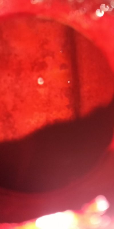

Then I put the redkote in and swirled it around. The worst part of all of it was having to siphon the last cup or so out each time I changed fluids. Kinda interesting I used a piece of clear tubing to siphon with, I discovered I could jiggle the hose and get it to suck out the rusty bits too. I could see them going through the hose so I knew when I had most of it out.IMG_20200717_150609.jpgIMG_20200717_150622.jpg
It actually had 2 leaks, both were in the pinch weld at the low spot of the tank on both sides. Couldn't find any actual holes, seemed to be leaking between the layers. I expected alot worse. But yes the redkote is supposed to fill pinholes
Probably will take a week or more to dry, got a hair dryer blowing into it now. Even with it set on cool the tank is slightly warm to the touch. Part of the reason it will take so long is it was hard to get the excess out.

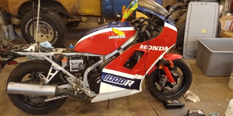

Started putting it back together. I'm missing a bolt that holds the rectifier and radiator overflow tank on, it's on order. On of the few parts I can still get. The seat is stained/dirty if anyone has any suggestions for cleaning it I'm all ears.IMG_20200718_120613.jpg
Started putting it back together. I'm missing a bolt that holds the rectifier and radiator overflow tank on, it's on order. On of the few parts I can still get. The seat is stained/dirty if anyone has any suggestions for cleaning it I'm all ears.View attachment 61422
Might try a little rub of some brake and parts cleaner, in an out of sight area. Be sure it dont make the vinyl gooey and color transfer from rag to make it worser.
Usually removes most stains.
Another solution is some baking soda and water it to a paste. Use a softer scrub brush and scrub it around. I know it sure worked good for removing rust stains from fabric.
