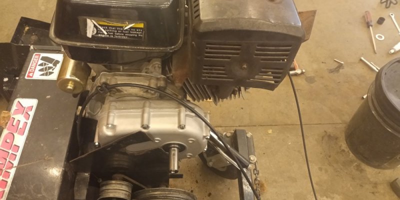

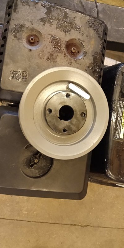

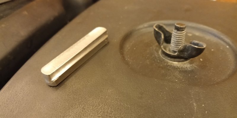

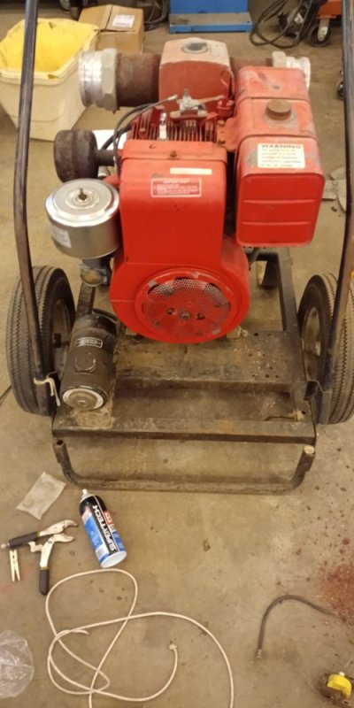

Picked up this 4" pump around Christmas time. Paid $250 for it the guy I got it from had lost the keyway for the flywheel and had also pulled apart the carb and broken the main jet, you have to pull the jet first before you can disassemble the carb. So it didn't have any spark and the carb needed a rebuild at best. Upgraded to the newer coil so it doesn't need the points anymore. A new import carb was cheaper than a rebuild kit, so I bought a new carb. Runs good. Total investment is right around $300 including what I paid for it.IMG_20200211_163533.jpg

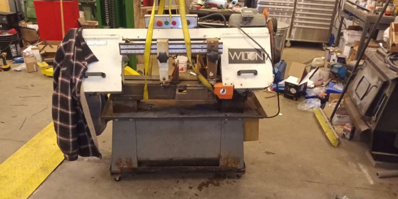

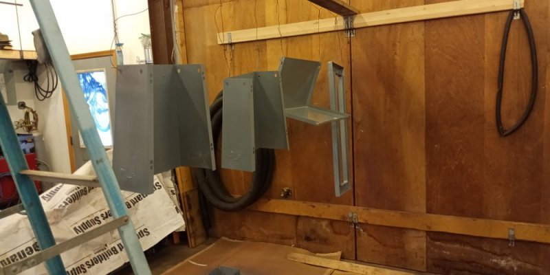

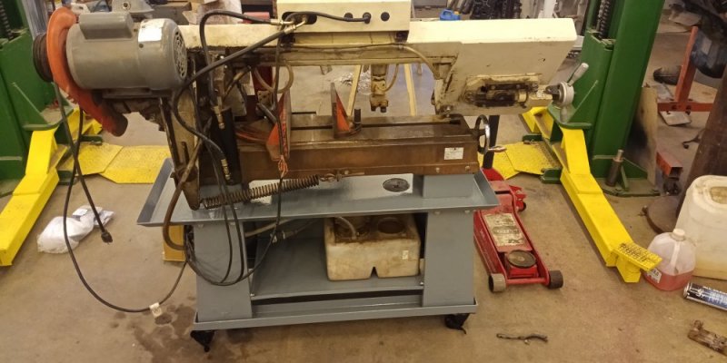

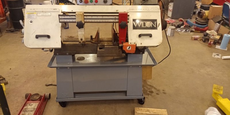

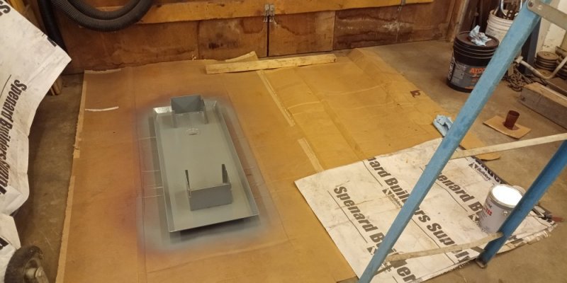

Also I decided to put new casters on my bandsaw as the first time I tried to move it one fell apart. Wasn't very happy with how the caster frame was built as it left the ends open where they had just ran one channel past the other in the corners which left it kinda weak. So I filled in the corners and then decided since I had it that far apart I'd go ahead and take the rest of the base apart and fix some holes someone had put in it. Everywhere coolant touched was fairly rusty so I had it sandblasted and I'm in the middle of painting it now.IMG_20200211_163546.jpgIMG_20200211_163558.jpg
So I woke up in the middle of the night thinking about my base for the bandsaw. By welding the piece in the ends I effectively narrowed the base. It worked like it was because the sheet metal corners of the stand could go all the way out to the ends and the rest of it could flex enough to fit on the sides. So after my paint dries I guess I'll be cutting it in half and welding it back together about a 1/2" wider. Kinda sucks because I thought I was about done. Probably would have taken quite a bit less time to just make a new one. Bummer
