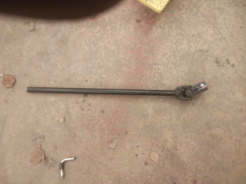

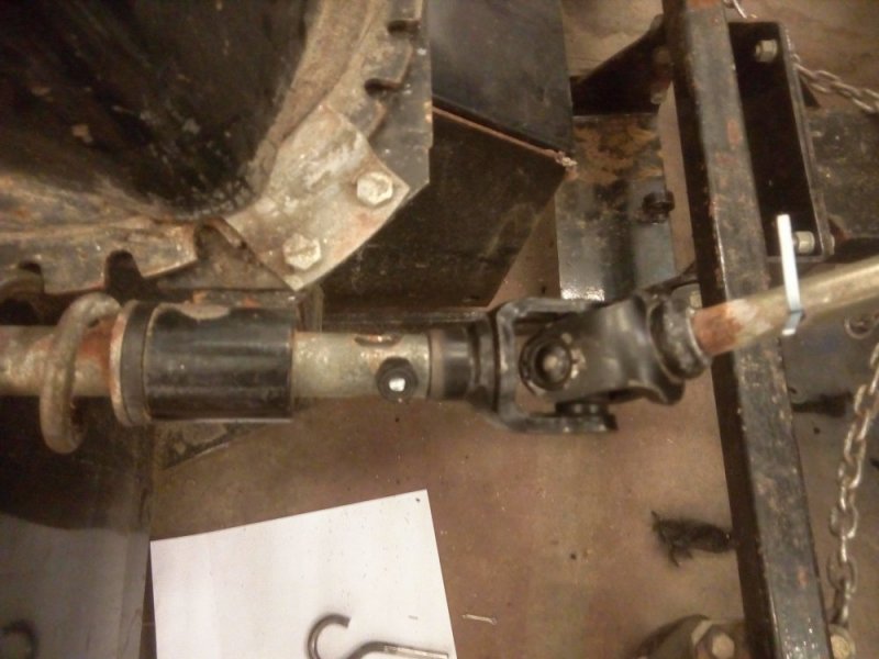

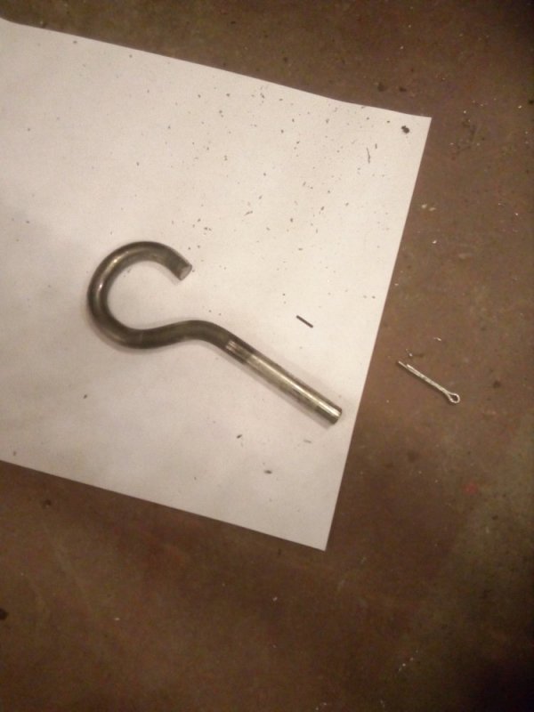

So since I was missing the sheperds crook on my chute control I decided to try and make one. I thought it turned out pretty good. Problem is it didn't work for beans. I had wondered why the crank handle was kinda bent in several places and I think the OEM setup didn't work very good. So I got thinking about steering shaft u joints. Talked to my nephew,who works at a Polaris shop, to see if he knew where I could find one cheap. Just so happens that he had several new take off he'd kept from some sorta warranty upgrade or something. Anyway I cut one of the 2 joints off and turned down the ends to fit. Works pretty good now. Now the only thing is handle is not stiff enough. But oh so much better.IMG_20181029_214953.jpgIMG_20181029_215007.jpgIMG_20181029_215019.jpg

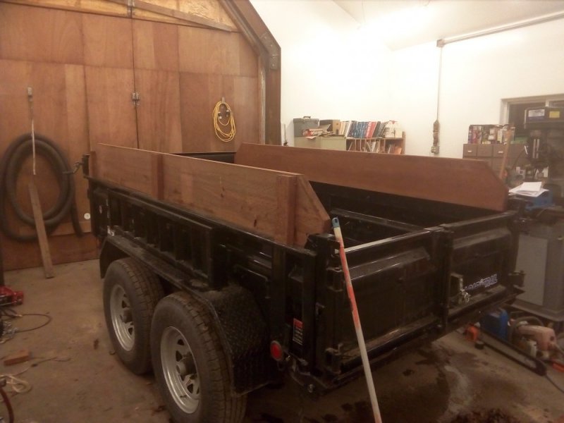

Put some side boards on my dump trailer. All in preparation for an upcoming coal run, and it'll be helpful for going to the dump too.View attachment 54478

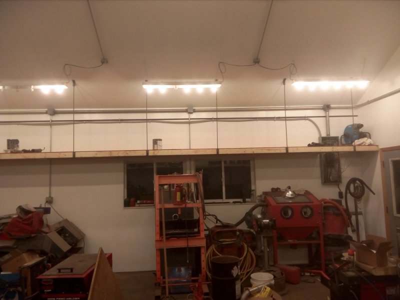

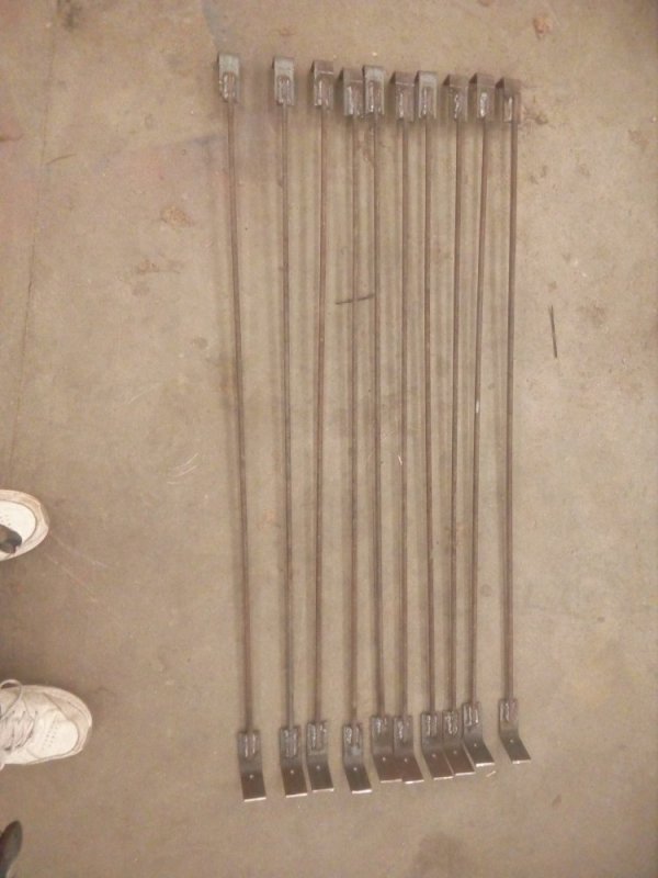

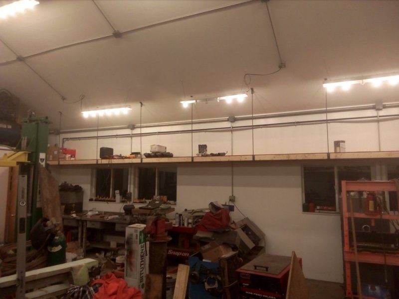

Getting to tired of not having much space in the shop, always in the plans was to have a shelf along the outside wall. So I made up these brackets, also found out I had a kink in the liner on my mig. So I borrowed my brothers portable Lincoln mig to finish them up. Turned out pretty good I think. Might do the other side too we'll see how my time goes.IMG_20181110_194608.jpgIMG_20181110_215324.jpg
Looks good. It's starting to look like you have some stuff in there. One day I am going to add some "hanging storage shelves" in 2 or 3 places. Some of those crank down units look interesting but a ladder is faster. I have several totes on upper shelves of stuff I don't use often. I would like to change them to clear and start labeling where stuff is. I forget where stuff has been put away and get agitated searching for things when I can't find something. Those upper shelves add time when looking for stuff.
Looking again is it sorta like a mezzanine? Is that the plan for the next expansion?
I can climb and stand on my shelving I might have to make a hanging catwalk now that I think about it.
I use some of that wire shelving as a shelf across some rafters and its nice to see through it and see what I put away.

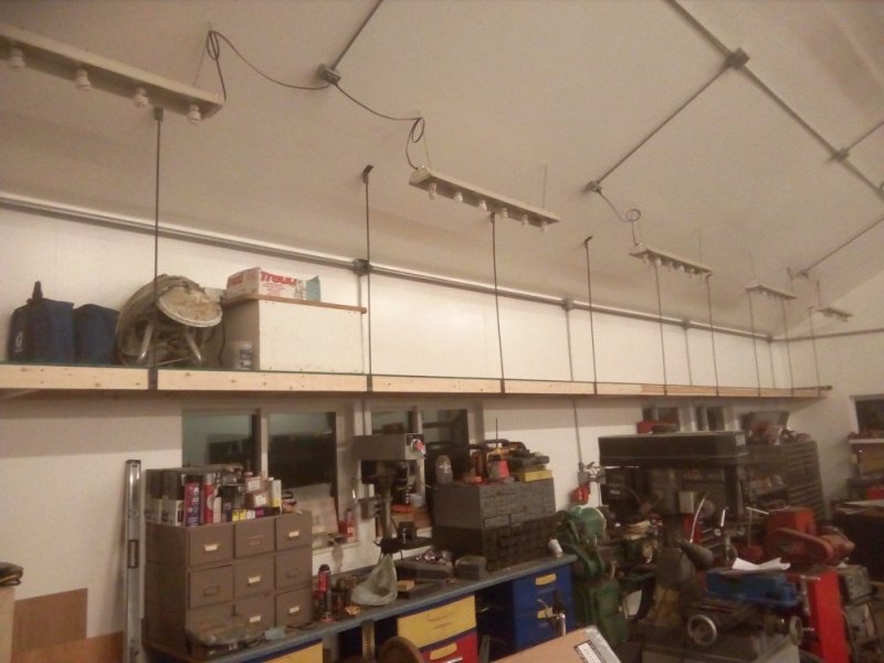

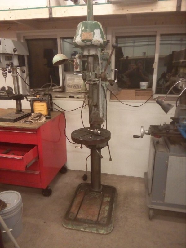

So I got the other shelf done. Also wired in my compressor permanently, stupid flex cost more than the wire. Also now that I'll have a little more room I brought in an OLD 3phase drill press I picked up about 10 years ago. Spent most of the afternoon freeing things up and cleaning and adjusting the moving parts and column. Eventually I'd like to strip it down in paint it but it's usable as is.IMG_20181124_180213.jpgIMG_20181124_180218.jpgIMG_20181124_180232.jpg
Are you going to out the 3 phase motor for a 240v one or use a frequency drive?
Also you could make a 3 phase drive unit if you have another 3 phase motor and a stronger 240v unit to drive the 3phase with a belt and use the 3 phase as a generator. That sucks up the most electricity, but if you have the extra one laying around can be cheaper since you wont use it all the time.
