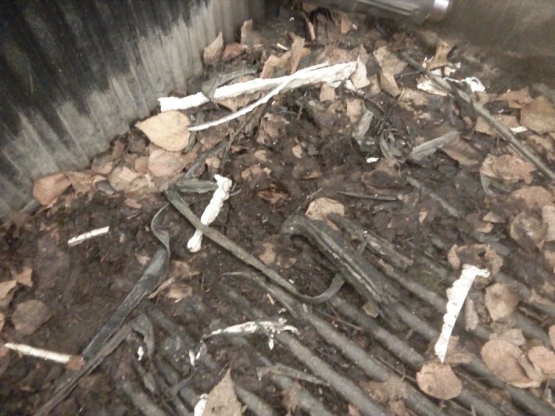

It should be readily apparent if the junk is plugging up your screens. A good solvent clean will help. Even if these check out, the fluid (even if it's only about half) and filter change will help. Maybe the main pan filter has some gunk in it as well. Preventative maintenance kinda. A few bolts to drop the pan.

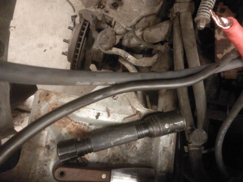

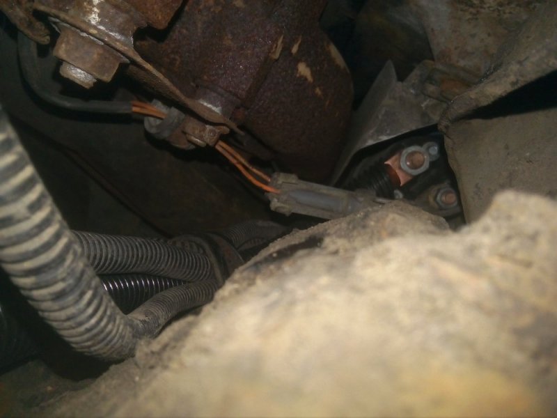

Time to give the truck some love. Tranny is still hanging in there. Putting all new battery cables on bigger than stock. Moved the passenger side ground cable to a bolt on the front of the head. Also moved the drivers side ground cable off the alternator bracket bolt and to an unused intake bolt.IMG_20181204_190623.jpgIMG_20181204_190702.jpg

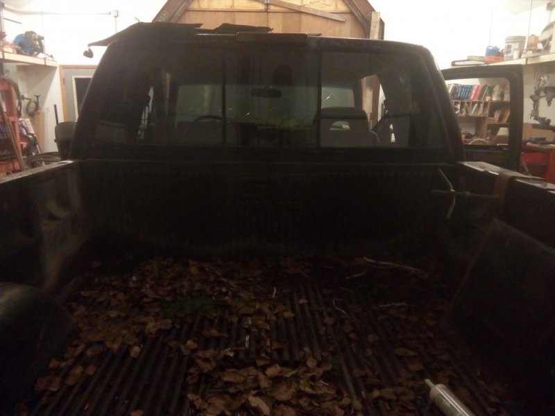

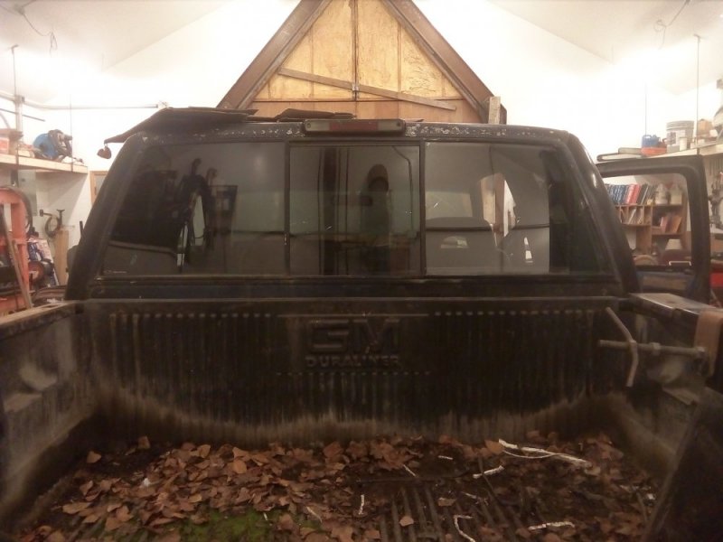

So I'm my list of fixes was to replace the glass in the power sliding rear window. Made a pattern out of a piece of 1/8 plywood, same thickness as the glass, reused the old channel strip. I used a little silicone as well. Biggest challenge was cleaning off the old caulk, must have been a whole tubes worth on there. Had to convince the glass shop that it wasn't going into a vehicle cause safety glass would have cost more than a new power slider. Like $600. Need to get some window tinting film now so it will match the rest of it. I think it'll help hold it together a little if it does get broke. Any of you tinting guys can chime in with what % of tint I might need.IMG_20181212_113744.jpgIMG_20181212_113804.jpgIMG_20181212_113814.jpg

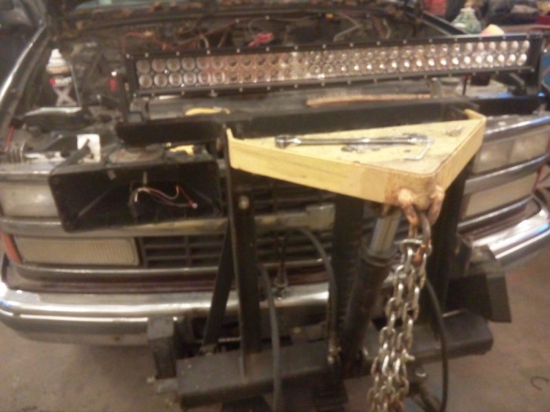

Finished up mounting the lights still need to do the wiringIMG_20181212_151043.jpg

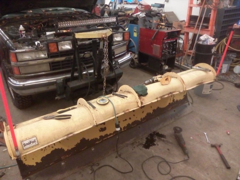

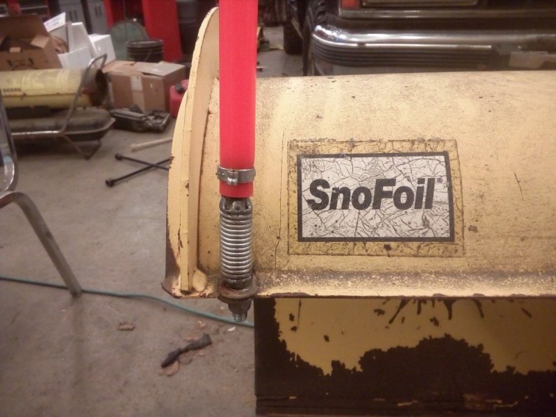

Bought the pex markers off eBay but this plow is heavy enough it doesn't ride up as easy as others so when I'm pushing snow it bent the markers back, one broke the pex the other loosened the clamps and it fell off.
Check with your state laws as far as tinting, most states let you have the back windows blacked out with no specific percentage, then the side windows and windshield have to meet a certain percentage of course.

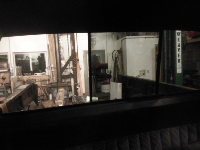

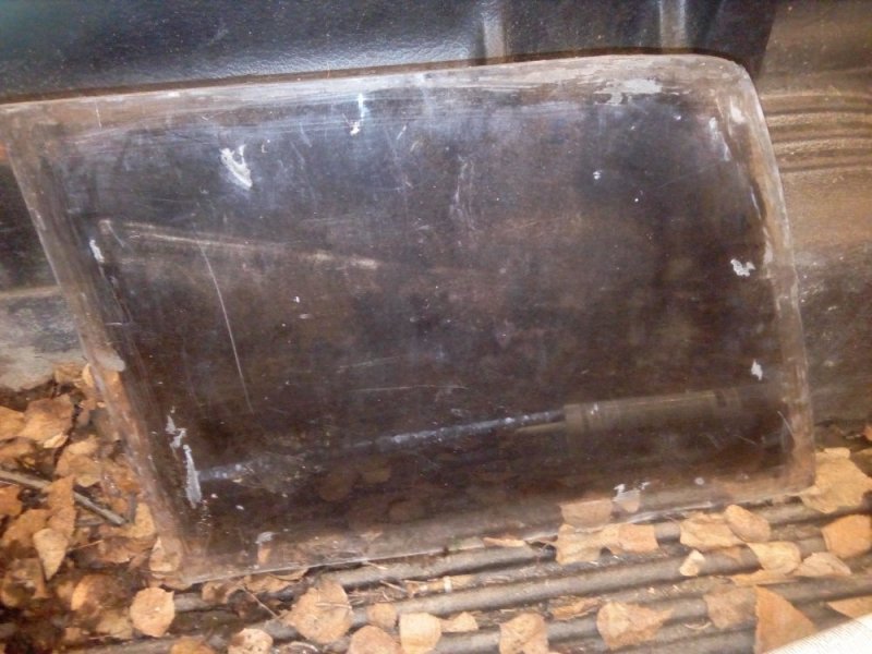

the old piece is plexiglass that someone had rattlecanned a mist on trying to simulate the tint. pretty poor repair

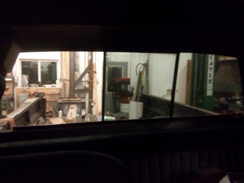

would it help if I took a picture from the inside out?
Yeah it might. And one from outside in without as much glare if that’s possible.
The spray painted plexiglass is close to 30% or 35% by the way the tube of caulk looks behind it.
It’s not to bad of a job tinting windows. During the summer time I’ll use a mix of baby oil and water for the tint to stick to the window but if it’s colder outside like in the 50 or 60s I’ll just use windex for the tint. You can work with baby oil a little better but takes about a week to fully dry. The windex only takes a few days.

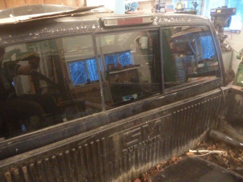

So the first 2 pics are with all the lights on the second 2 are with the lights out at that end of the shop. If anything the pics make the tint look darker but not alotIMG_20181214_083640.jpgIMG_20181214_083707.jpgIMG_20181214_083813.jpgIMG_20181214_083752.jpg

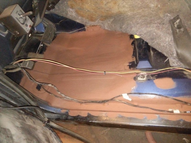

Also ordered a vinyl floor for it from rock auto. Discovered that under the carpet on the drivers side was getting pretty rusty from the carpet being damp all the time. IMG_20181214_084702.jpg
Wire wheeled the rust off in then a heavy coat of Rust-Oleum rusty metal primer

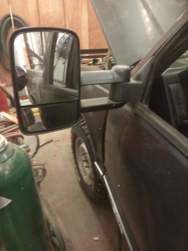

Putting on tow mirrors too. Power and heated. Got some control switches from a suburban a few years ago from Leroy, but discovered that the window switch plugs are different from the trucks. So I'm getting a complete drivers side door harness with the power mirrors and the across the dash wiring and the pigtail for the passenger side window switch along with a rear defog switch from Barry. Which I have to say was a good price.IMG_20181214_085043.jpg
