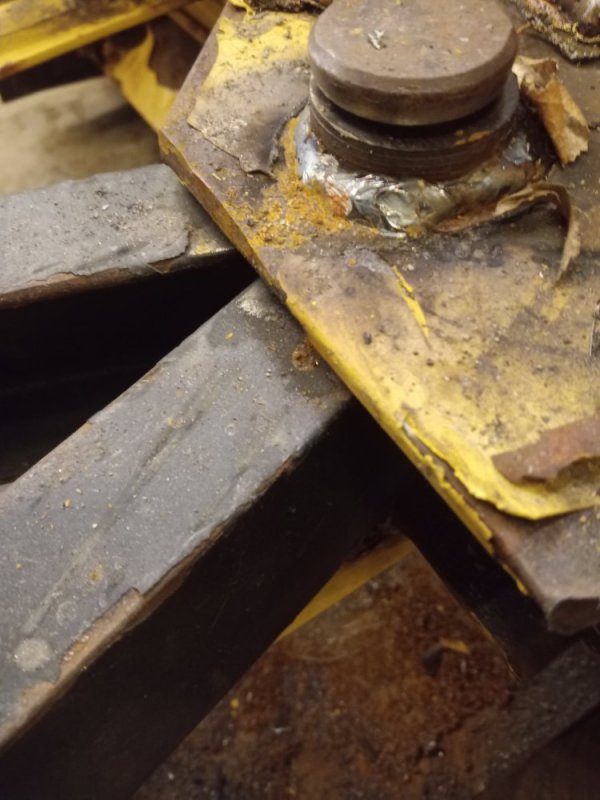

So I thought it was time to give the plow truck a little love. The plow was getting kinda loose and when I pulled it apart I discovered the center pivot pin area was pretty shot. The pin evidently is hardened so it didn't have much wear but the hole it went through was pretty loose. What was odd to me was the hole was only worn on the top side. Even the solid 3" piece at the end of the A frame was really sloppy at the top and fine at the bottom. I also discovered that the steel at the top that is welded to the plow was bent and half broke loose.
So I made a 1/4" thick washer and welded that on top of the oblong hole. Then bent things back and rewelded it.IMG_20220127_131307_078.jpg

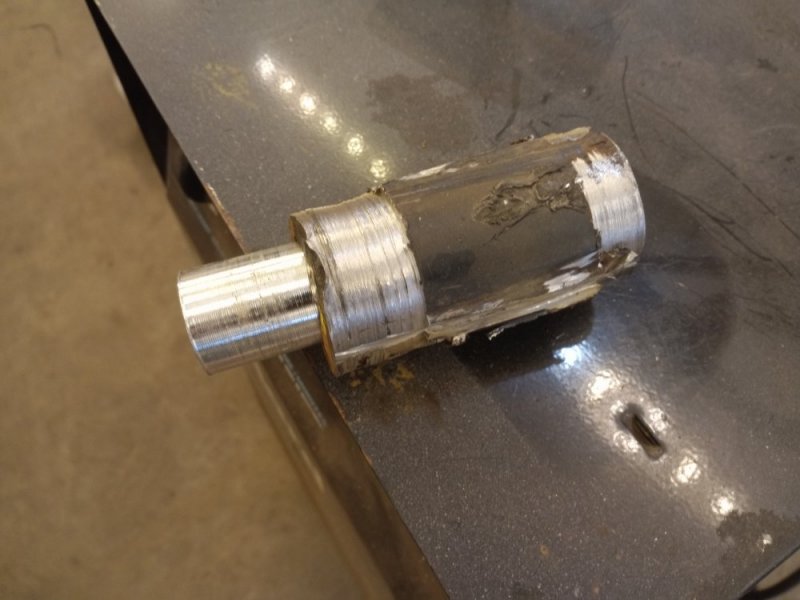

Then I built a 1" center for my 1 3/4" holesaw and cut out the solid piece at the end of the A frame out. Made a new one on the lathe and welded it inIMG_20220127_131329_579.jpg

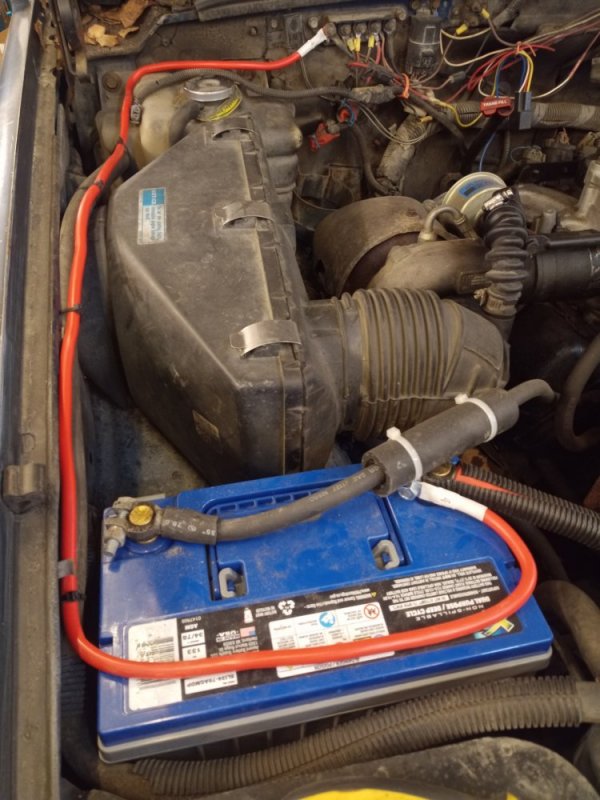

I never have been satisfied with the voltage gauge reading and my buddy with a 93 said he put a 4 gauge wire from his battery directly to the buss bar on the firewall and said it made a big difference, so I'm trying that out as well.IMG_20220127_131257_428.jpg
Yeah, that Positive wire on my 94 really had me scratching my head when I had to do the "emergency" starter cable transplant to my 98 when the starter lug snapped in half while installing the new starter to replace the dead one on my 98 right before the January snowstorm hit a few years back. It was like a 10 gauge wire that ran down the loom to the starter with the starter cable, then exited the loom, ran over to the firewall, then up to the Buss Bar. What a screwy routing! Especially for that long of a run/light gauge of wire! Like your solution, something that could/should have been done from the factory!

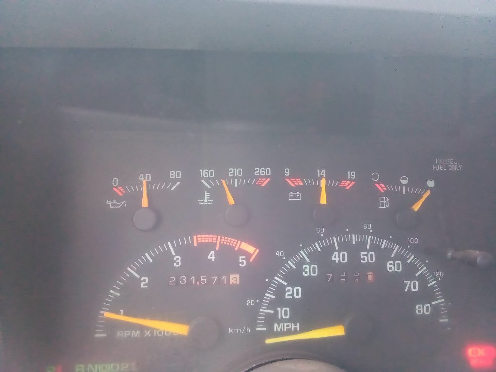

How is the gauge now that you have had a little time with the 4 gauge wire? I always had this issue in my old plow truck, thing swung all over. Funny part was the plow was completely hydraulic so shouldn't have had much of an impact as it was old school Fisher belt driven. Truck always started so it had to be charging decent.
So looking for some suggestions here. I put on a new powermaster starter and ever since I did it charges really well when cold. But as everything warms up the voltage drops lower and lower and you can see it in the lights. Called powermaster and they weren't very helpful and basically said send it back and they would fix it (out of warranty). To me it acts like the regulator isn't working right, the tech said it's either on or off and can't do low output. Thoughts?

So lately the circuit breaker I put on was tripping alot, so I eliminated it. That seems to have been the charging in issue. Ran it for about 45 minutes everything good and warm and the voltage stayed right up where it should be. I'll know for sure next time I plow.
