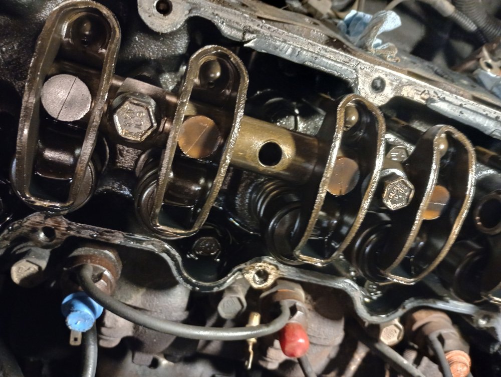

Curious while you have yours open, how do you measure wear on the rockers or the shaft. pushrods too. I figure measuring the shaft between where the rockers ride and don't ride, but on the valve end and pushrod ends how is wear measured and when they would be deemed too far gone and still good?
I used to mainly do a visual on such as that.
Look at pushrod ends, are they beginning to appear sort of going to a point shape ? ? ? ?
Rocker shafts on the bottom/pressure side, how much wear and is there any galling going on ? ? ? ?

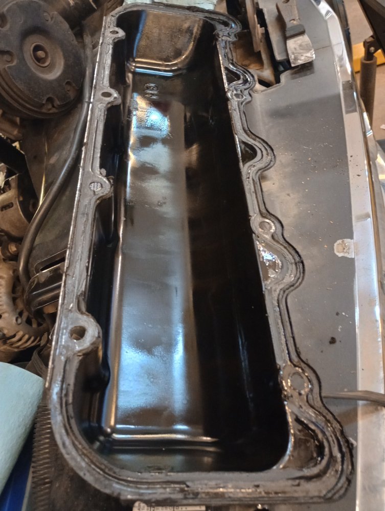

Definitely on the downhill side of this project. Both valve covers are glued back on , intake is back on, turbo is back on. Still to do is to make some bracket extensions for the wiring bracket that goes to the intake. Then the FFM and tubing, fan clutch and fan, and coolant crossover. Then underneath I have some orings for the oil filter adapter.
