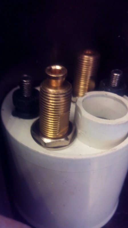

Interesting, Might want to build a "sleeve" to space the gauge out some? I don't know of anything more compact.

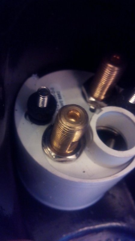

Can't tell for certain from the picture, but the gauge ports have an inner chamfer that's designed to compress a single cone ferrule with a (direct fit) cap like you're making.
In person, does it look like it's shaped that way to accept/mate & compress a ferrule?
At least brass is soft & easier to work with.
Here's as good a pic as I can get. Second one has the ferrule sitting in the hole

I bet that will seal just fine with the cap you're making. If you decide the ferrule should be further into the taper, I wonder if one of the common step drills might provide the taper you want but a little deeper?
I use step drills more & more in fabrication because they leave such nice deburred holes.
Was thinking more like this in the correct size. http://www.irwin.com/tools/browse/drill-bits/hss-countersinks

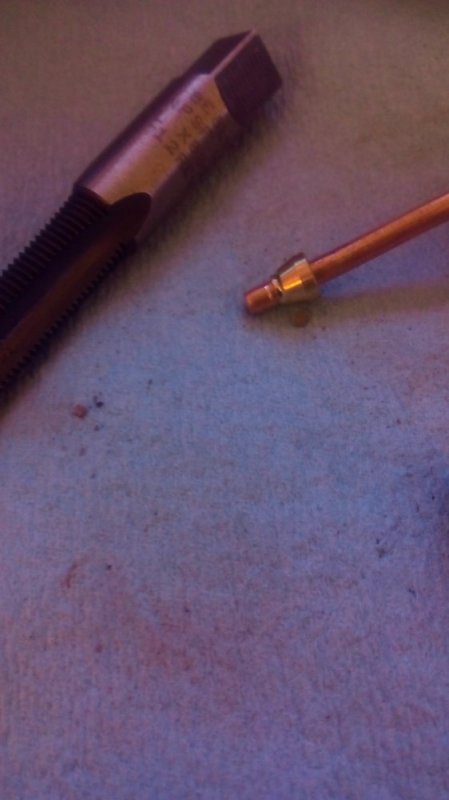

Alright guys I need some ideas here. So I got my bottoming tap and I can thread it all the way to the bottom of the cap by hand but the cap still won't thread on far enough. Evidently the tap is smaller than 1/8" pipe. But when I hold it up to the threaded tube on the gauge it looks smaller than the tube as well. What thread is that any way. Maybe I should get a 3/8-27 die and run it over the tube, not sure if there's room to do that tho.
Can you glue a washer in the bottom of the cap as a spacer so it is not so deep. Or make one as a bushing/spacer.
1/8 tubing with a compression ferrule to fit it (similar to an OP gauge) and the proper nut would be a 3/8-27 straight thread (like a lamp fitting). I probably have a couple in a drawer full of tube fittings if you just can't find anything. Check around online first starting with the gauge manufacturer.
So I finally got my tap. PO put it in the wrong box. Looks like I can make it work I did use my countersink and bevel the hole better too.
