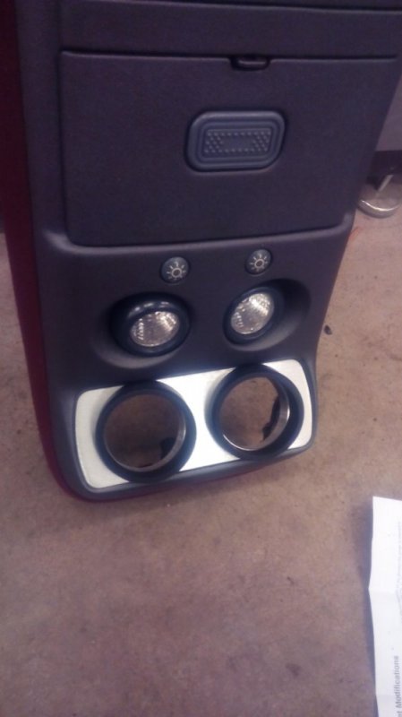

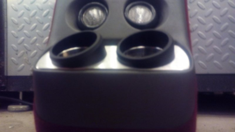

So while I'm waiting I decided to work on my other gauges. I got some angle rings to angle the gauges. Trying to decide if they have too much angle. Opinions?

Won't a tube ferrel crush type fitting work?
Or are you trying to hook the one close to the pillar material. Might could put a spacer and let the guage stick out a bit? OR cut the pillar and maybe patch it with a hump?
