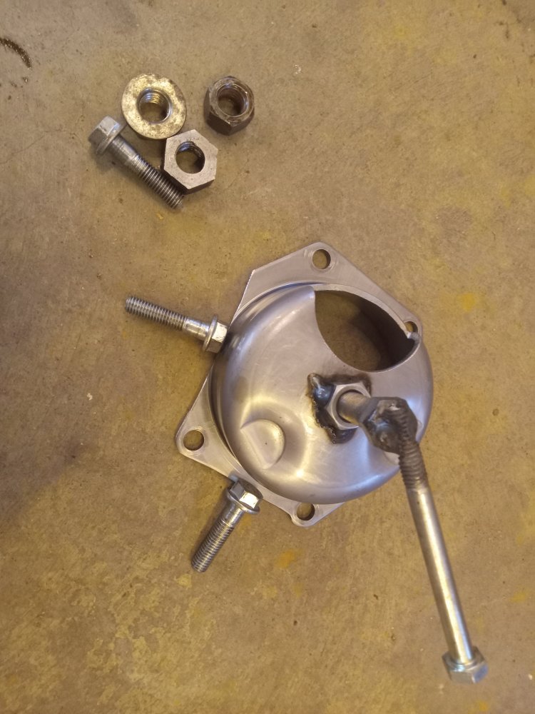

I took my pin out and had a shop add some length to it. Been fine ever since.

Here's the tool I made, the bolts on the side show which 2 sides I modified to clear the valve body to make it easier to install. The idea is to use a 7/16 fine thread nut and bolt which has about .050 per revolution. So you're shooting for 2.5 turns or about .150. The cover holds the piston flush on one side so you turn the bolt in until you make contact then see how far you turn it until you get resistance. More than 2.5 turns means you lengthen the rod, less you shorten it.
